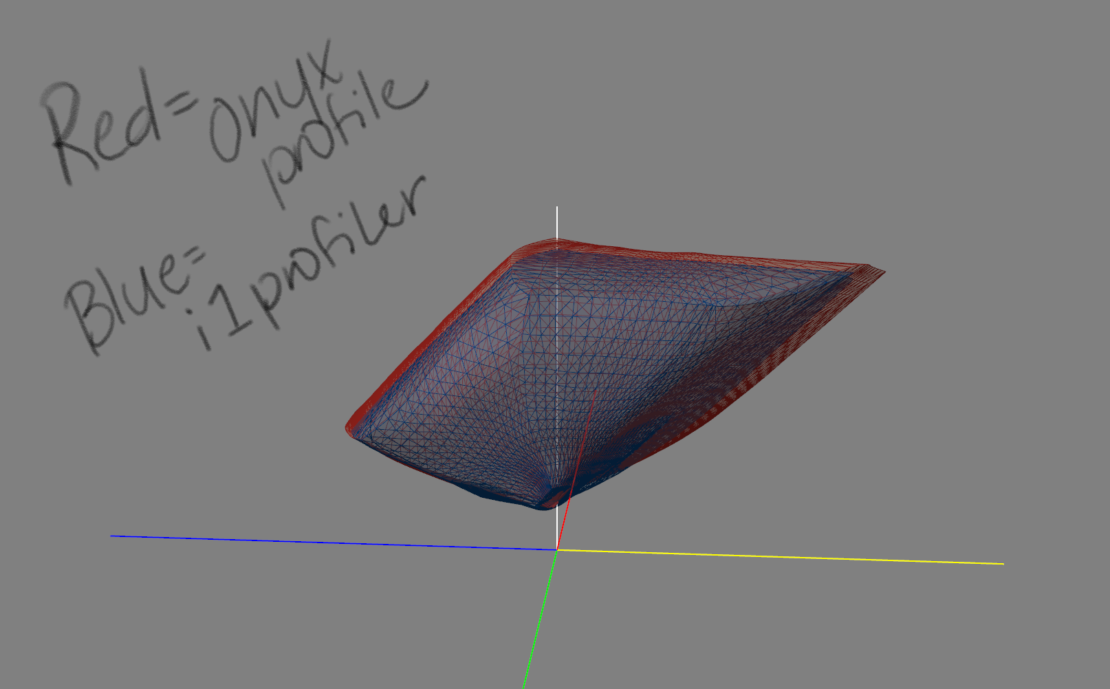

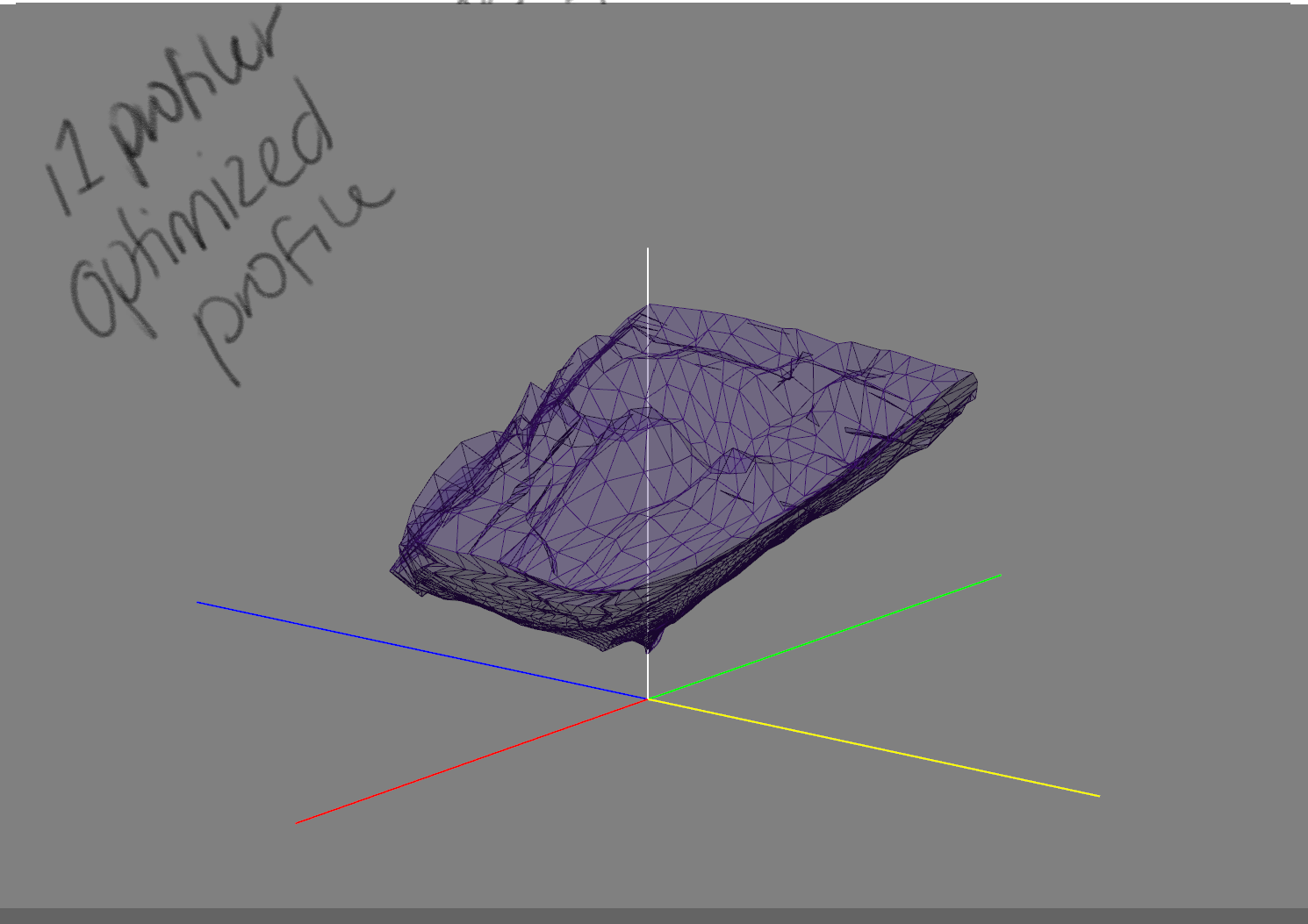

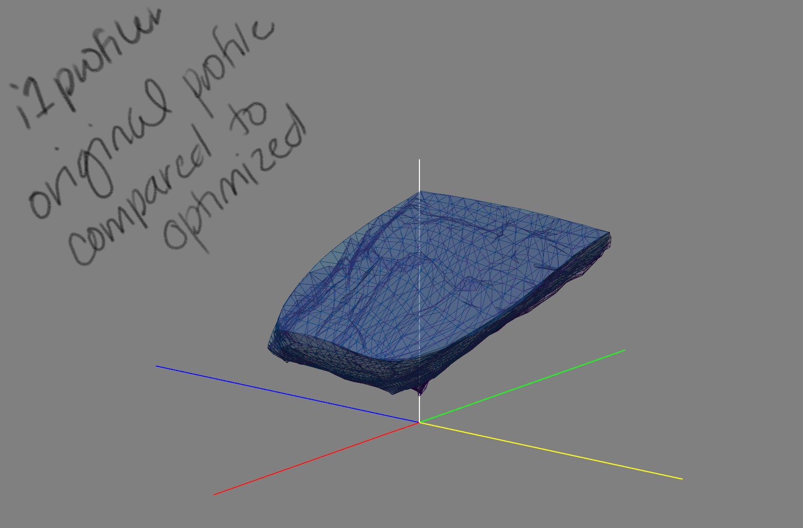

I've been struggling to get a profile that I really like, and I have a couple questions.

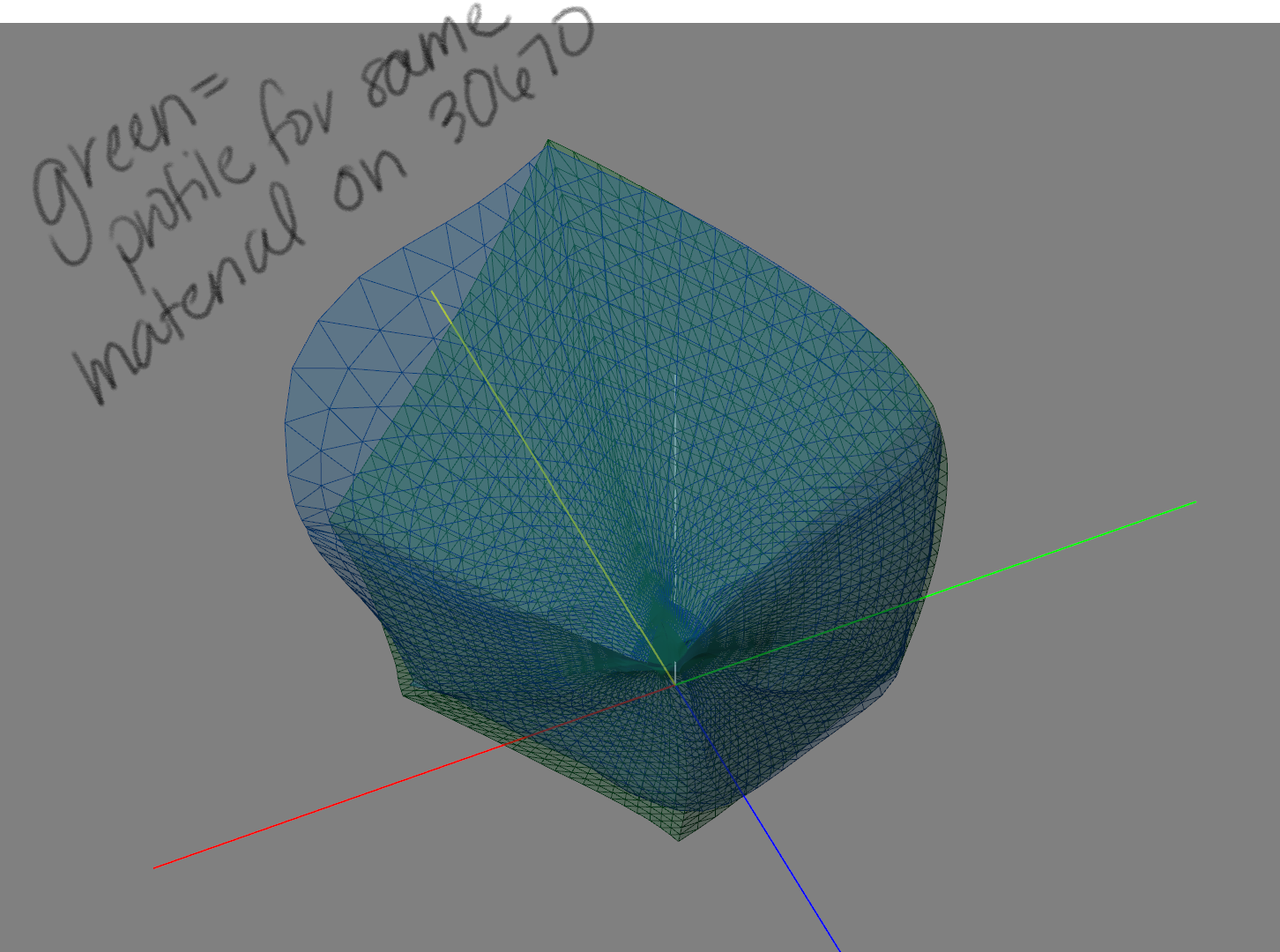

I created a profile in i1 Profiler and the initial profile looks ok, although I feel like the gamut should be bigger than it is. I compared to profiles created for me on my s30670, and the profile from the s30670 was wider in the cyan range, while naturally the 80600 has a better red and yellow range, but when I tried to acutally use the profile I created I wasn't pleased with the color accuracy, everything was very dull and dark amd greys had a magenta cast, not warm or cool, like flat out magenta. I ran the optimization and the gamut visualization got really ugly and bumpy and colors were suddenly way off, so I'm not sure what I did wrong there.
So I went to try out Onyx to create my profile and again, very dull and colors coming out darker than they should. I also noticed the muddy brown tone to the red and orange that I've seen a few people talk about. Also had very cool greys so I rant the g7 calibration and that helped a lot, but everything seems very dark still. I did the accuboost and again, everything got way worse. Not sure what I'm doing wrong procedurally when it comes to reiterizing.
I did not do a linearization as I took some advice and used the 80% overall ink limit suggestion from another member. Would I do better if I ran a linearization? Could that be the root of my dark colors?

Dont use any values you have heard from somewhere, do the complete process as needed for your printer (profiling only with printers in contone mode, or completely with calibration - ink limits and linearisation - in halftone mode).
Have you really set the overall (total?) ink limit to 80%? You have decreased the possible ink limit (400% for a CMYK-Printer) by 80%. Of course your colors looks dull. Accuboost will not help you if restricting the gamut so much before (will only try to precisise the colours, will not expand gamut). Perhaps Chromaboost (in the profile build options) could help you making your pictures looking a little less dull, but the very first option will be to set a reasonable ink limit.

I'll try building a profile in Contone with ink limits set at 100% Logically I feel like if all of my colors are already too dark it could be an overinking problem as opposed to the opposite? Perhaps I need to reduce ink on certain colors but not all?
My specific issue with accuboost, is that there is a color shift and it's not a good one. The most notable shift is that the cyans go green, although I did see some issues with the gradients in yellows, a purple shift in the darker blues and some gradient issues in cyans. I do understand that optimazation and accuboost are not used to expand my gamut but rather makes the colors be more accurately reproduced within the profile.

Do you have any given profile eg from onyx which works better than your current results? If yes, try to reprofile it.
