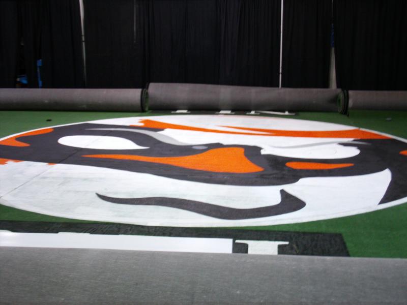

  12. ddarlak
    ddarlak Trump Hater
    i've painted many logo's on turf.
    the best i've found is flat interior latex, paper pattern, brushes and rollers.....
    here is a photo of the last one i painted.the logo isn't finished in this pic, don't have time to find an updated one.
