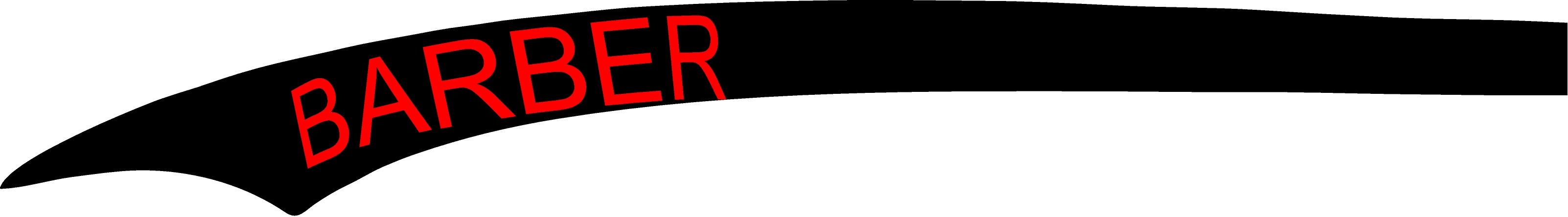

A customer asked me to fit the text into the lower banner of the sign and i completely forgot how to do it. i cant get it to go with the object inside of the shape. i use both flexisign and xara to design my work but if someone can teach me on whatever program they use i would greatly appreciate it.

I don't know if those softwares have an automatic function for it, but usually I use a warp tool to shape a word to fit in a shape.
Boudica
I'd use the perspective warp tool if I were working in photoshop. And now that I'm looking at the example from the OP - a simple warp would work better than fitting the text to a path.

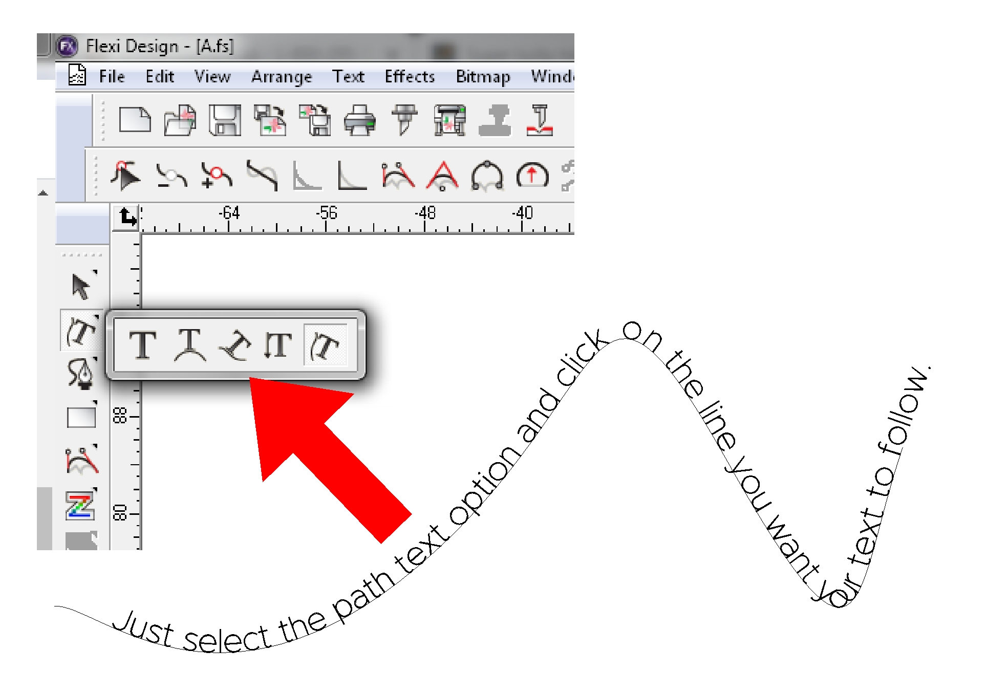

Hello! Do you want the text to fill the space, starting large and narrowing down along with the shape, or do you just want the text to follow the bottom line? For the latter, it's easy to do with Flexi, (see attached JPG). Don't forget to play with the options in the design central. For the former, the warp tool in Photoshop is easy to use and would probably do the trick.
