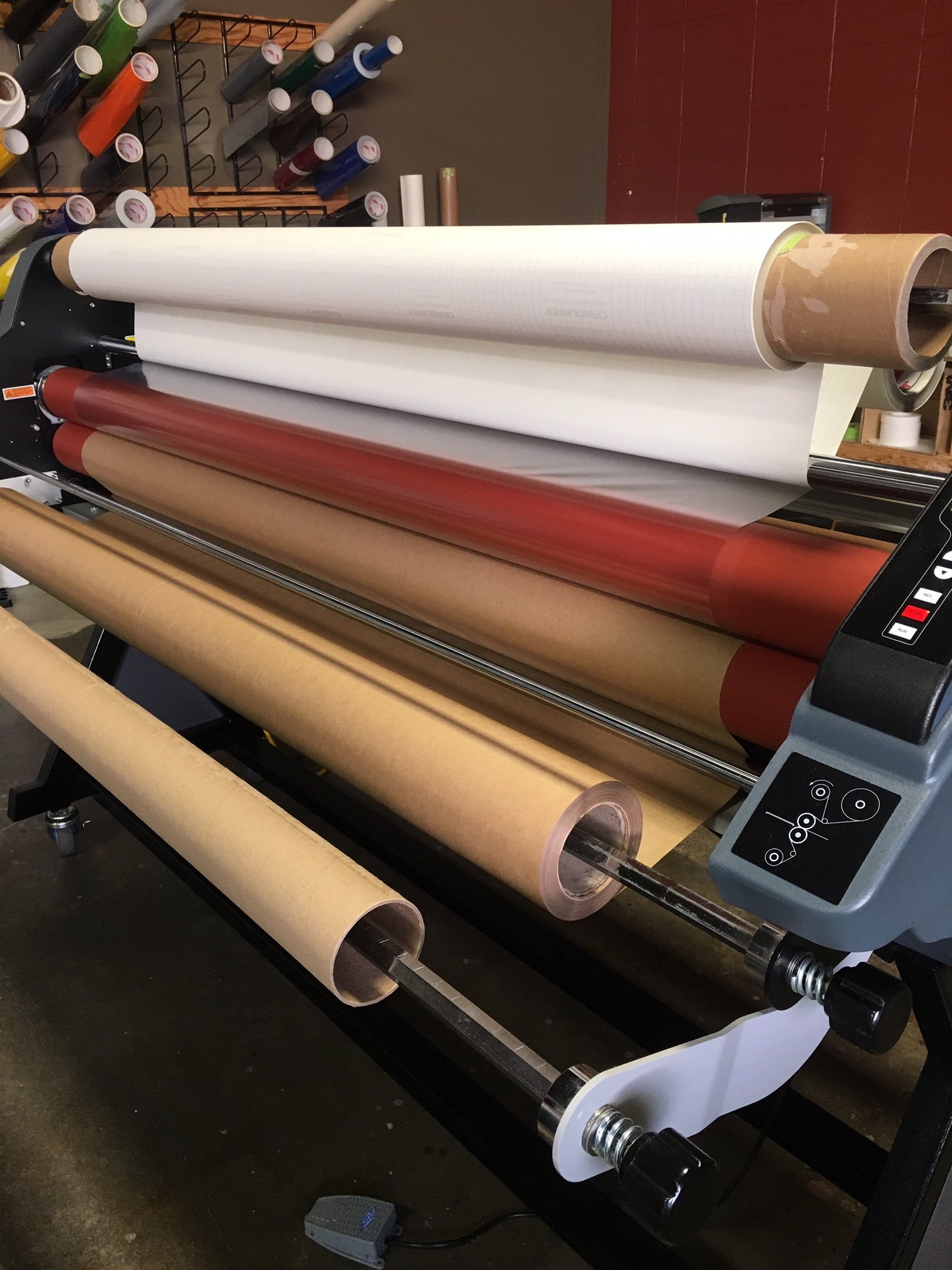

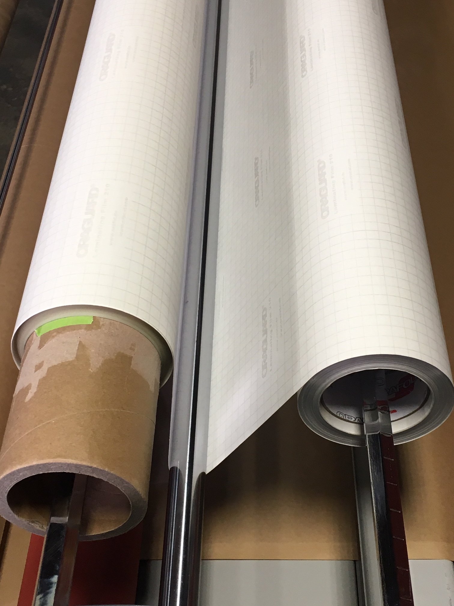

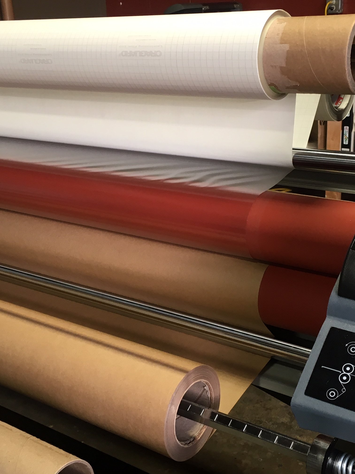

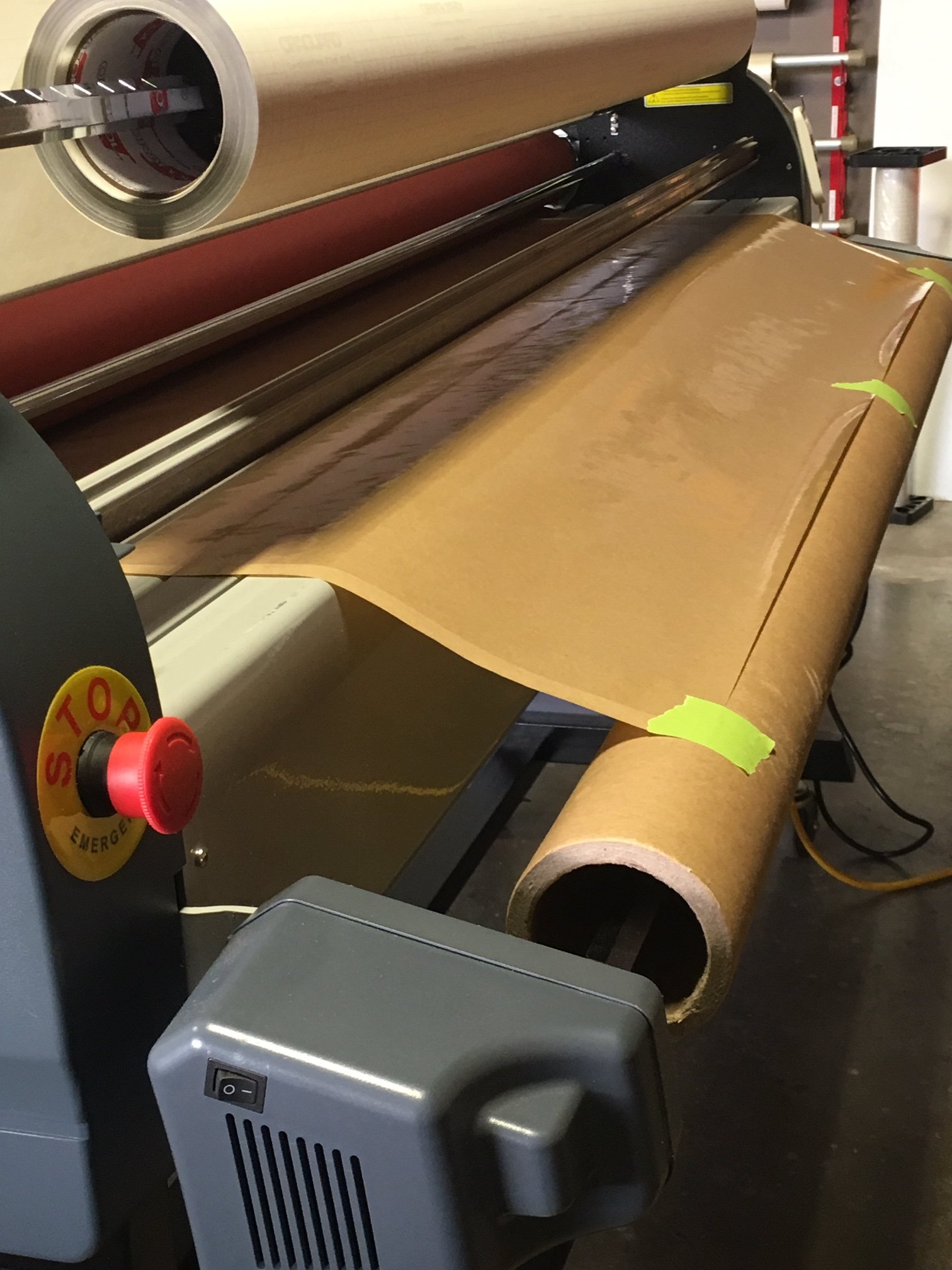

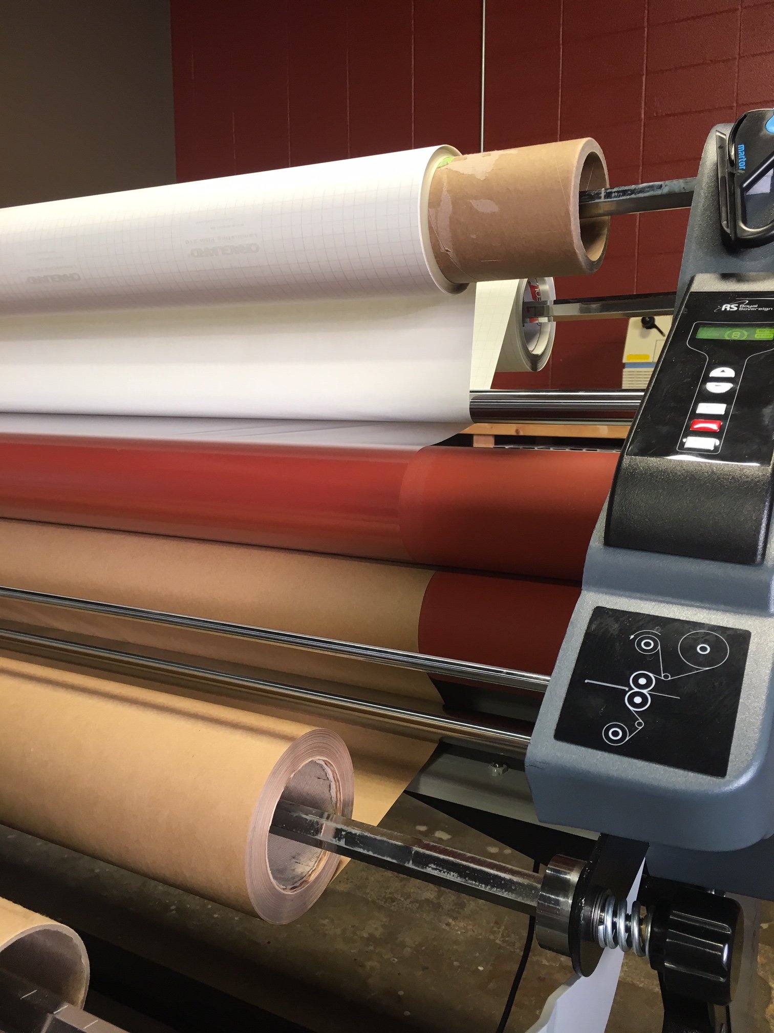

We have the same laminator shown in the video. Here are a few photos of how the kraft paper should be loaded. Hope these help. This model does not have the heat function. Our old laminator did, however we only used it a handful of times in 10 years. You don't necessarily need to use heat. Silvering will disappear given some time should you have any appear. I would web first then turn the heat on.
Thanks, those photos were useful.
Is there a trick to loading the kraft paper so it doesn't wrinkle?
We've found that the smoother you can get the laminate to lay on the roller before sticking the kraft paper to it, the less wrinkles we'll get. Calendered laminate is easier to get to start smooth due to the nature of it being thicker. Cast laminate is harder to start smooth. Cast laminate is much like trying to get Saran wrap smooth over the roller.
