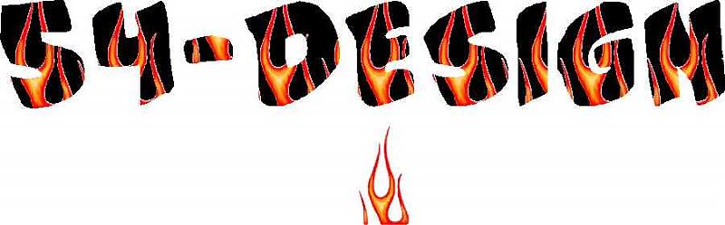

Aardy54@54-Design
think i got it
Well, it aint the best but my 1st try so the flames will get better
