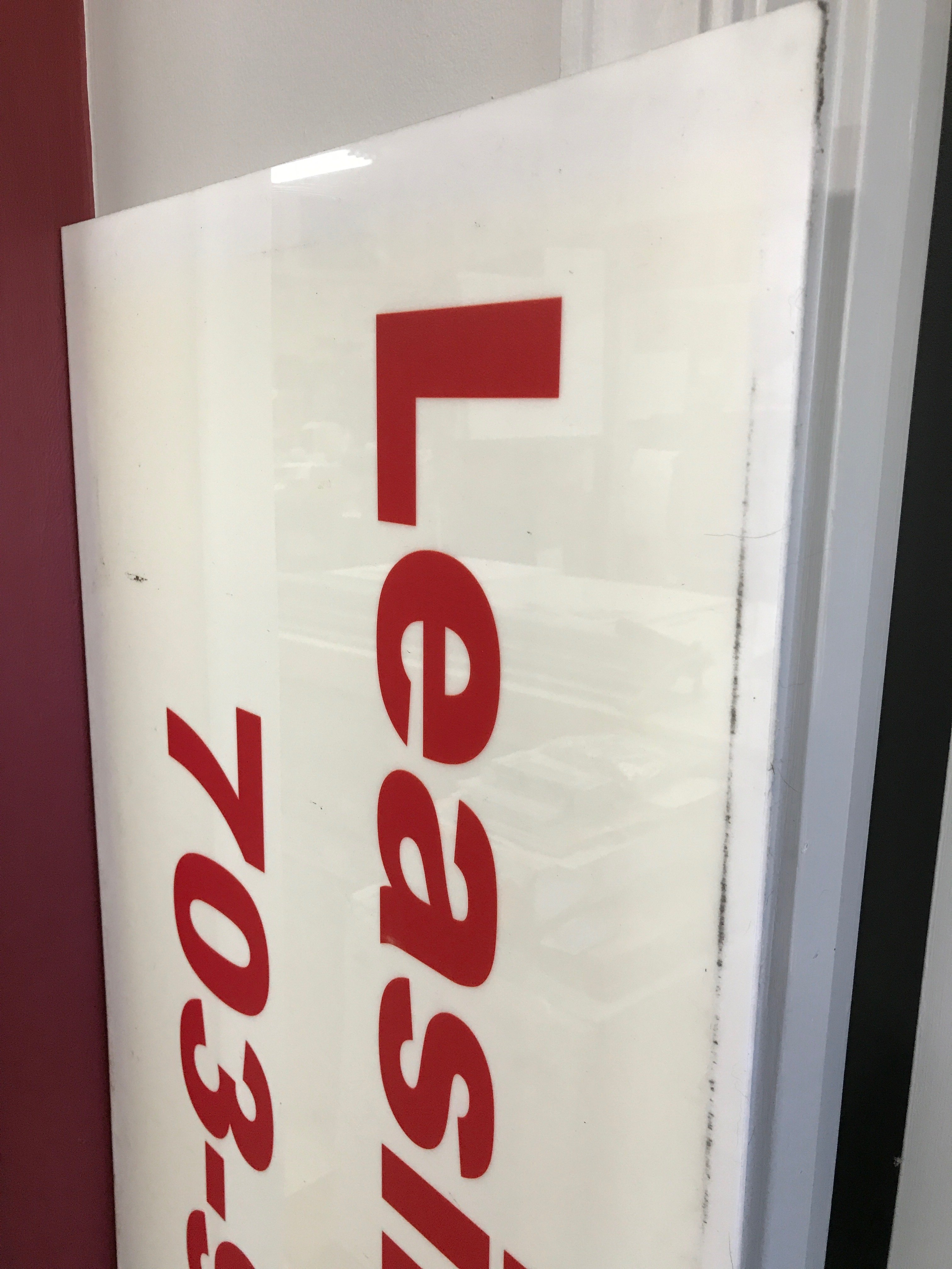

I'm never created a sign like this attached image before. It's Lexan / Acrylic 3/16" material. The sign is backlit. Can someone give me suggestions on how to create a sign like this using my HP Latex printer?

Are you using that same piece of acrylic? All you have to do is print some cast translucent vinyl and apply to the face of the acrylic.

Or cut red translucent vinyl on a plotter - I know, this isn't using your printer, but seems like a better product in this case. When printing for a backlit sign, you either need to sandwich some prints or put up with a washed out print when backlit or an oversaturated print when the lights are off.

I will being using a new piece of acrylic. This existing piece looks like it was printed on and not vinyl lettering.
When you say cast translucent vinyl, do you mean a full rectangular sheet (not cut out lettering right?)
I'm just trying to figure out if this is something I can do using my latex printer.

Yes, but you could just print it and cut out the letters if you want to use your printer. Easiest way is to just to do cut vinyl letters and apply. More than likely they printed that with a flatbed printer.

Thanks BigFish. The new sign i'm working on will have a large solid red background so I don't believe vinyl lettering would work.

By the picture I could tell, maybe, it is dedicated Backlit material. I used a lot in the past when Encad was alive. Backlit brand Kodak reverse mirror printing, glossy on the front so there is no way to damaged or need to laminate besides is a 240 gms. strong resistant material. Lexjet has Backlit dedicated film. You can find front printing material but in my opinion is better the reverse printing. I also used polycarbonate for ink jet, super.
