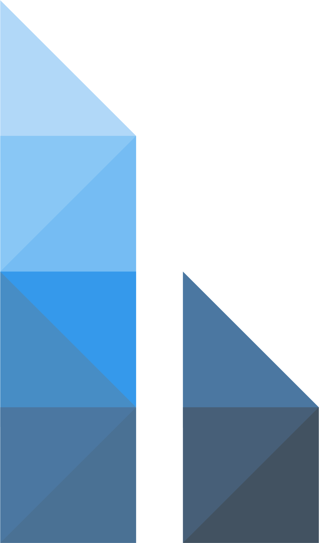

    Can you guys help me with this. See this logo attached. This is going on a clear glass door. This would be in full color and contour-cut. And this would be applied on the backside of the glass (from the inside facing out / 2nd surface). So my question is, how do I achieve this? It has to be this full color that will show on both sides (front and back) and has to be contour-cut. How can I do this. Or which vendor can do this? Please help!

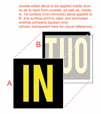

    We just did some "double-sided" decals for the same purpose i.e. apply to inside of glass yet visible from inside and outside.
    1. Print "mirror image" to clear vinyl
    2. Laminate it with a white vinyl that also has white
    3. Print a separate non-mirrored one on regular white vinyl
    4. Apply #3 to the clear one
    Our decals didn't need to be "shape cut" though. It was just squares and only about 20 decals so we just cut them with a straight edge and xacto. Wouldn't take much to implement reg marks for plotting though.
