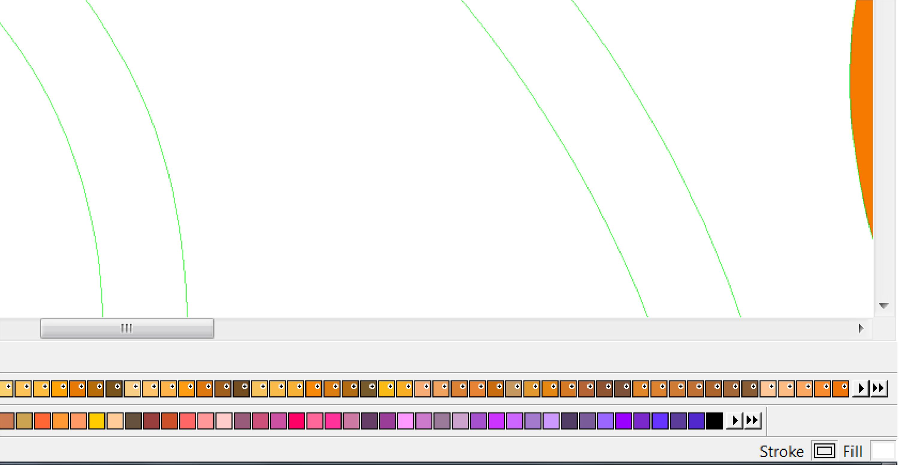

Now and then Flexi 10 places a stroke around objects even though the stroke box in the bottom right corner shows transparent as the selected color. Has anyone ever experienced this or found a solution?

No, I've attached a screen capture. Flexi gives the option to add a small stroke around all objects it defaults to transparent but sometimes it isn't transparent and even if I open a new document and import or copy/paste the artwork it retains the stroke and it shows when printed.

I've seen this when importing files created in other programs. If that is your case, you should go back to the original program and clear the stroke. I have tried to clear it out in Flexi a few times but always had a little trouble and it usually takes some time.

Whoa whoa whoa. Guys, there is a toolbox called "Fill/Stroke Editor." In that box you'll click the second button called "Stroke." It has a pencil icon. Hit "Clear" and your imported stroke is gone.

I think you're talking about the same thing I was asking about, in my case it's not an issue related to importing art from another program but actually occurs in flexi created artwork. I tried using fill/stroke editor and hitting clear with the artwork selected and that removed the lines I also tried Effects:Combine:Weld by Color with the item selected and that removed it as well. As far as what causes this to occur I can only think it's a glitch in flexi that causes it to default to a color stroke instead of transparent.
