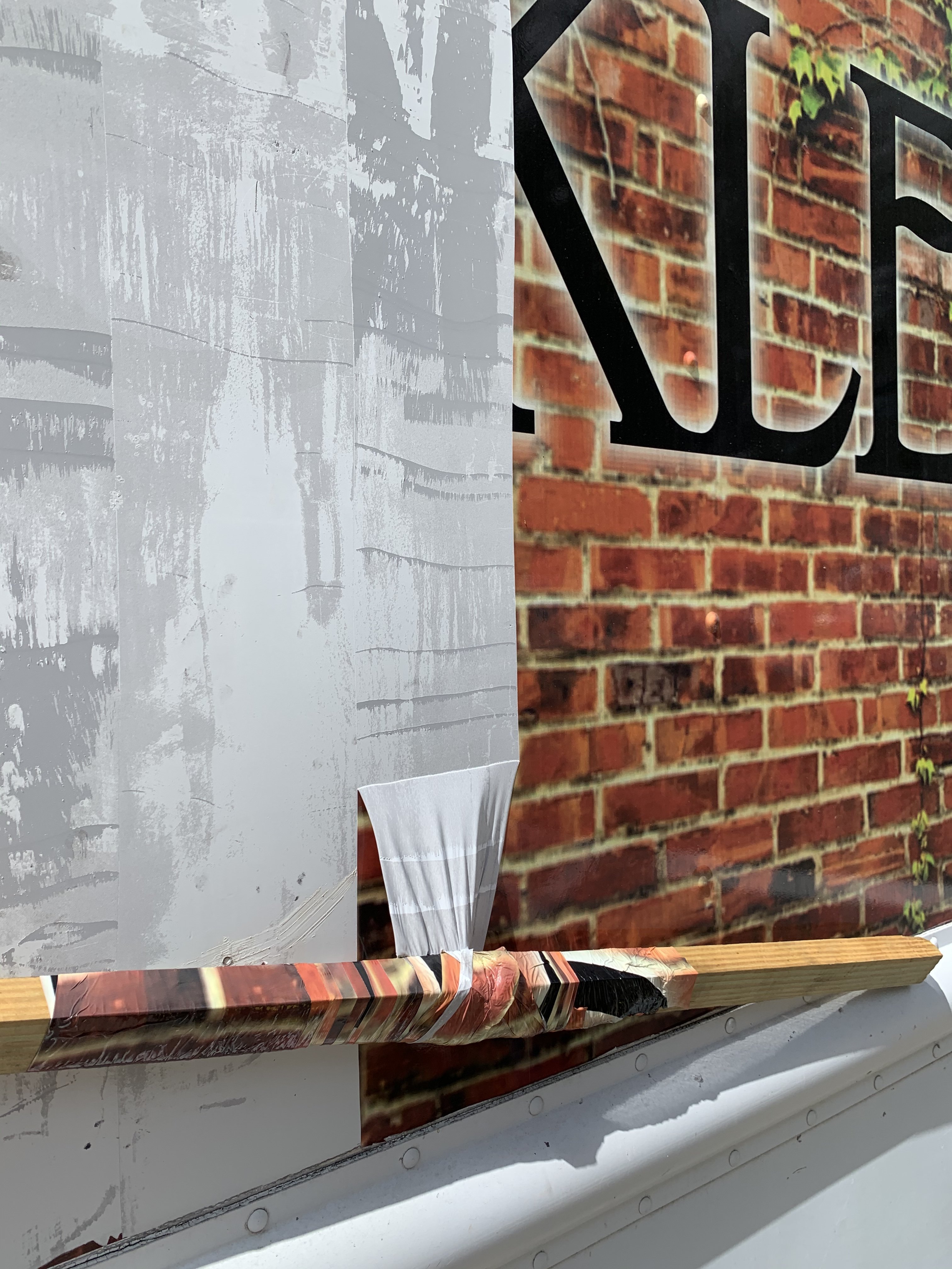

geckophoto
What’s best solvent to remove grey adhesive left on the trailer after heating the vinyl to remove? Used a stick to pull vinyl off easier, grip like doing a pull up and a lot les strain on my hands/fingers!
