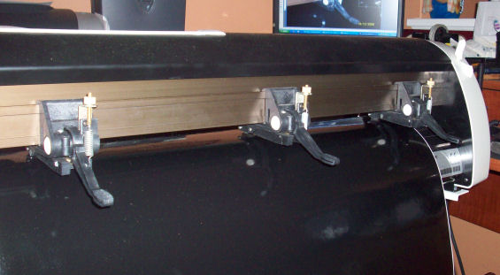

    Hey folks, I have a vinyl plotter, and have to date cut quite a few logos and pictures out, however Im curious whther there is a setup procedure for the roller down pressure.
    I originally had set it clean with no film in and wound the pressure rollers down until they didnt move, then fed some film in, I found it was slipping so wound all 3 clamps down a further turn, still slipping a little, then I wound down a further full turn and now its not slipping but the middle roller is leasving imprints in the vinyl.
    Is there a setup procedure that people use or does everyone kinda just wing it.
    Thanks

    Awesome thanks. Yes I was talking about the pinch rollers. I have 3. They have the ability to be adjusted via a pressure knob, the imprints being left by the middle one was a bit concerning.
    I was curious whether there is a setup procedure
    here is what Im talking about

    yours is for sure fancier than ours... maybe someone with that model will be able to comment. I find that everything you might find in vinyl, from a dent to a slight crease to a bubble... goes away the instant the backing is removed and it's hard-squeegeed onto a surface. Can you confirm that the track is still visible even after the vinyl has been applied? I'd be surprised if so. Is it kinda thick vinyl maybe?

    set the middle on light if you can. dont worry about the imprint it will go away on the install.

    Correct, the markings go away when applied and in the sun, however I was curious as to whether there was actually a setup procedure,
    I have had a couple of times the vinyl bunch up and stuff the job, that is I think I had to much pressure set and it was pulling the roll out of alignment with the other two rollers.
    I think what I might do is set it so it starts to leave an impression and then wind it back a turn or two
    Thanks
