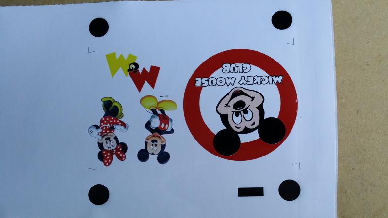

Hey guys i have a versacamm sp 300, i printed and laminated the sign, but now how do i align or setup machine to cut using the crop marks 20140924_081651.jpg
JgS
If you already set up a contour cut line than feed it back in the machine at no more than a 5 degree angle. go back to the file in versaworks and set it to "cut only". the printer should do the rest. If not you can set one up and reload the file. if you just need it cut at the crop marks click the cut image boundaries check box. Or do it by hand.
strypguy
Make sure the crop mark with the extra horizontal bar is in the upper right hand corner and is in line with the carriage or it will not find the crop mark. John
