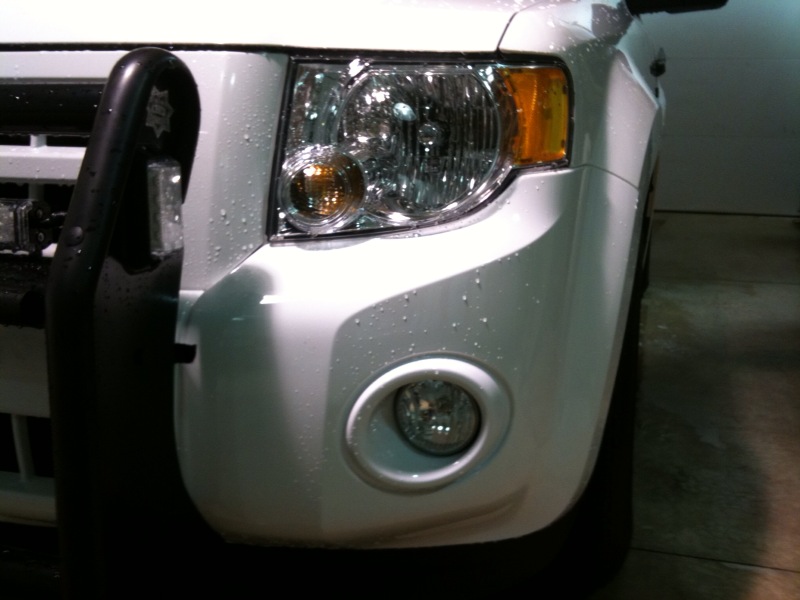

Hey guys and gals,
Got a Ford Escape here I am mapping out that I am going ti wrap tomorrow. I have a section that looks to be a bit of a challenge.
I guess I am just wondering how you wrappers out there would attack this? The bumper and fog light area in general is the main concern. I have done several wraps just wanting to know the right way or how some of you with more experience would go about this.
The area is just going to be wrapped solid black.

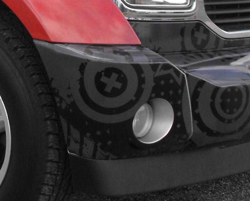

I assume you're talking about the fog light causing the biggest issue. We would probably cut a relief in that groove around the outside of the foglight... otherwise it's sure to fail. Then we'd face trim it where it makes that 90 into the light pocket. The inside of the fog light would not get covered. However, it will hardly be noticeable.
Here's the front bumper of a Nitro we did to kind of show you how we'd do it. Notice, we actually did this bumper in 3 pieces because the angles were ridiculous. There is a small line of paint exposed where we clear stripped it, but I think it looks fine and will probably last a lot longer than if we tried to work the vinyl in there.

Thanks for the feedback. After speaking with the client about it we decided to leave it white around that area. It really doesn't look bad and we know it isn't going to fail on us..
