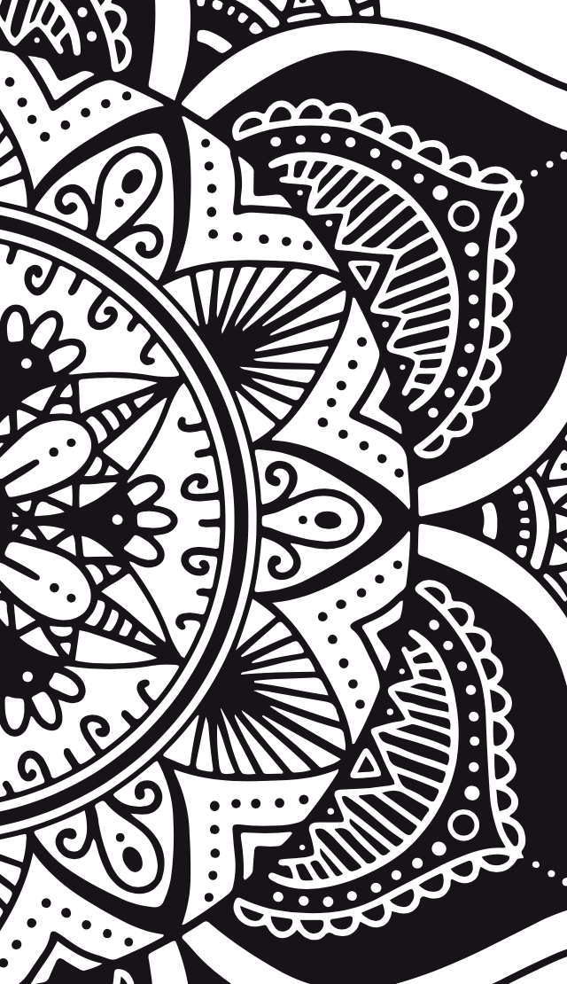

Definitely in the running if I can't find something printable to do this with. Just that's a LOT of weeding. Like a LOT a LOT. The full image of this but also with some block letter text in the middle of it. Will definitely suck to do if that's the way we have to go.
Good tip about not peeling until applied, is there an application tape that's more conformable than others?

MikePro
convex conformable? i doubt it, besides still relying on the material to also do with another material "holding it back".
....but I'd still rock it as a challenge. you can make those bits conform no problem, just start applying in the middle and tear-away mask & smoosh paintmask as you go. could be fun.
i'd actually take that whole pattern and offset all the shapes ~.063"-.125" & weed those lines out prior to mask, to allow a little "empty space" for the mask to conform as much as it will let you.
water may help with this "stretch" during application since most transfer masks are paper-based. ...like wetting the mask, not wet-applying. paint mask is great with its ability to peel&reposition/replace prior to committing to paint if you're gentle.
(i'd still score the mask and tear in circular lines in center of those radial paths, and the rest of the paintmask should slightly conform with a lil'tug.)
any wrinkles on the back-end, just take a sharp Xacto and slice it away & patch problem areas. finish with a scrape/chemwipe of any problem corners where paint makes it under the mask.

Print on something premo, like arlon slx, plot, don't weed, mask with rtape conform series or the like, prestrech the center, apply, weed. A 36" circle with a 4" rise is only 38" across the face, not a ton of distortion there. You could probably get away with 3m 7125, it's just not going to stretch quite as nicely.
edit: alternatively, print on SLX, plot, weed, laminate with a great cast laminate (I forget arlon's number, 3200 or 3220), apply using the laminate as your premask. Again, prestretch is key or your outer perimeter will overlap itself/fold over somewhere.

Could you print the black (double strike to make it opaque) on clear?
Orafol has a gloss, cast, conformable transparent wrap film (3951 ultra slide). I would think that wrapping from center outwards, any distortion should stay uniform and "look right".
Just a thought anyway. Maybe see if one of your vendors can send a sample to play with.
ooh, that's an interesting thought, using an optically clear lam as a pre-mask. I still want to print not cut and weed though ideally.
THAT is the kind of info I'm looking for. Gonna research the transparent wrap film and see if it is clear enough to not fubar the mirror look. TYVM!:goodpost:
