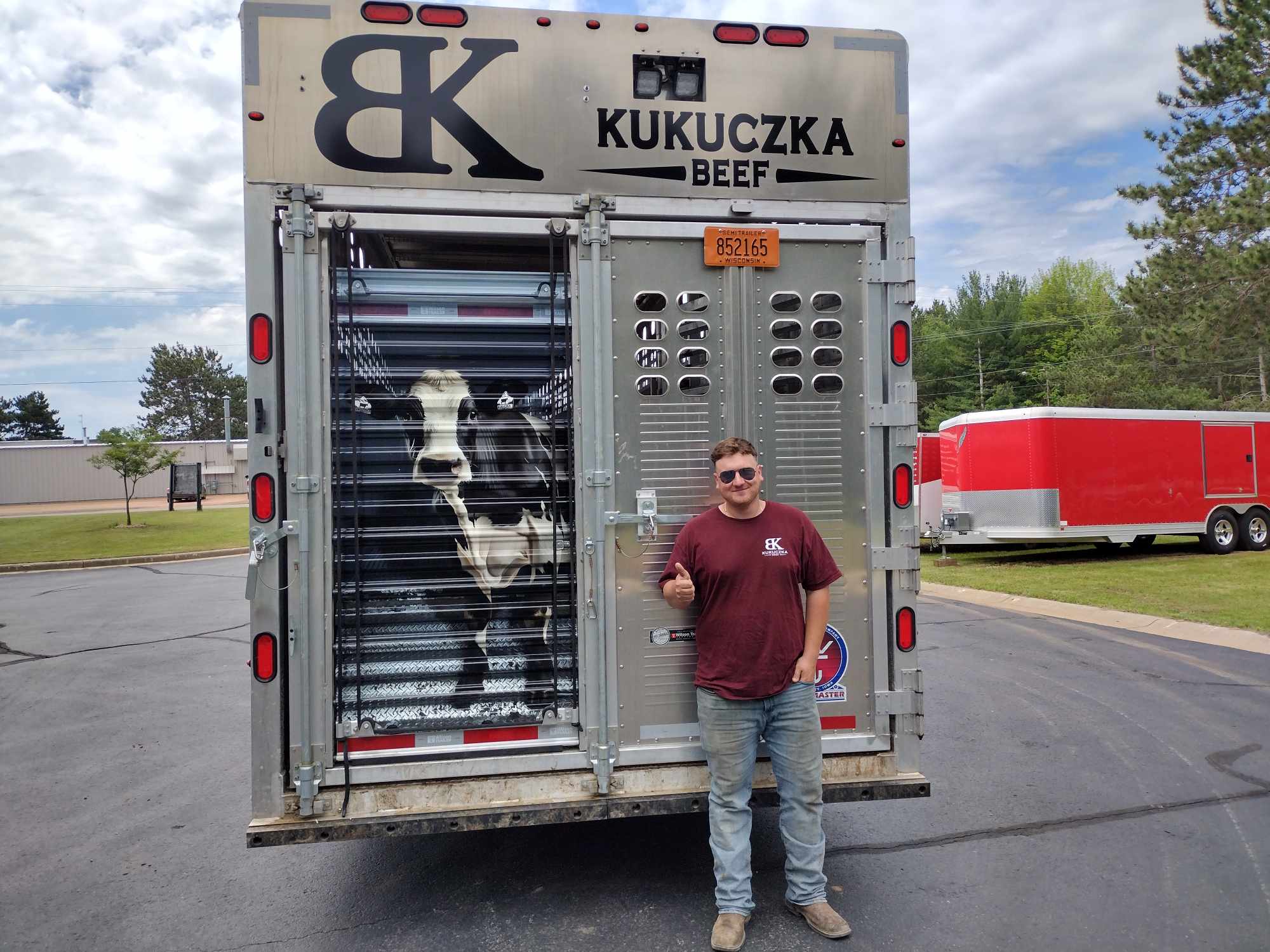

I feel yer' pain... I seem to get all the stuff that other shops don't want to touch, like the one I did yesterday, wrapping a roll-up door on a cattle trailer. Guy tried several shops, all gave a quick "nope". 9 pin hinged heavily corrugated panels, couldn't remove the door to do it. Boss said, no problem for our guy (ugh). Pain in the.... But it turned out cool, customer loved it.
Gotta do your share of these jobs to set yourself apart from the herd too (so to speak). Even the ones that make ya' wanna take up day drinking :toasting:
