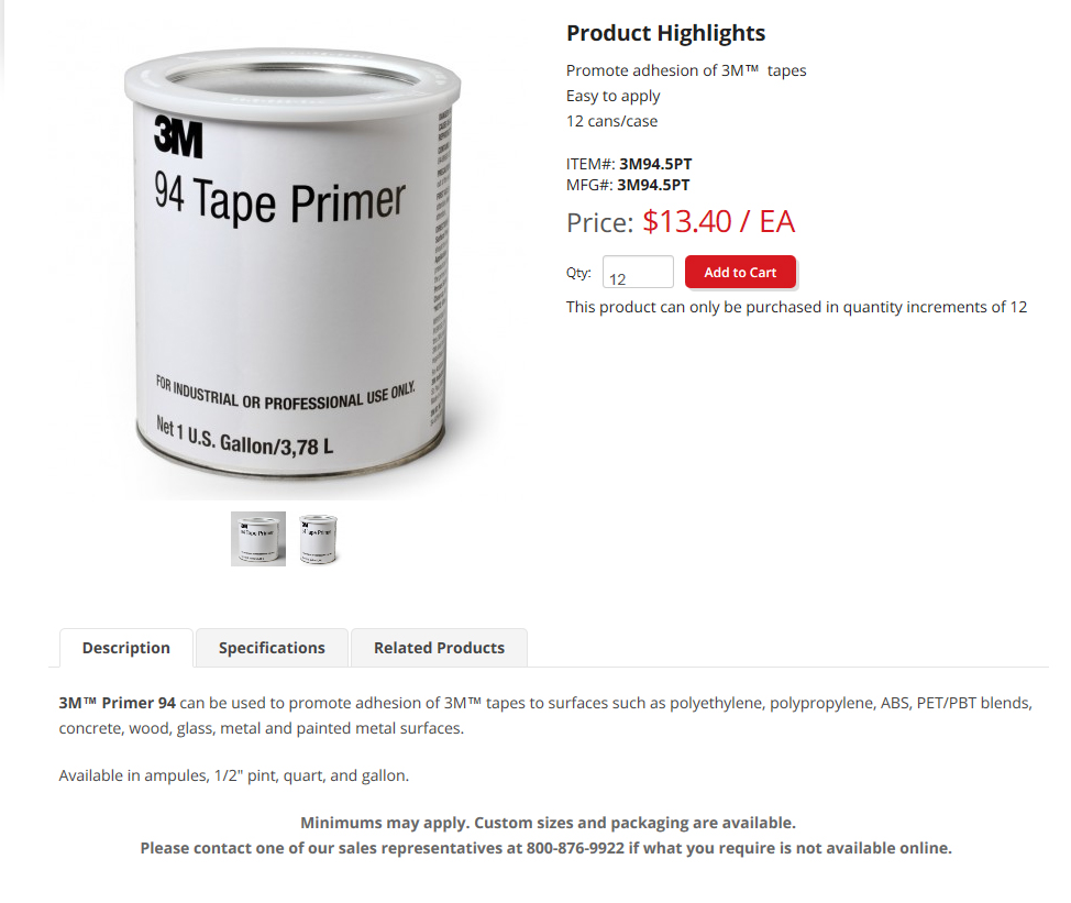

    when I was checking tapes, I found this product that might help. it's an extra step but it might help
