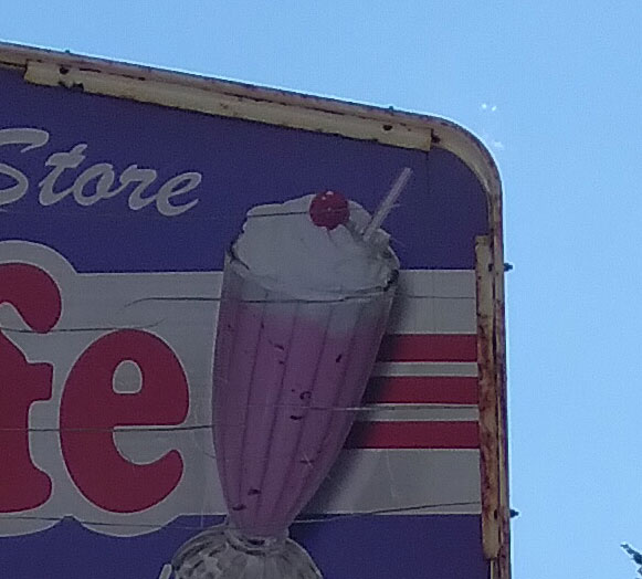

Thanks for the input, and I had some of the same ideas...maybe fastening two 3mm panels together (Val, I already checked with Sun and they do stock 10x5 sheets of 3mm). Whatever is up there now is probably 1/2" thick and there are metal tabs around the frame creating a channel to hold the panel in place, so whatever I end up using has to fit snugly in the channel. (see this close up image)

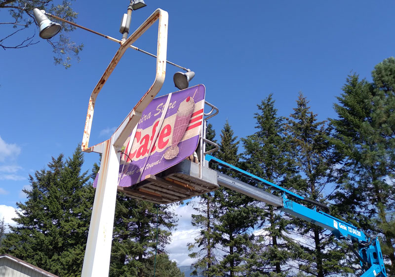

Gino - I already quoted running two lift rentals on this job: one to go pull the old panel down and measure, and another to install a new one. The structure itself is over 50 yrs old, and I'm guessing the current sign face is at least 20-25 yrs old based on the looks of it.
On the other side the tabs are screwed on. We'll be cutting them off with a grinder.

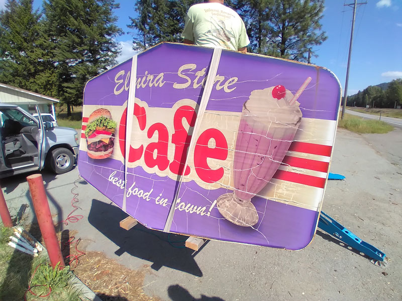

We got the old sign down, turned out to be 080" gauge aluminum, not plywood like I thought. That sucker was heavy. I'm using it as a template for a brand new panel - would you recommend going with solid metal again or would 3mm ACM work okay? I have some 3mm 10x5 sheets in stock, easier on our end because I can cut ACM in the shop but metal I have to send out. The sign dimensions are 86x54".
We also cleaned up the entire structure, sanded, primed, and repainted. I'll post final pics once it's all done.

You can cut 080 just the same. I'd weld in more vertical supports and stick with 080. I'm surprised that even stayed in there

I can't cut 080 at my shop, has to be sent out, but I can handle ACM. The mounting brackets were pretty heavy duty sections of angle iron so it'll sit pretty tight up in the frame.

*fist pump, fist pump, Woohoo, congrats! Yes, post pics. Now that we can the inner, there is no support in the center so I still think 6mm would be more rigid than 3, just my 2 cents and .080 is just solid aluminum so can't argue with that but the cost and weight.

I'm thinking of going this route, though I'm wondering if the two panels even need to be adhered together. The way they get mounted into the frame is pretty tight and I don't see a benefit to sticking them together. Here's another close up of the side with the removable brackets, there's six total for each edge of the panel. On the other side the brackets are fixed, welded onto the frame.
