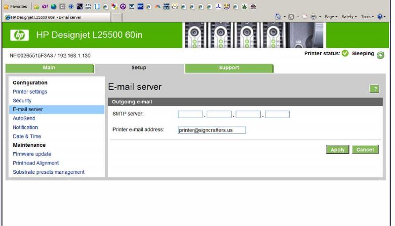

trying to set up the notification whereas it will email me when errors happen and can't figrue out how to set up the email server.
it's asking for my outgoing email SMTP server ip address and i can't figure out where/what it is.
i've tried nslookup mail.domain.com in a dos shell and it returns an IP address, but this doesn't work when i plug it in.

i use windows live, but hp isn't asking for the normal smtp name, they will only accept an ip address....
ddarlak
Go Bills!
responded:
failure,
please note that you need to configure the email server to make changes effective....

just figured it out.
went to cmd and pinged my smtp and magically my smtp ip address came up.
thax 4 the help
