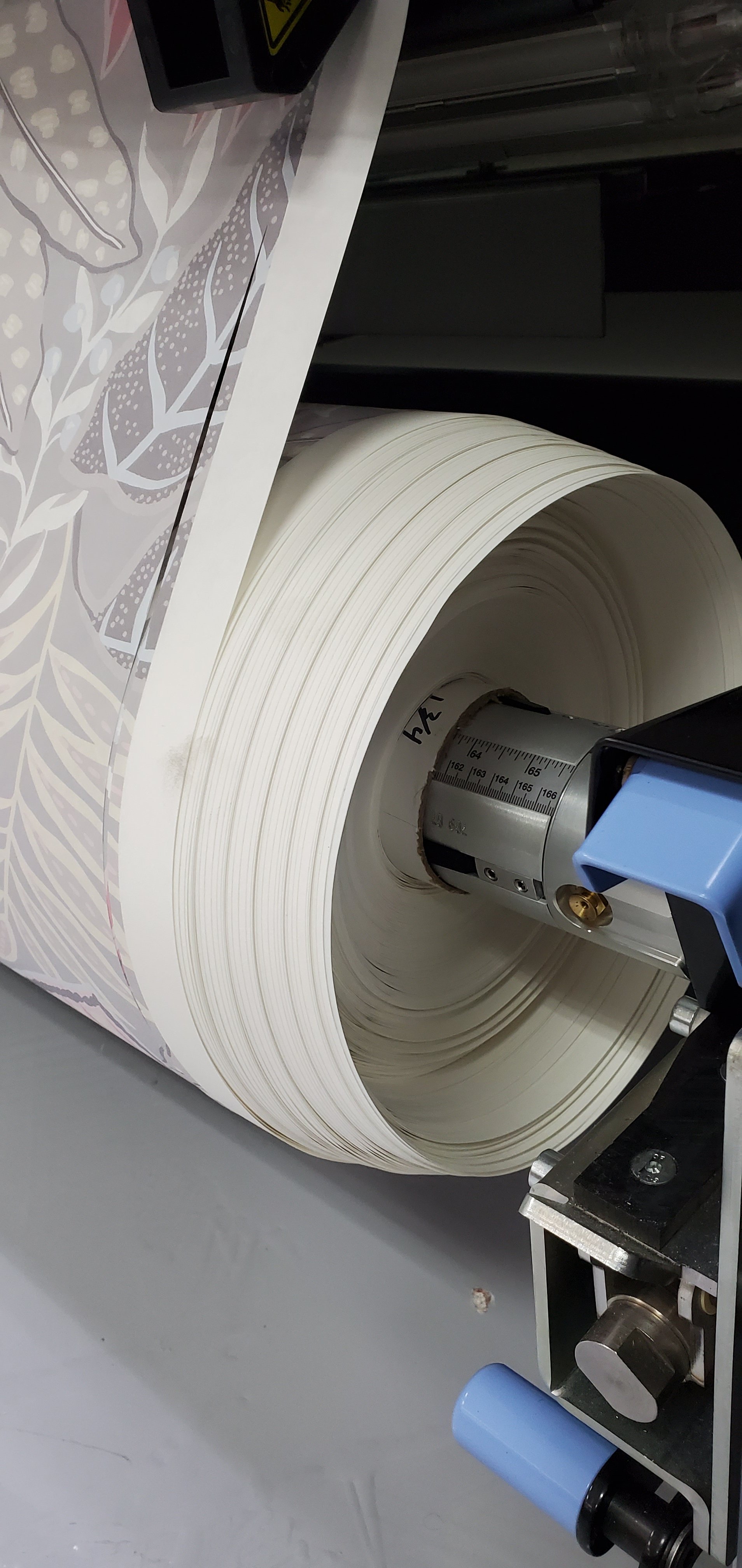

HP direct tech's. When printing, the material tends to walk left and right on the take up,tthen the head ends up crashing cause of it. We use the guide rulers on the front and back to line up the take up. We're around: .2-.4mm skew. A d it still does it. Sometimes it prints fine for hours , then all of a sudden walks

I also noticed in one picture you're using the slitters. Does it occur without the slitters?
Sure does! The issue when using slitters, the trim underlaps the print after a bit, then causes the edges to build up higher and really shift the media. So being that i have to trim all of my prints (thats why we bought this machine cause of the slitters) i created a vac system to suck out all the trim and dispose of it to prevent this from happening. but the media still dances back and fourth. It then causes head crashes cause theres less tension on one side Vs. the other.
