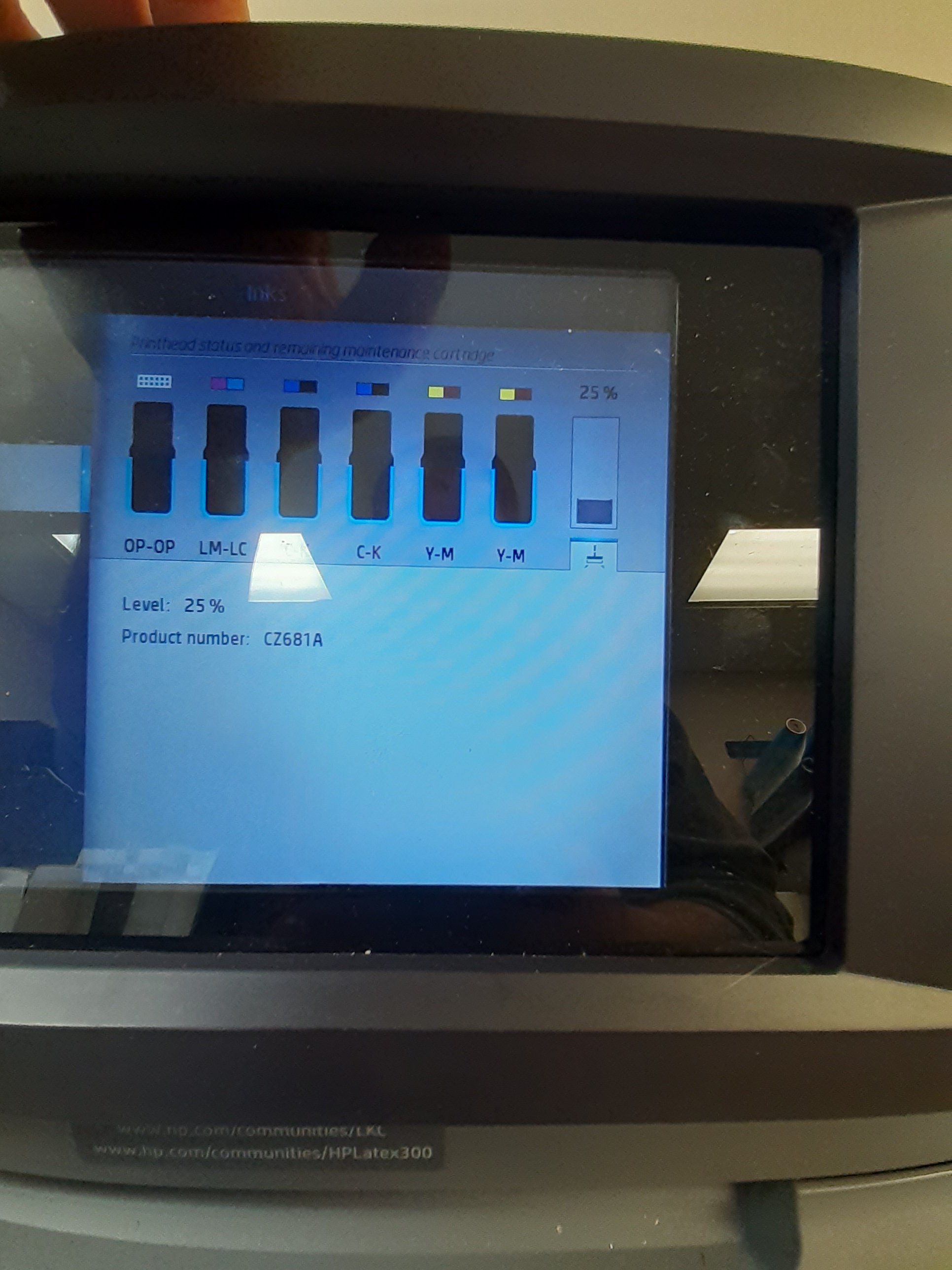

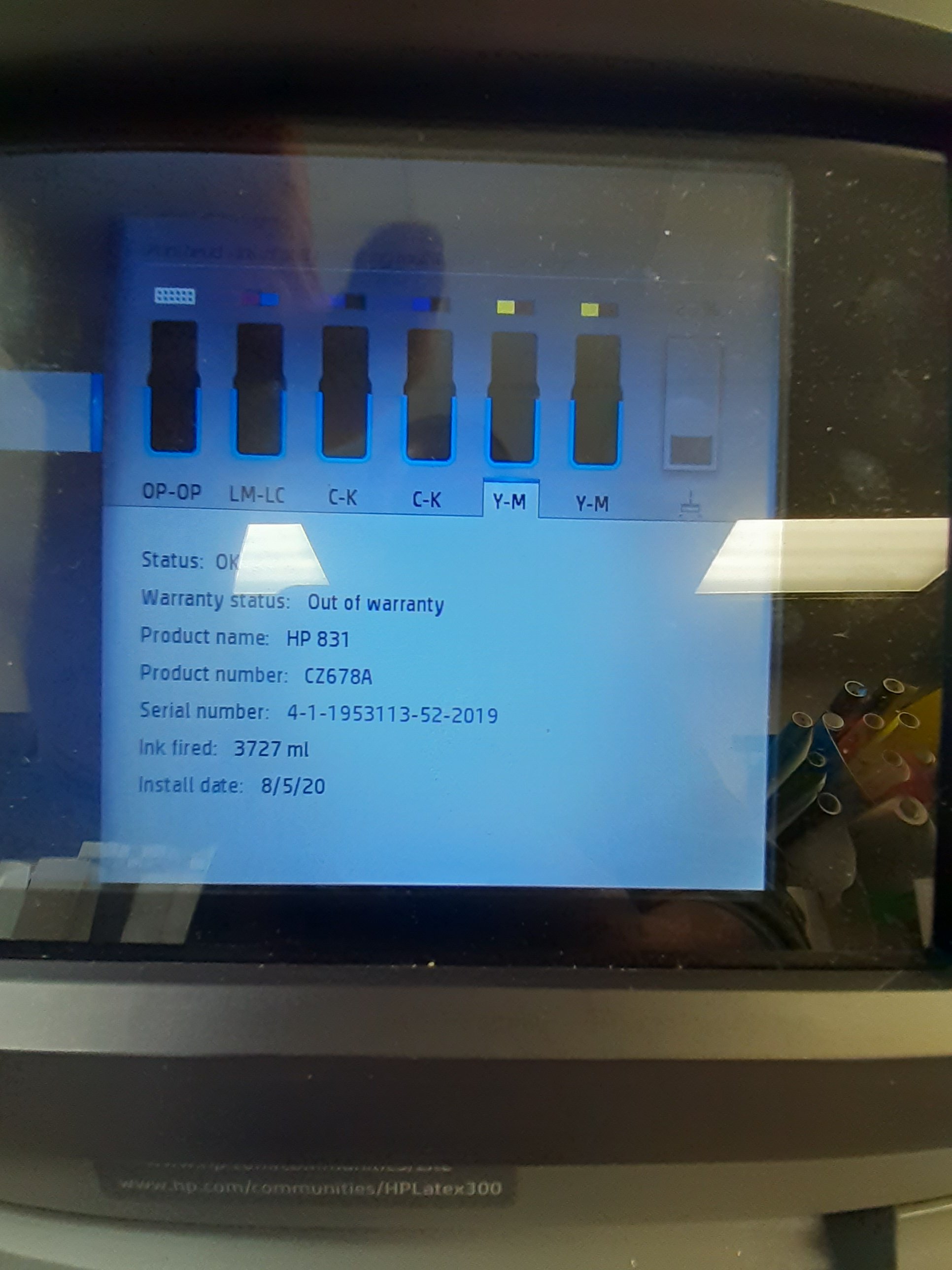

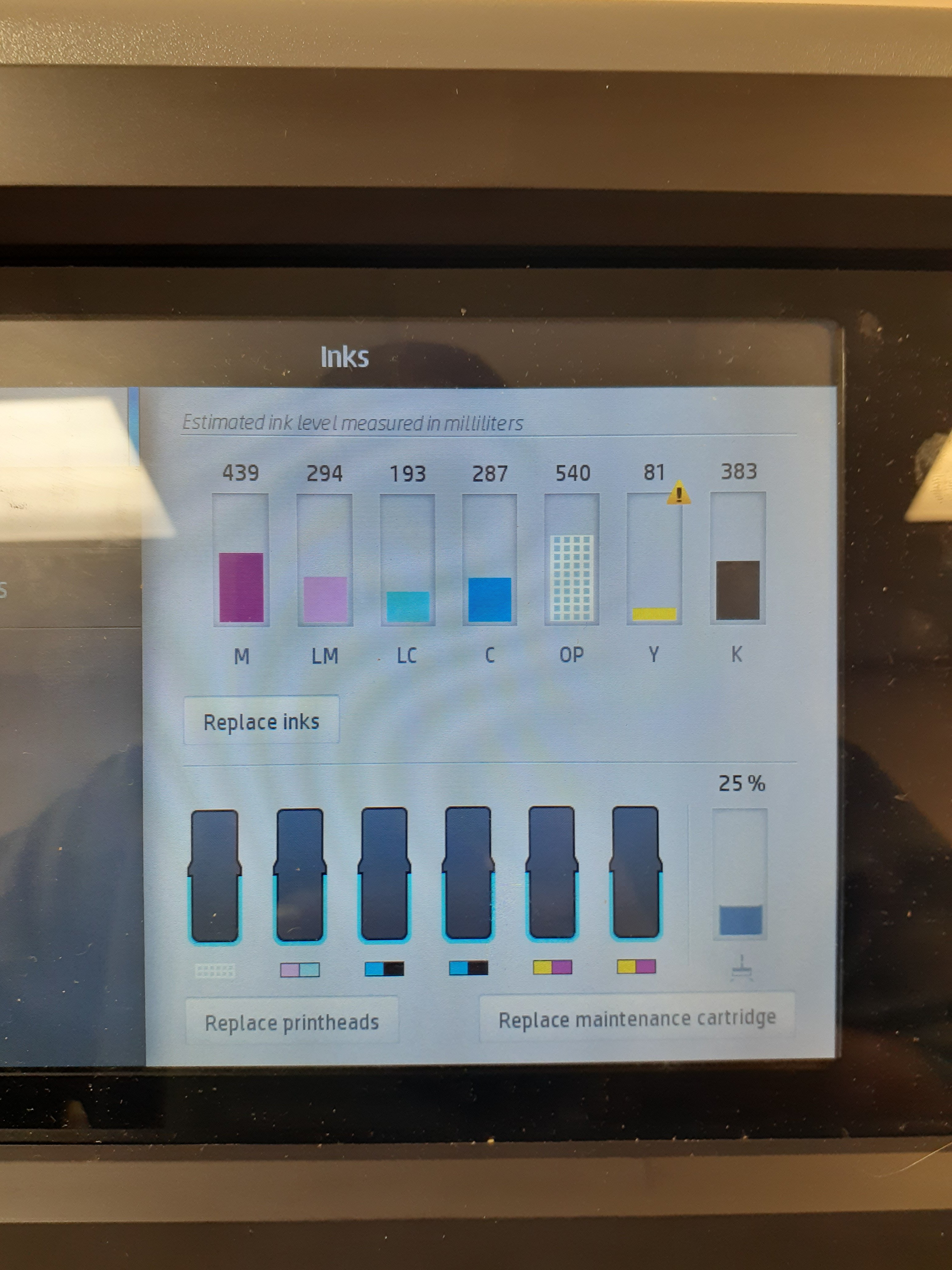

So if I read correctly you have not replaced the printheads?

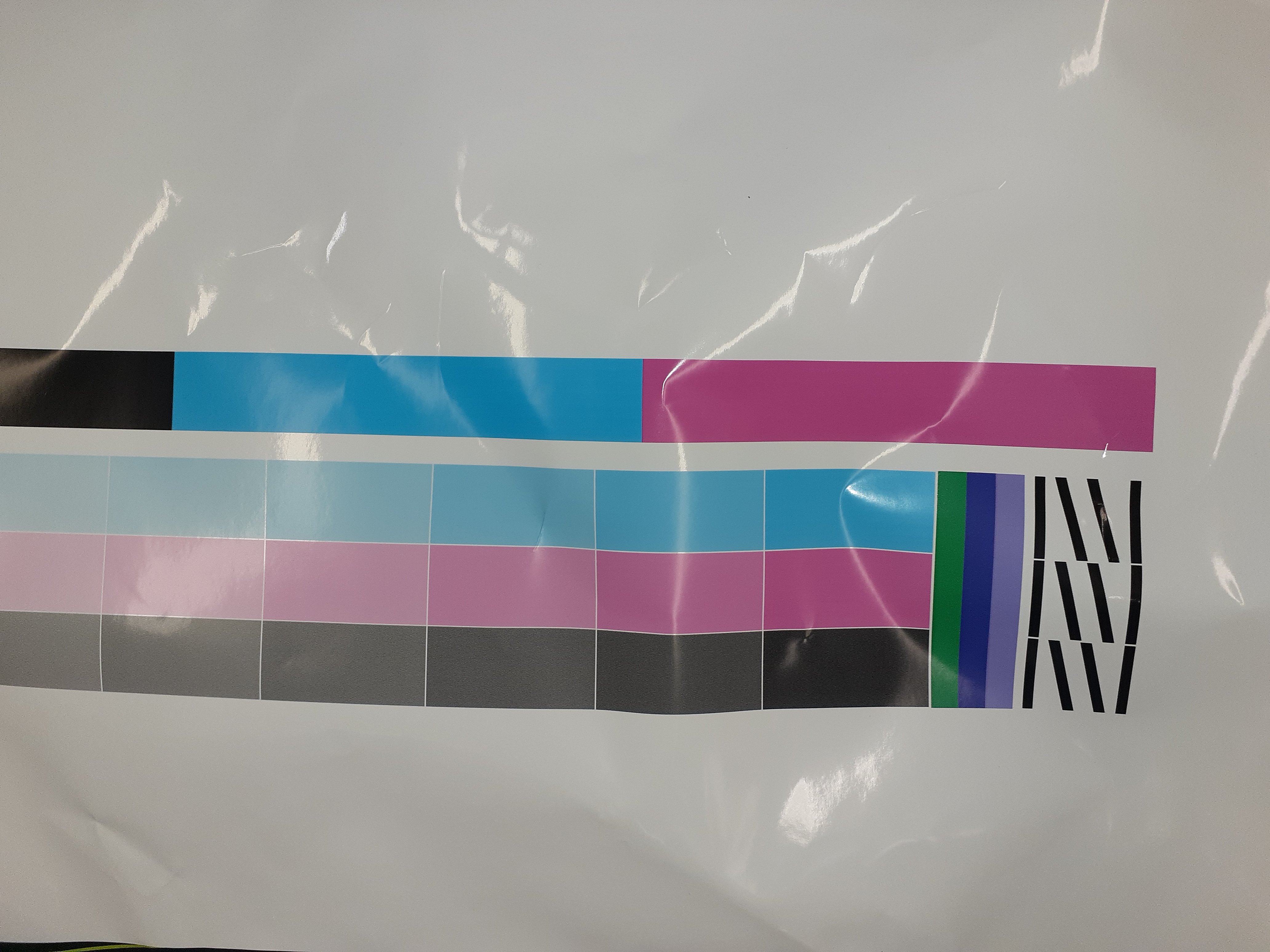

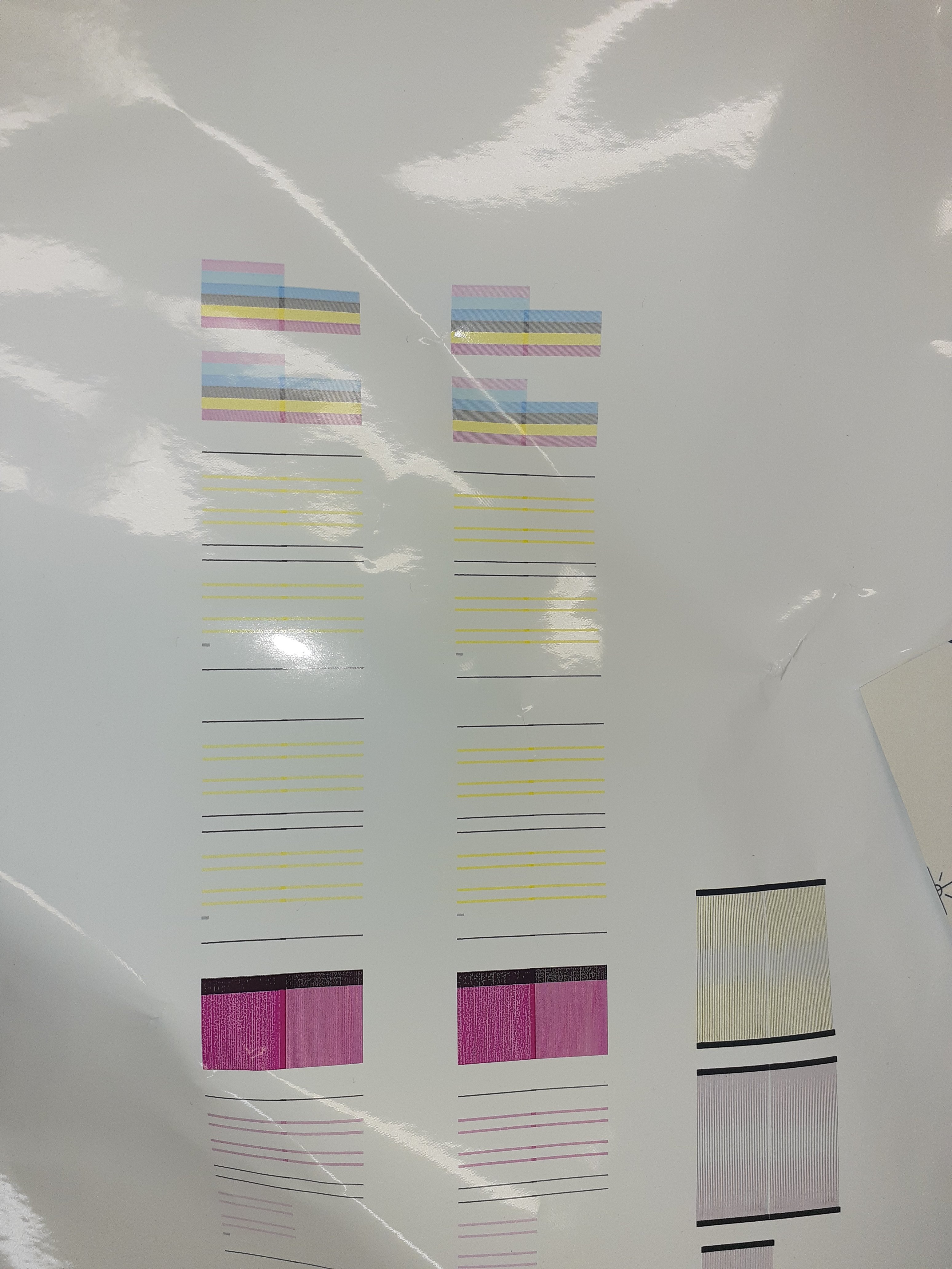

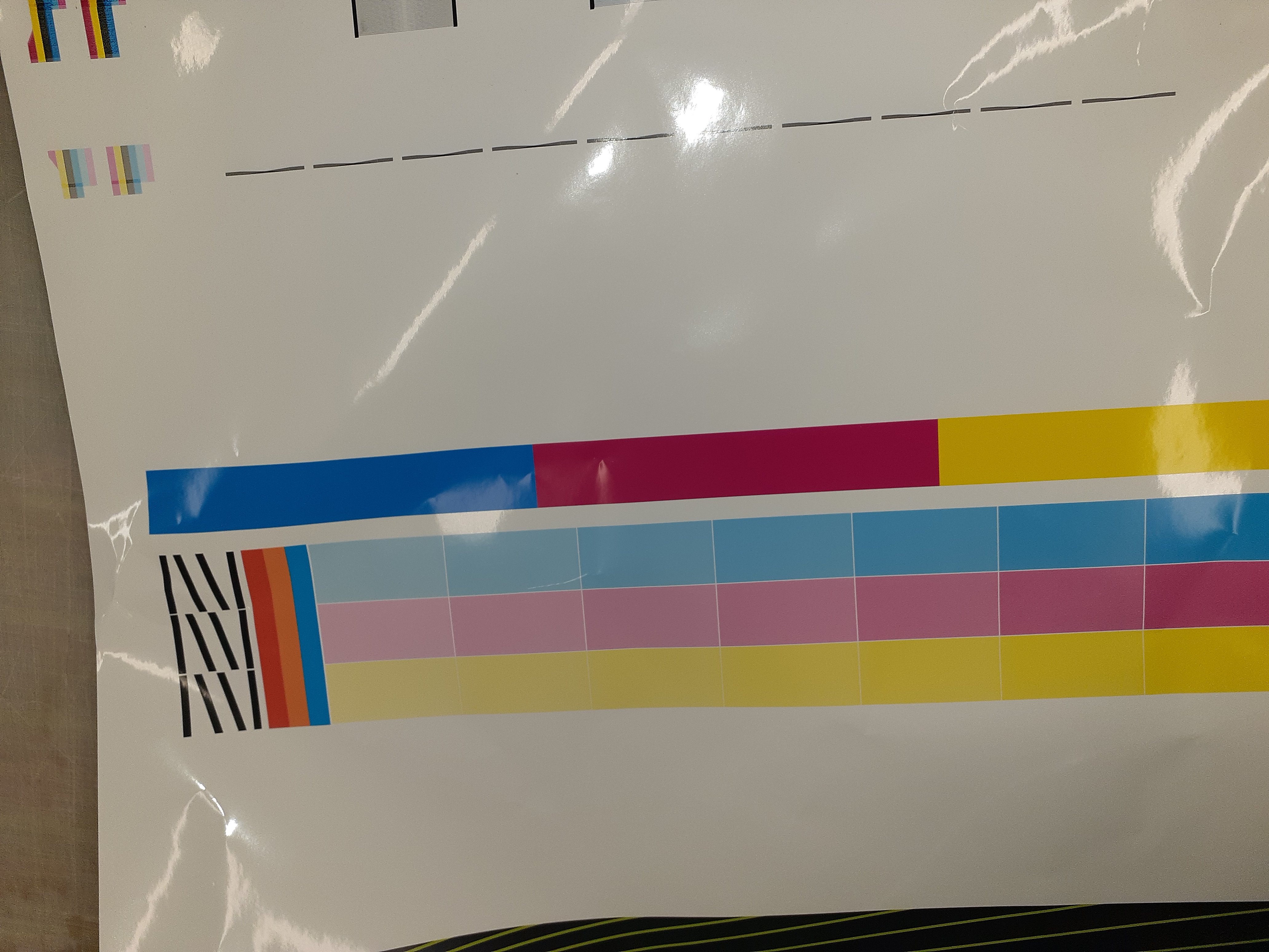

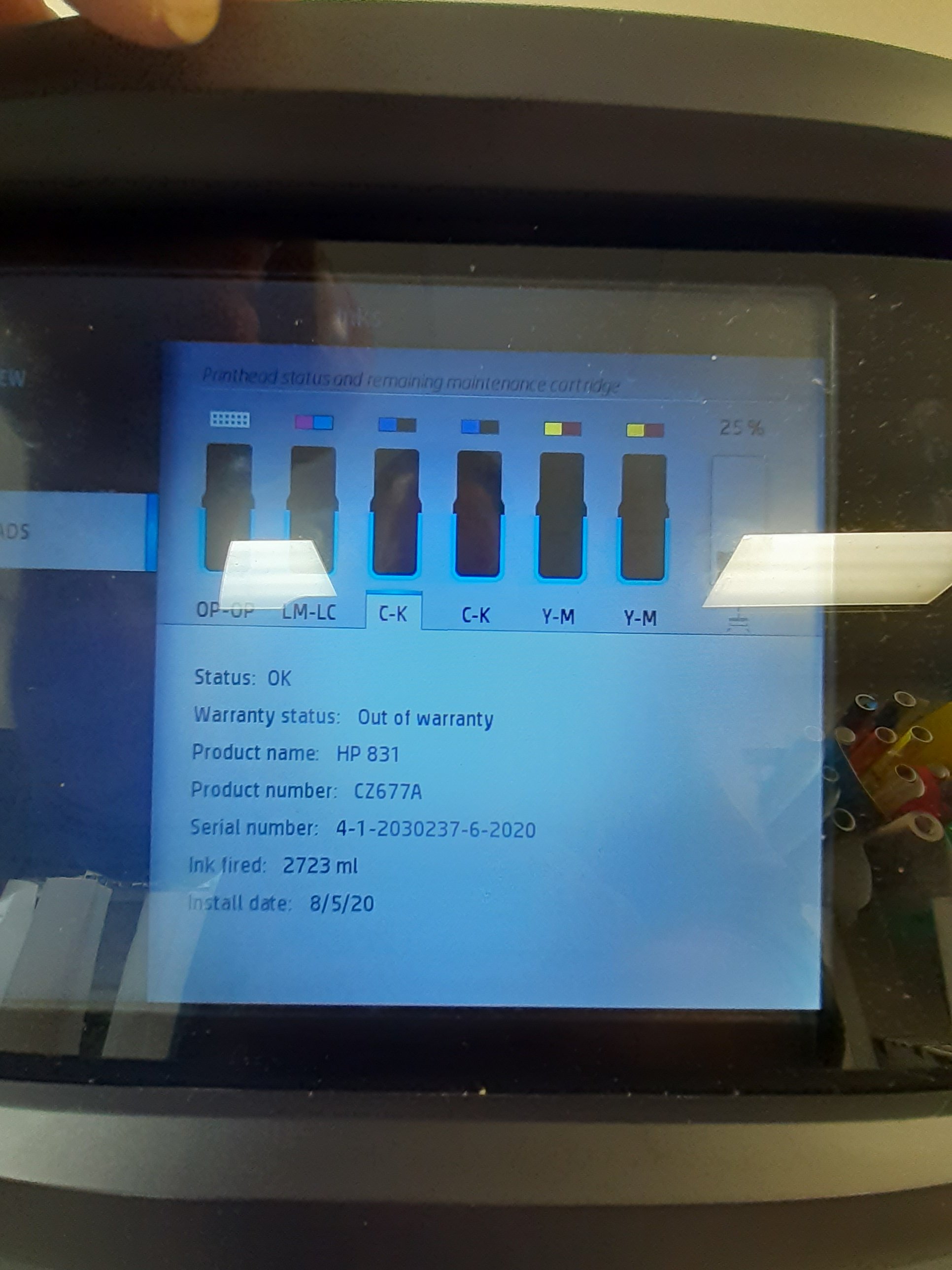

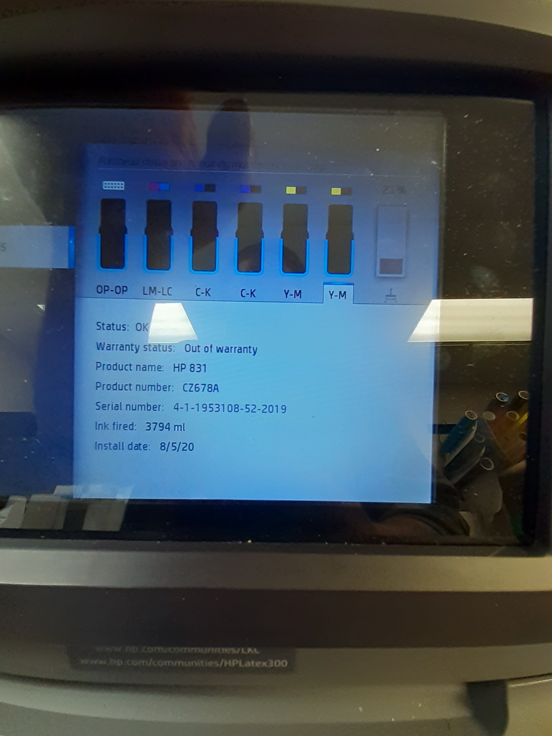

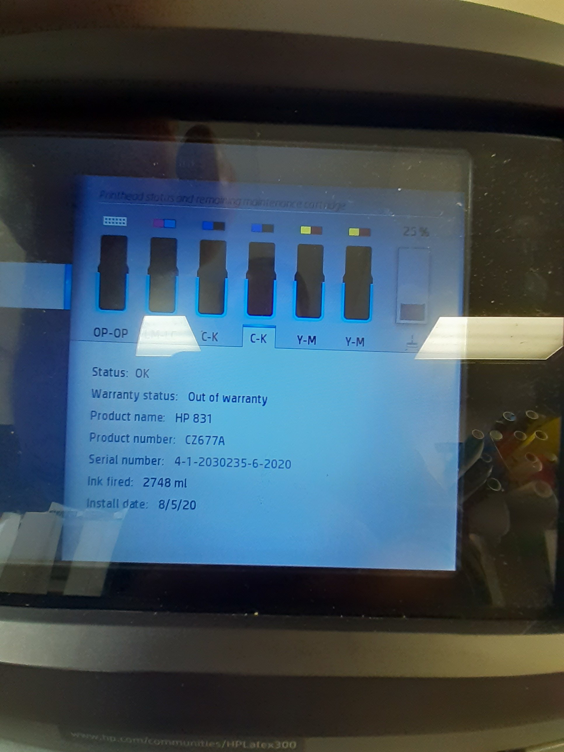

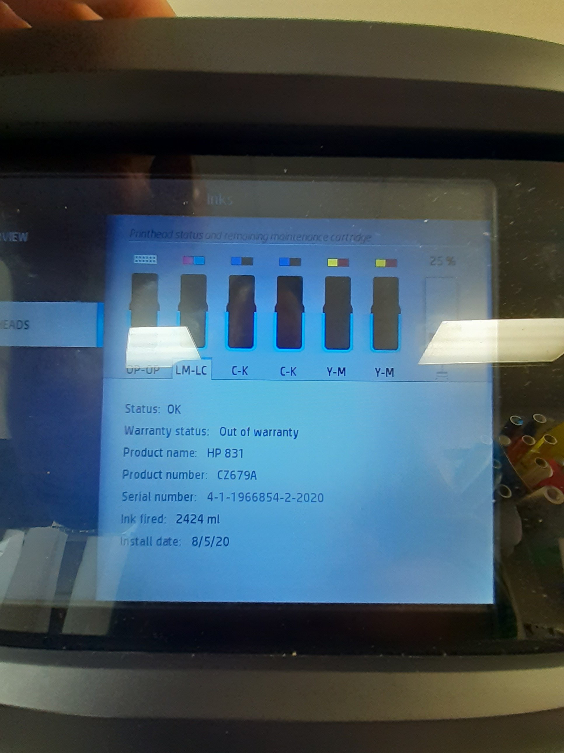

Please check and post here how many millilitres has every head printed.

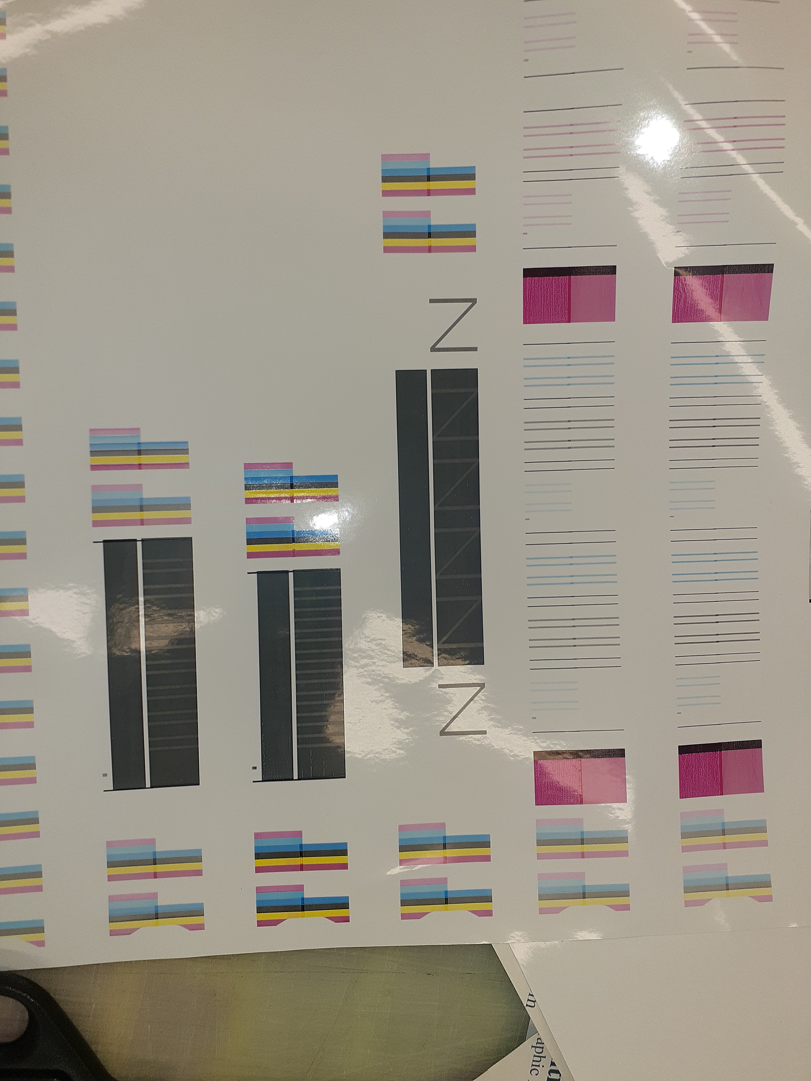

Also please do print a nozzle check and take a picture of that as well.

Pat Whatley
20201228_141845.jpg 20201228_141944.jpg 20201228_141951.jpg 20201228_141959.jpg 20201228_142010.jpg

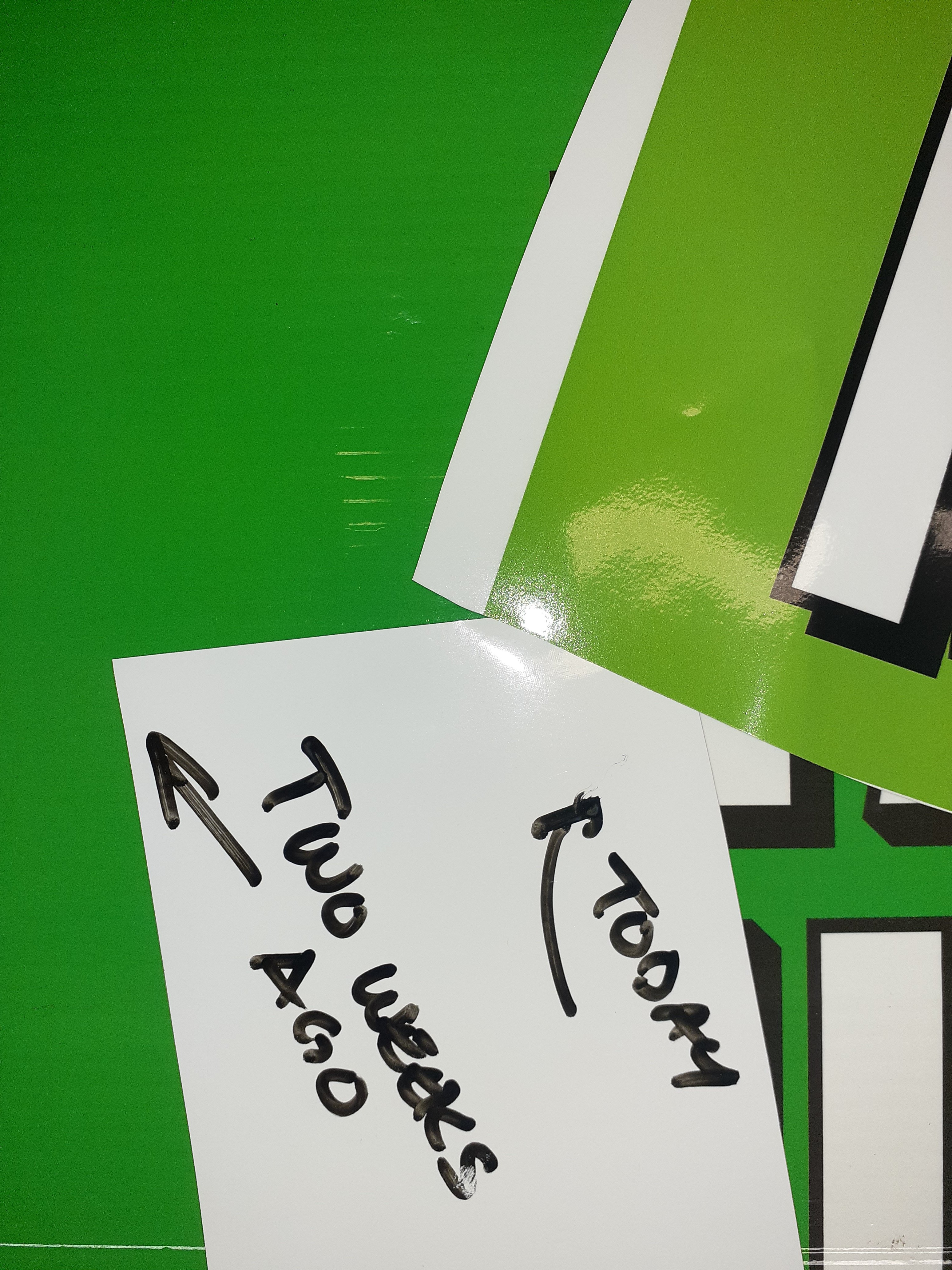

The TODAY/TWO WEEKS AGO photo makes the colors look a lot closer than they are. Two weeks ago it was almost fluorescent....today it's almost a mossy color.

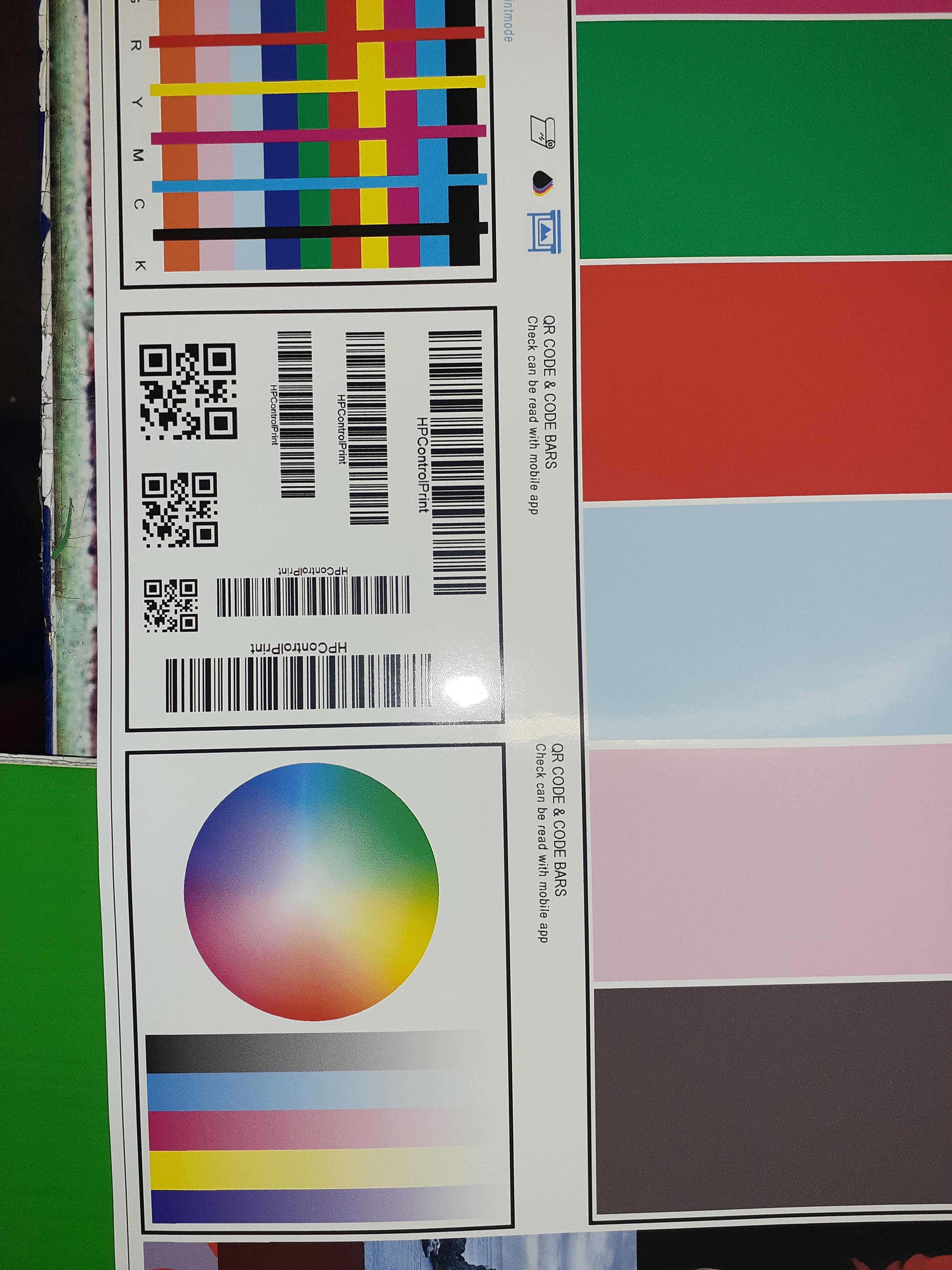

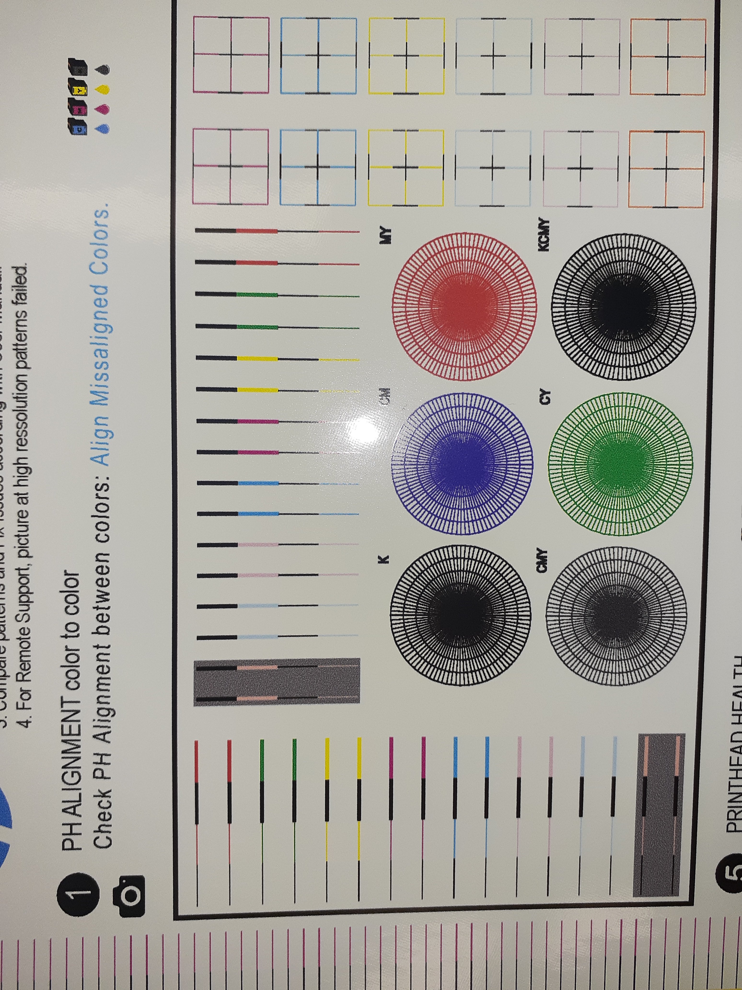

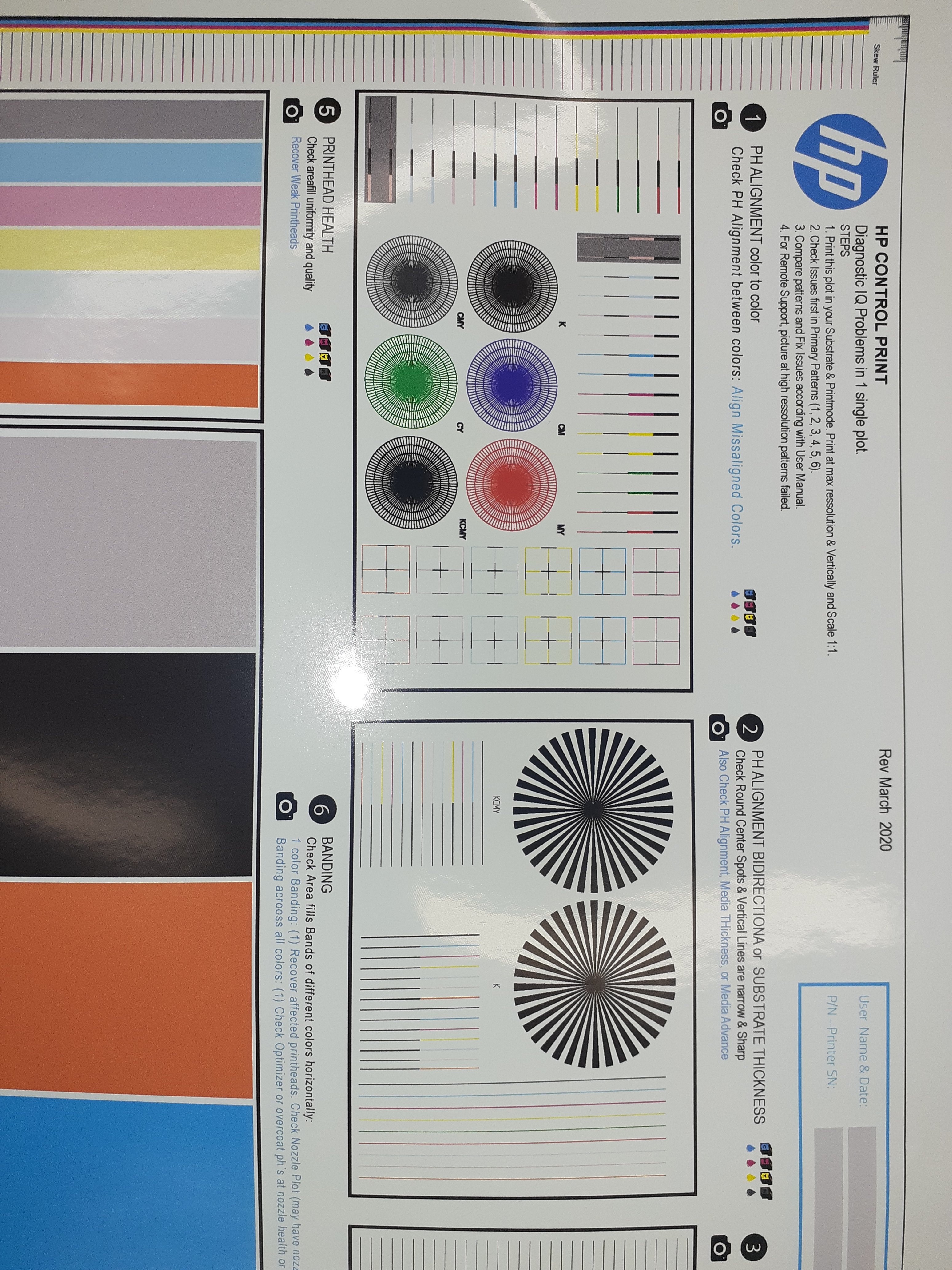

Okay, no real winner there or obvious issues.

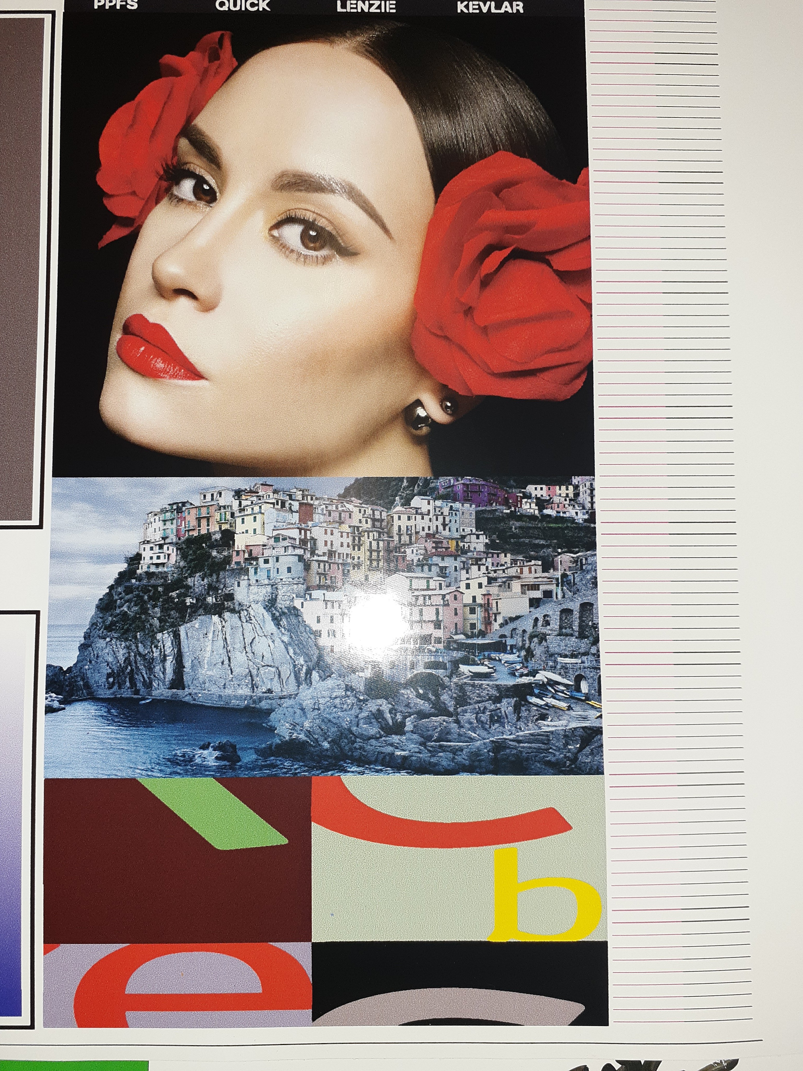

Could you print this and take a good picture of it?
It's an HP check plot made for issues like this. It should be printed 1:1.

Have to say I don't see any issues in that test plot. Other than the image (small town) being a little dull.
This would point us more towards your RIP having an colour management issue or the print profile broken somehow. But that is extremely rare that it would break like this and with two profiles.
