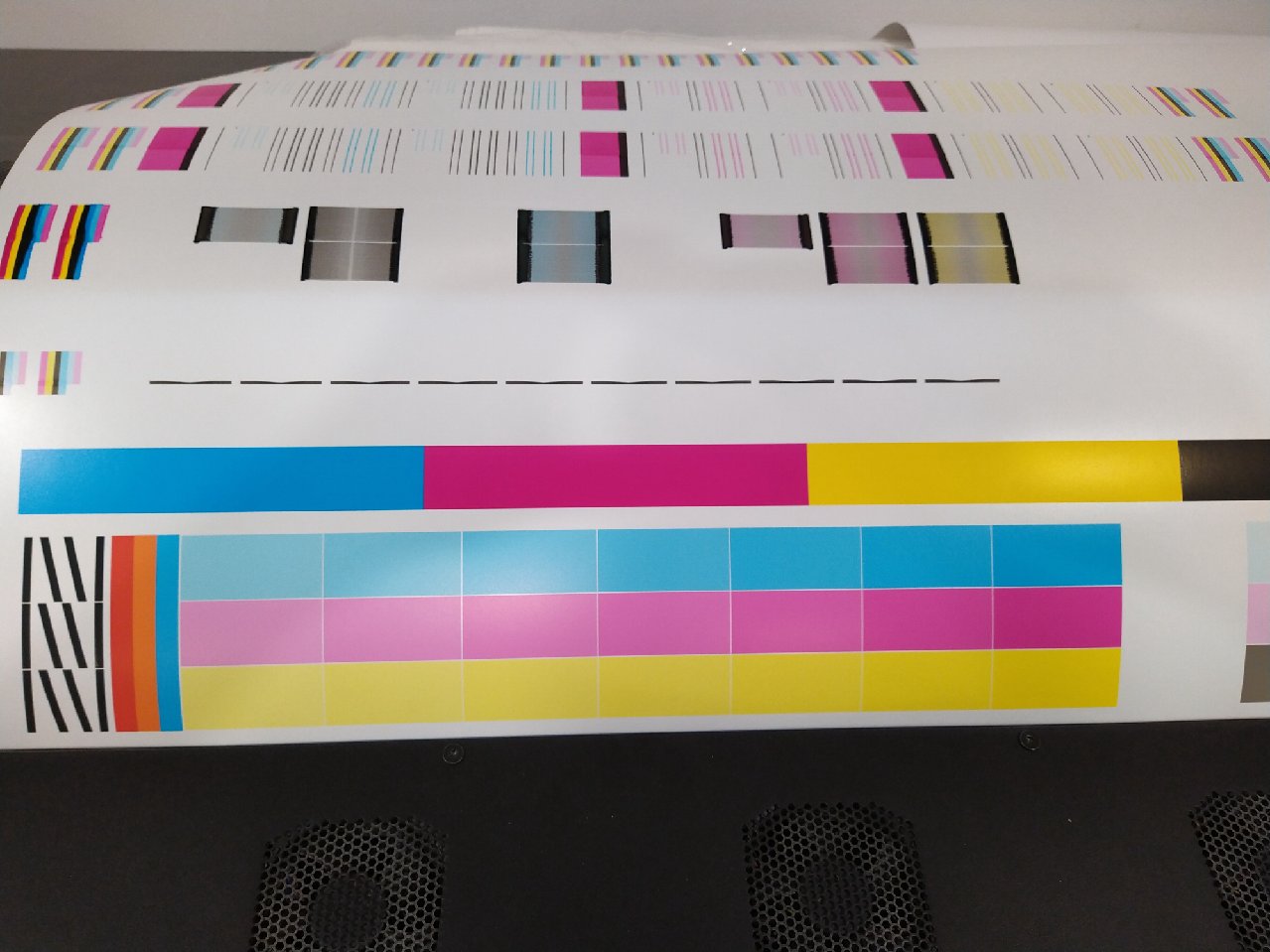

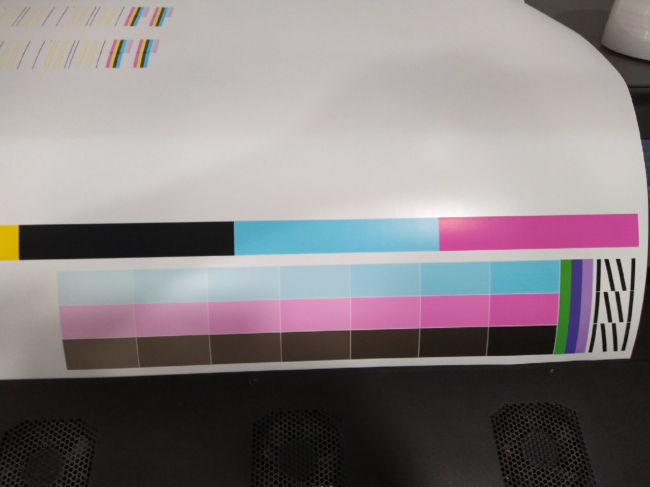

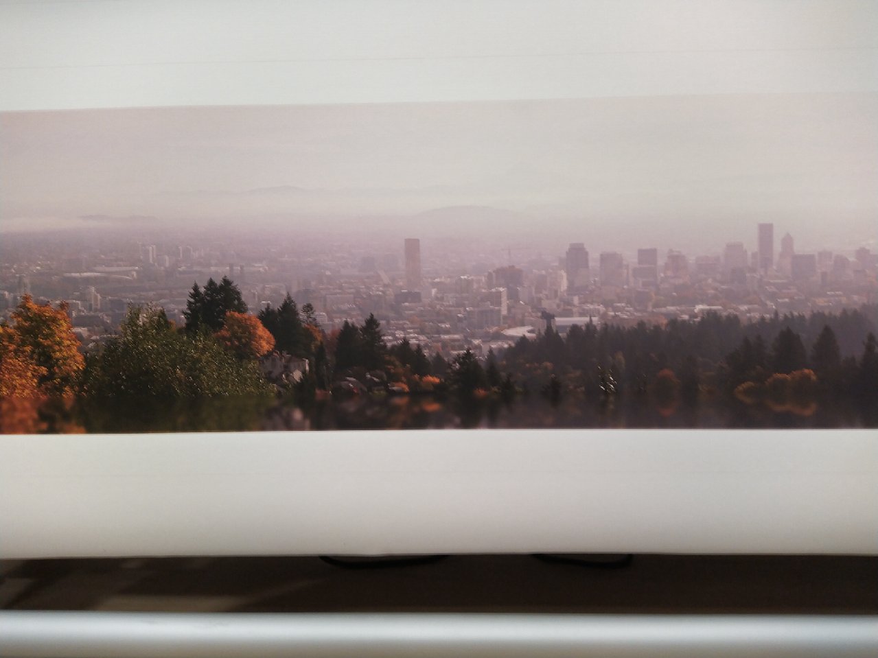

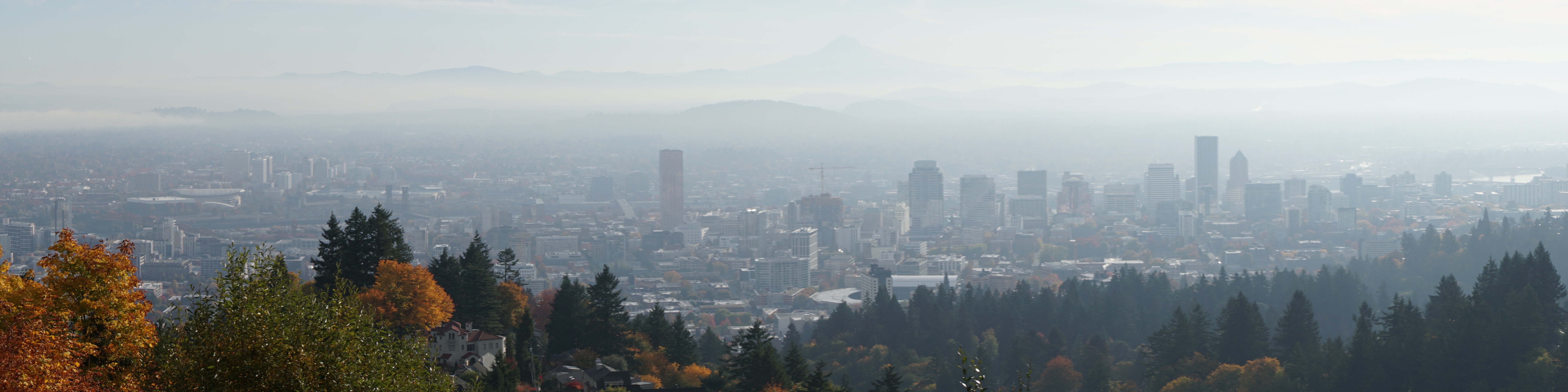

Today I came across the same problem with my HP 365. We printed a bunch of posters and canvas this week and everything has come out perfect. This afternoon I went to push through a canvas and the blue grey sky is now purpley rose. Some inks are fresh and some expired but when I did a series of test prints there does not seem to be an issue with clogs, etc. Thoughts?

Possibly it's the file and print settings?
JamesLam
Make sure that none of your inks are reporting as expired. Replacing just PHs will work for a short time as there is a reservoir in the PH, but if the inks in the system are pigment depleted, they need to be replaced with fresh ink - including the ink in the ink delivery system.
What does 'expired ink' really mean? Do the inks not flow properly, they don't interact with the optimizer as they should, the colours lose their oomph? Can anyone provide examples of what to look for when an ink has expired? Trying to resolve my issues I have completed a number of test outputs, checked print heads, etc and these all come back good to go. But I am left with the same results when back to real world prints.
JamesLam
To expand this further, can anyone provide examples of what defunct printheads do to the outputs in respect to colour. I've gone through a number of cleaners, alignments, etc. and the same pink in place of grey issue exists.
