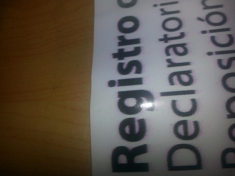

I am having a problem tetting my small print to print clean. I just moved into a larger warehouse with no heat and it hits about 30 overnight. This issue started last week.
Any suggestions or thoughts please. I have attached a pic

So a few things to try...
On the machine you can choose what type of material... try choosing 'banner'. This might help.
Also maybe look at unspooling the material a few feet at a time as it's running. The 8000's don't like heavy rolls (I've run into this with large banner and reflective rolls).
I know it sucks buy you also might want to looking at a different material. 3M has come out with a similar material 3MIJ180C-10LSE it's even has air release...
