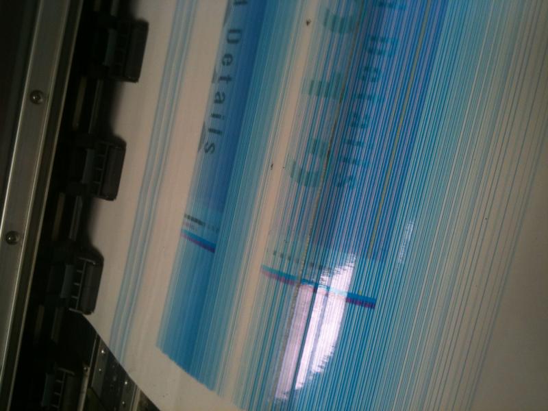

iSignDesigncom
cyan is pritning this now hp 8000s
I checked the damper and the 0 ring on the yellow that was printing in and out and when i put it back together the cyan started printing this.
Any solutions please?
Robert Mowad
720-365-1740 isigndesign@hotmail.com
J Hill Designs
My guess is you got some ink on the cyan print head cable. that looks like bad data to head. might try just reseating the head cable first (with power off of course)
