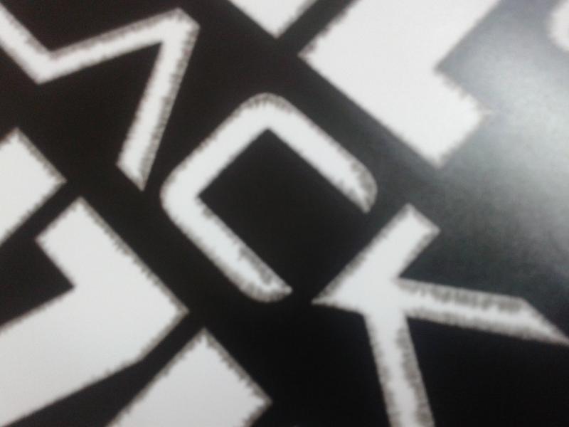

I tried black and yellow and had to change back because the black ink would bleed into other colors as well as the media. To me, it seems like the ink is watered down and doesn't hold it's shape before the heaters get to dry the ink. It only happens on certain media like HP's professional satin photo paper where it has a smooth surface. I just noticed it after printing a poster for a client where it has a black background with white letters.
I tired to contact STS directly but all I was told was that it was my rip or settings. I bought the original inkset and after a job or two to flush out the lines, the printing on photo paper was back to normal.
I am just going to stick to original ink because the quality is just better.
