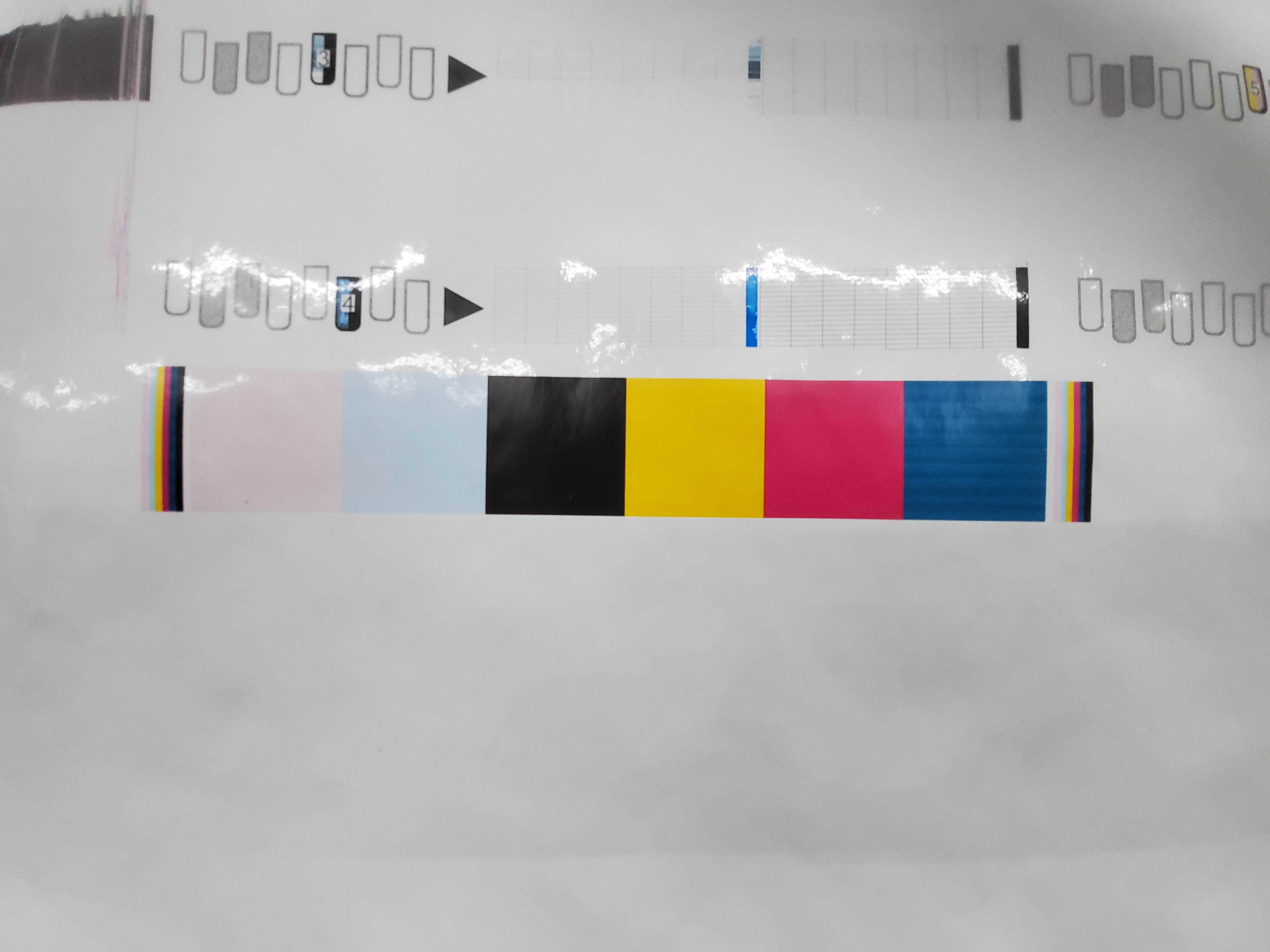

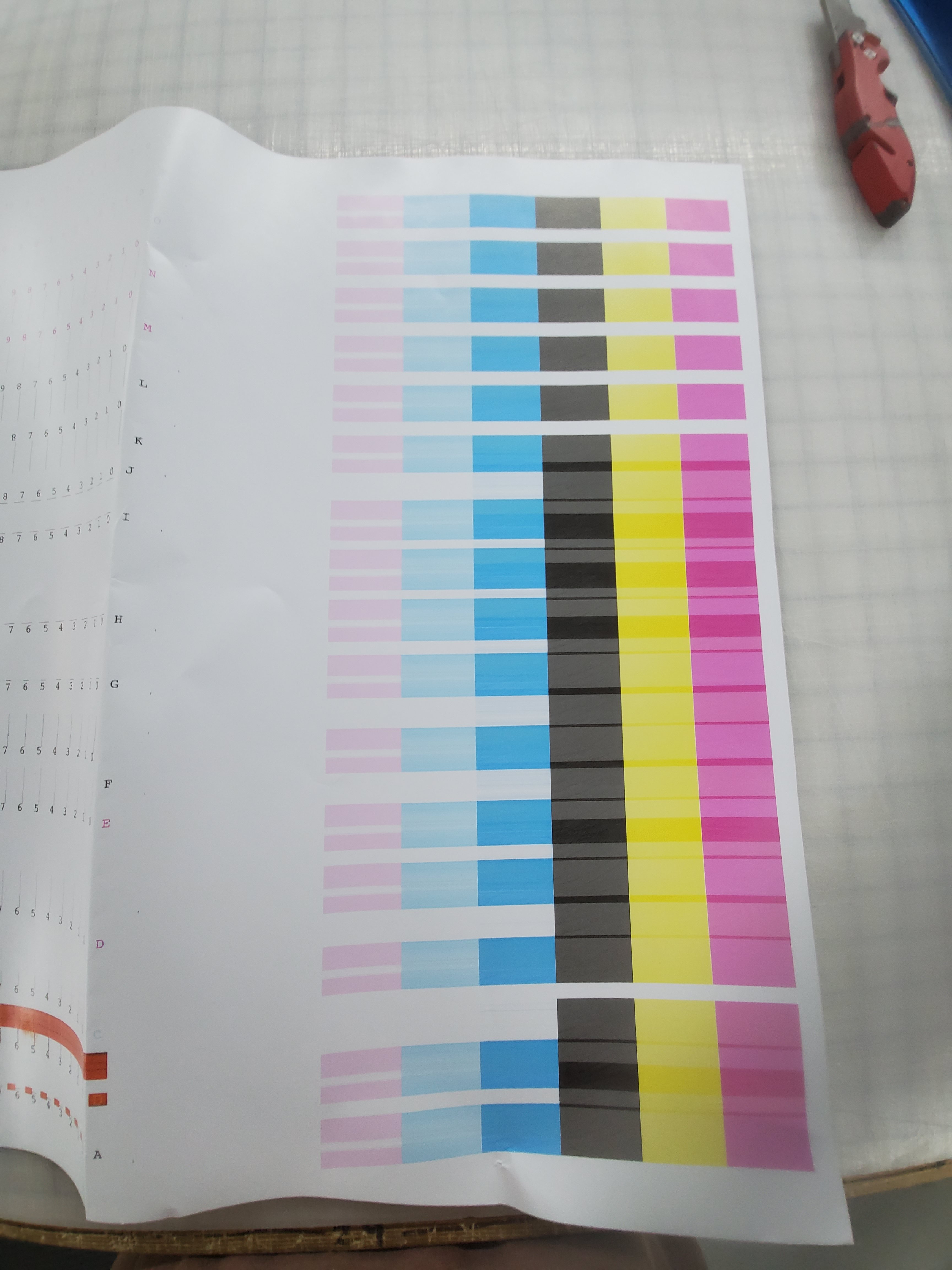

Not certain on this but I have two HP L360's. One uses STS and the other is running OEM. There are other differences like the STS one is well past in need of SMK#3 and eats PHs left and right. Rarely a strike issue, usually clogs in the head that no amount of printer or manual recovery can do.
Is this an ink issue, no idea, but I can't convince work to stop buying off brand ink. I am about 100mL of Magenta away from having to put STS ink in the other 360 and pray this is not the cause of the issues. I can not convince the uppers for maintenance or spending money on OEM ink. I am at the point of shoving the one into a corner and watching it burn.

That would be a lovely question to have answered. Gotta love manual calibration while having issues with printheads. Haha. And no, I can't use the auto. Recently changed majority of them within 2 weeks with zero head strikes here. The printer that gets headstrikes, which uses HP ink, rarely goes through PH.
