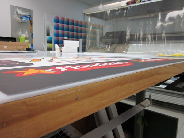

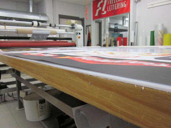

Attached are two images where I am trying to show the edge of the material and warping I mean. The right image (warped) shows the hp print, the left shows the flat mimaki print. Blacks are richer on the hp, and is the print we prefer.
When it's lit, you don't notice any waving in the film... but it kinda looks like ass unlit and would prefer not to send it out this way.

...in case anyone was following along. We resolved the backlit film wrinkle issue. We purchased and tried hp's backlit film. It is very similar, but the texture seems a bit rougher than the magiclee films.
It warped from the drying temps more than the magiclee, but was resolved by reducing heat. In fact, we went to the lowest temps possible in hp's profile. 104 deg, and 140 deg. ink dried fine, and no warpage.
Because both the magiclee and hp profiles were very similar in 'stock' temparatures, I am assuming similar results would be had with the magiclee film (reducing the heat alot), but we have not done fine tuning on that profile yet.
