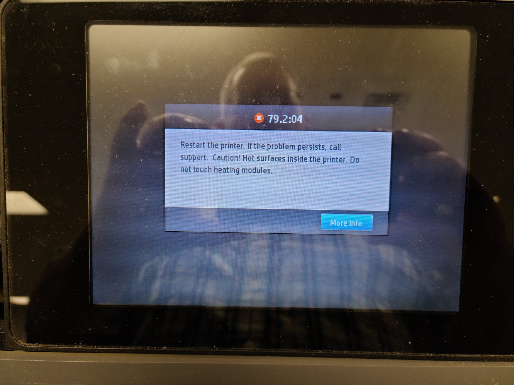

Weirdest thing! My HP L26500 JUST STARTED this problem.
We getting ready to print (only print fine otherwise) the printhead carrige flies over to home super fast. Code pops up 79:04.
Tried restarting as code suggests still continues to slam to the right to home.
Reinstalled Firmware still crashes.
Has anyone had this issue and how was it remedied?

Also once I got a code...
  • : 01.0:03
  • Description:Error impact I2C channel. There is an error with a board in the Electronics Module.
  • Remedy:• Switch the Power OFF from the back of the Printer and disconnect the Power cord. Reconnect the power cord and power On the Printer.• If the System Error continues, replace the Sausalito PCI PCA
