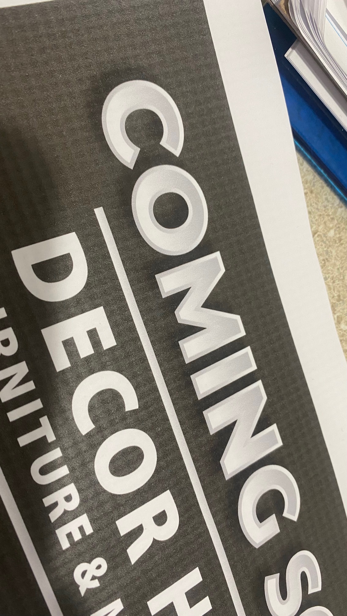

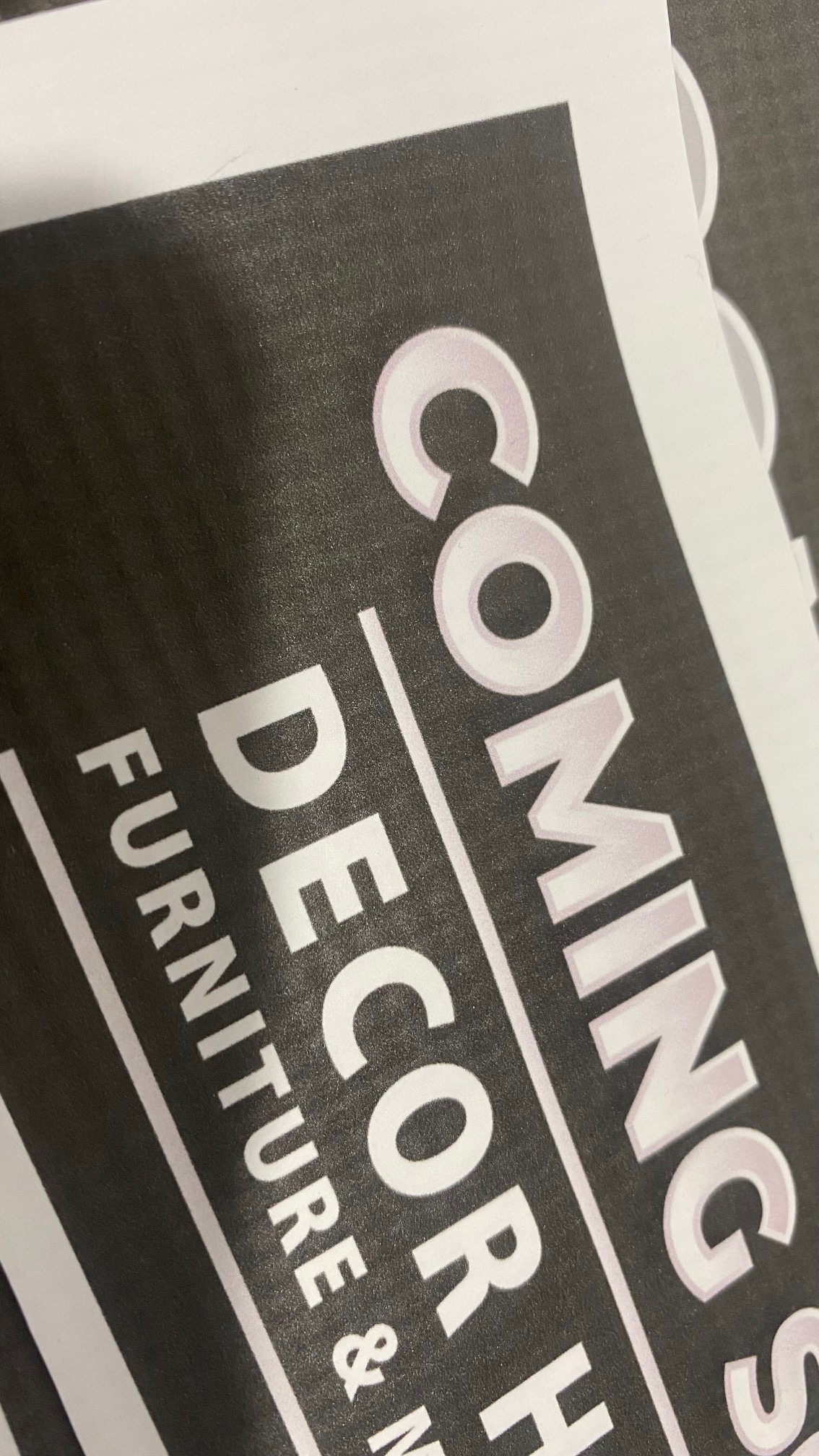

Having the same issue and I had started a new thread about this (didn't know this existed). Even with all the suggestions I too still have this issue. I have notices when I turn color correction off I get a print the way I expected.
I have no answer for this other than I turn color correction off. My new question, is printing with color correction off ok to do? If it is not why is there an option on or off?
The images I have uploaded Show color correction on I get Pink/ Purplish grays. Second picture shows nice gradient and also the drop shadow becomes visible, with correction off.
This is a small sample on banner material, this will also happen on every vinyl we use.
This color is NOT visible on pc screen it is only when printing at the printer.
