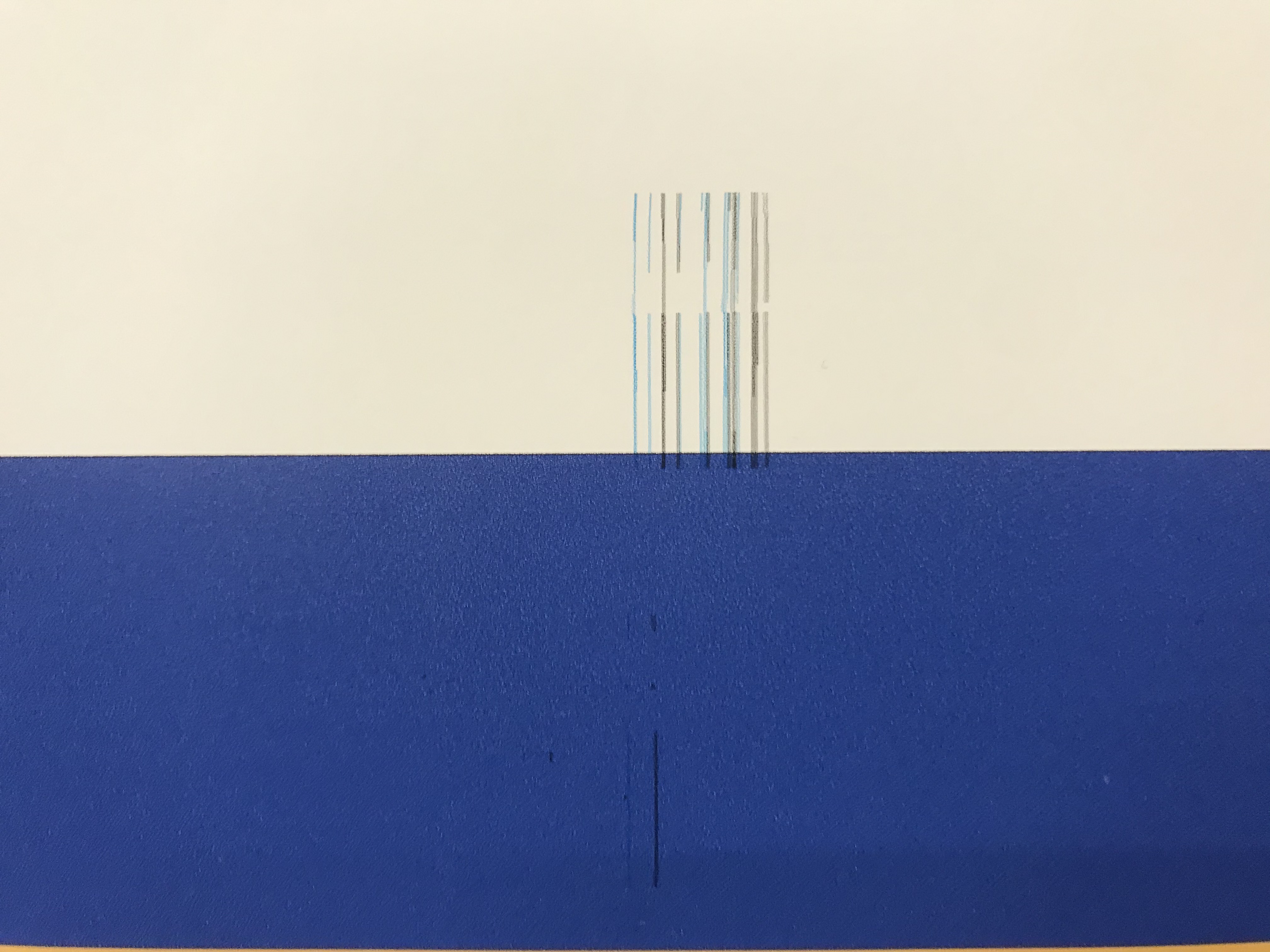

Need Help HP Latex 365 printing nozzle check pattern in middle of jobs

    Something is failing on you...PH is likely on its way out. Whats the warranty or maintenance status of your PH's?

    Both of the B/C heads are out of warranty. I'll replace those and see if it solves it.

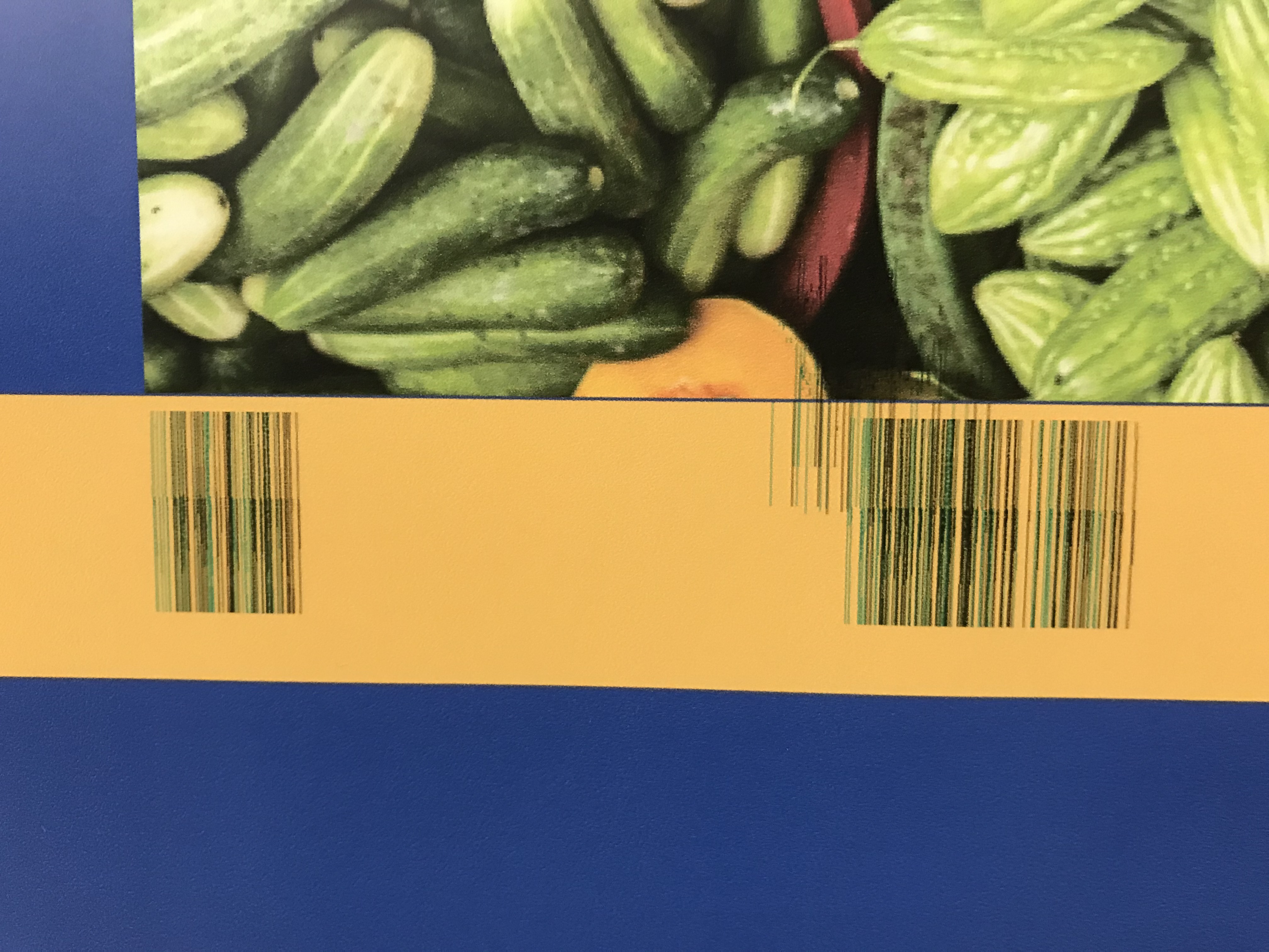

    I hope you're right. I spoke with a couple of techs and they said they had never seen it before and started talking about replacing one of the boards.
    That's why I came here. I figured someone on this forum would know.

    I have seen this pattern when the cables in the umbilical failed. If the heads don't fix the issue I would have it checked.

    Replaced print heads and still having the same problem.

    Then like Chris from GRS said.....umbilical cables possibly. PH's were first guess.

    First check the trailing cable/carriage data cable. You can check it without any disassembly, just open window and lower the tube pack down.
    If there is any cracking in the Rubber that is most likely your issue.
    You can get the cable for $150 and it's pretty easy to replace.

    I installing a new trailing cable yesterday.
    That was stressful!
    Everything seems to be working and printing as it should.
    Ordered the cable from Alinc Technologies, $143.00 with shipping.
    balstestrat wins the Golden Squeegee! (Thank you, Sir!)
