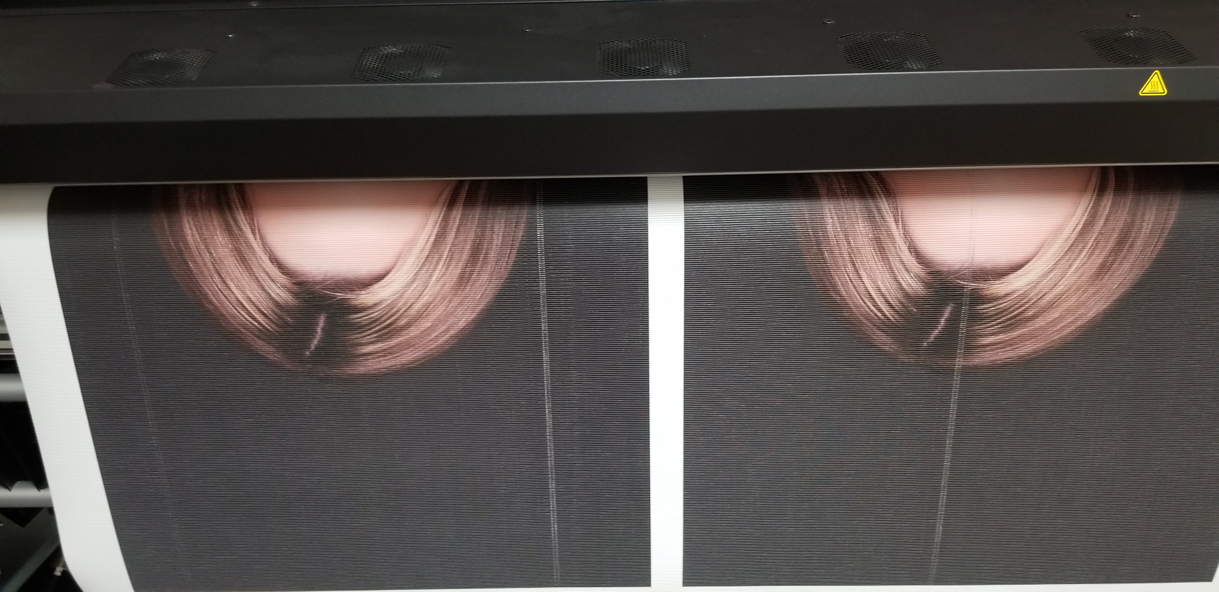

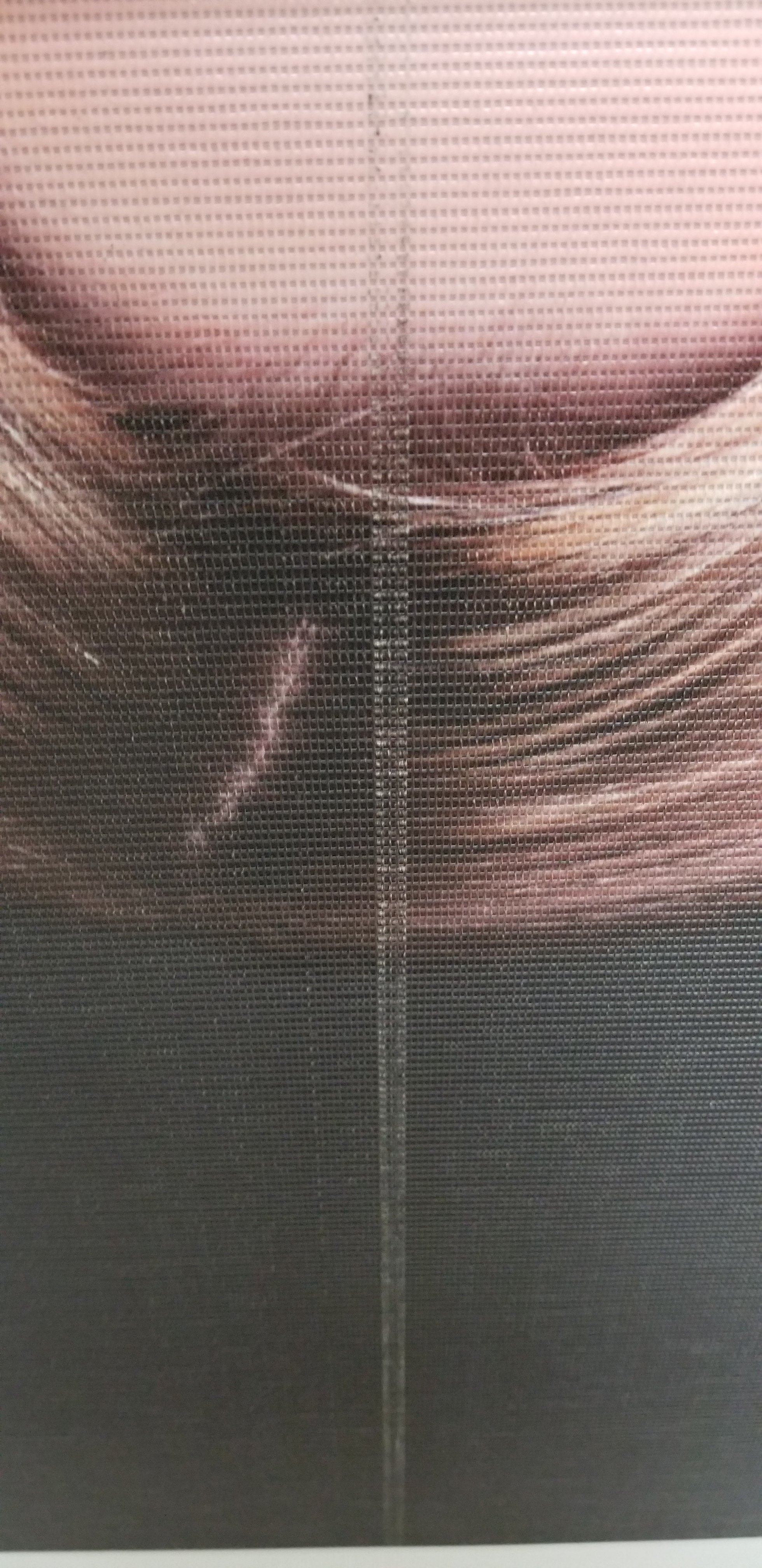

    Hi
    Today I was printing on Duratex Mesh Bannner with backing a print for a client and something went bad.
    I used the Generic Coated Textil profil and changed the heat to 241. What do you think is wrong? 20200109_153213.jpg 20200109_153224.jpg

    that almost looks like its hitting something in your curing tunnel. can you look up while its printing to verify?? also 241 seems very very high for heat imo. on my 560 im running it around 210 on 6pass.

    No Flyplainsdrifta it's not hitting the curing tunnel. But I did lower the heat and they turned out great so Thanks!

    Those lines are right where the dividers are inside the curing tunnel.
