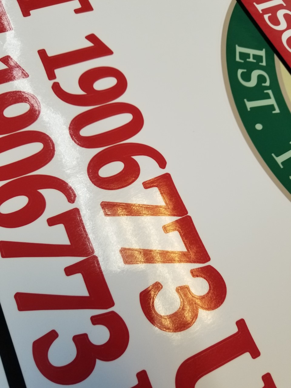

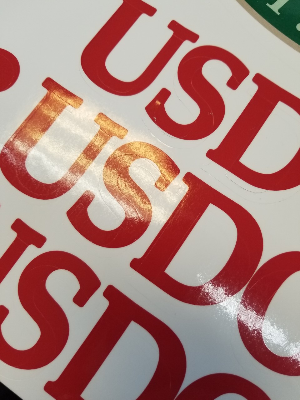

    I'm using HP Flexi Print & Cut 12 Build #2898 with a HP Latex 315 printer as well for what that's worth.
    So I'm having some pretty serious alignment issues when I go to cut some jobs. It doesn't seem to happen all the time but it's becoming more frequent.
    On the first image you can see that plot lines are really far off. In the second image you can see how it's supposed to be cut. The really surprising thing is these were cut on the exact same job! Everything was aligning fine and then it started plotting way off track. Then it started plotting fine again. All off of the exact same barcode on the exact same job. The vinyl was tracking fine in the plotter the entire time.
    In the third image you can see multiple attempts of me trying to plot this particular job. Those plots were supposed to be inside the diamond. One of those plots are from were I tried to scan the opposite side barcode.
    Like I said before this is something that can occur mid plot. On some jobs, it will plot the left (if you're looking straight at the front of the plotter) side of the job fine and gets misaligned on the right side. It did this exact same thing on one of the first jobs I ever plotted on this thing almost a year and a half ago.
    This has been a persistent problem but it has gotten much worse over the last week. I've wasted a considerable amount of my time and material trying to fix this. Any help you can offer will be greatly appreciated.

    Hi AJ,
    Sorry to hear about the difficulties with your HP/Summa cutter! I can only speak to the actual SummaCut Series cutters(which are similar but not the exact same as your HP cutter) but in this situation I would first want to determine if the software is causing the problem or if the hardware itself might be defective. With the SummaCut cutters you can use the included Winplot cutting software to run a few test jobs to see if you have the same accuracy issues that you are getting when using Flexi to output the jobs. If you have similar issues using Winplot that you have been getting outputting from Flexi then that would indicate an issue with the cutter itself.
    Here are some things I would try -
    • Factory reset your cutter to its original settings
    • Update your firmware to the latest revision
    • Perform an OPOS Calibration
    Once you have completed those I would try outputting a couple jobs using a different cutting program, like Winplot for example, and see if the random accuracy issues persist. If you don't have any issues using a different cutting program then you may need to contact Flexi to do some troubleshooting and see if maybe there is a bug fix they can install to fix the issue. If you end up having issues with accuracy using a different program then I would have a trained tech take a look at the cutter and see if any of the hardware components are defective.
