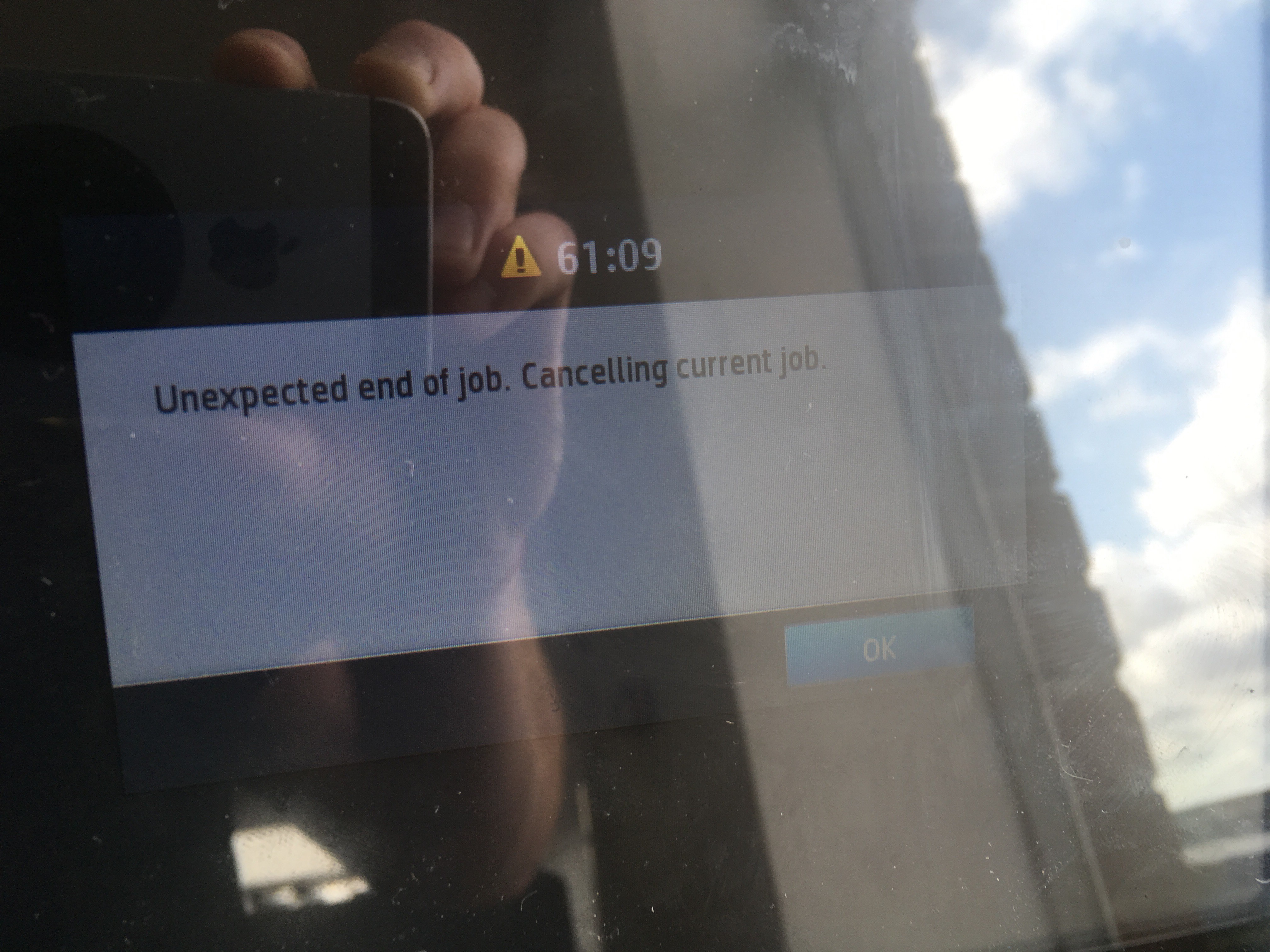

Hi all,
Recently I've been getting a 61:09 (Unexpected end of job. Cancelling current job) error pop up sporadically on our HP Latex 570.
It normally happens towards the end of a long print (2/3 metres+) and by sods law it normally happens when printing on our most expensive material.
We use Caldera and have recently updated it to the latest version (V12.1). We run our printers via our network using a CAT5e Ethernet cable and have been trying to solve the issue with the IT company we use and our tech guys from one of our suppliers.
We just don't know what the source of the problem is...
Everything has been trial and error so far, we had it stop on us again yesterday and after that we noticed a tick box on the printer settings in Caldera stating 'Enable Network latency tolerance'. It sounds promising but we wont know if that has worked until it stops on us again.
Anyone had similar problems or possibly know what could be causing it?
Thanks in advance!

I have been having the same issue with the 61:09 with a latex 315. It is definatly a network issue. I had another customer with the same error on a L360 and the issue was a combination of the router and his network provider.

Is your rip loaded on a laptop or desktop? What are the power settings? Make sure windows is set to never powers off.
if you just upgraded Caldera it’s possible that the printer requires an update that may or may not be available from HP yet. Double check that printer firmware is up to date.
When you load media, are you having the printer track length? If not, make sure you do going forward...might help alleviate the issue.

Cat5 vs 6 is not at issue here. If it was, you'd also have problems starting the print in the first place. More often than not, it's antivirus, computer going to sleep(or other components being allowed to power down due to running on a laptop in power saving mode), someone in the office pulling huge files off the rip over the network, even had an issue where it consistently appeared that spotify was hogging the bandwidth and it kicked the error.
Best bet, pull any RIP pc of the internet all together, unload antivirus, turn off all power saving features, then use it as a production machine instead of anything else.
Hopefully this issue was solved last year, I don't think he ever came back...
I had the sleep issue back when I was using the 26500, and it kicked out a code that started with a 6. High probability that is the issue here.

I have an HP315 and have been getting that error as well. It started about the time that I moved from my old location to a new one so I thought it had to do with the new internet service, etc. It does it in the middle of the day, at night, anytime it wants. What I have found is if I press the power off button (sleep mode) vs if the printer does it itself, it won't do it.

We are having the exact same issue on our exact model of HP Latex, the 570. Very random occurrence of a random network drop with error 61.09. Our network is as basic as possible, with everything feeding into a switch. The only "Cat 5e bottleneck" that we can think of is the ports in the wall that lead to the switch.
We suggested to the printer operator to try Geneva Olson's method of manual sleep to see if it eliminates the error. Will let everyone know the results.
