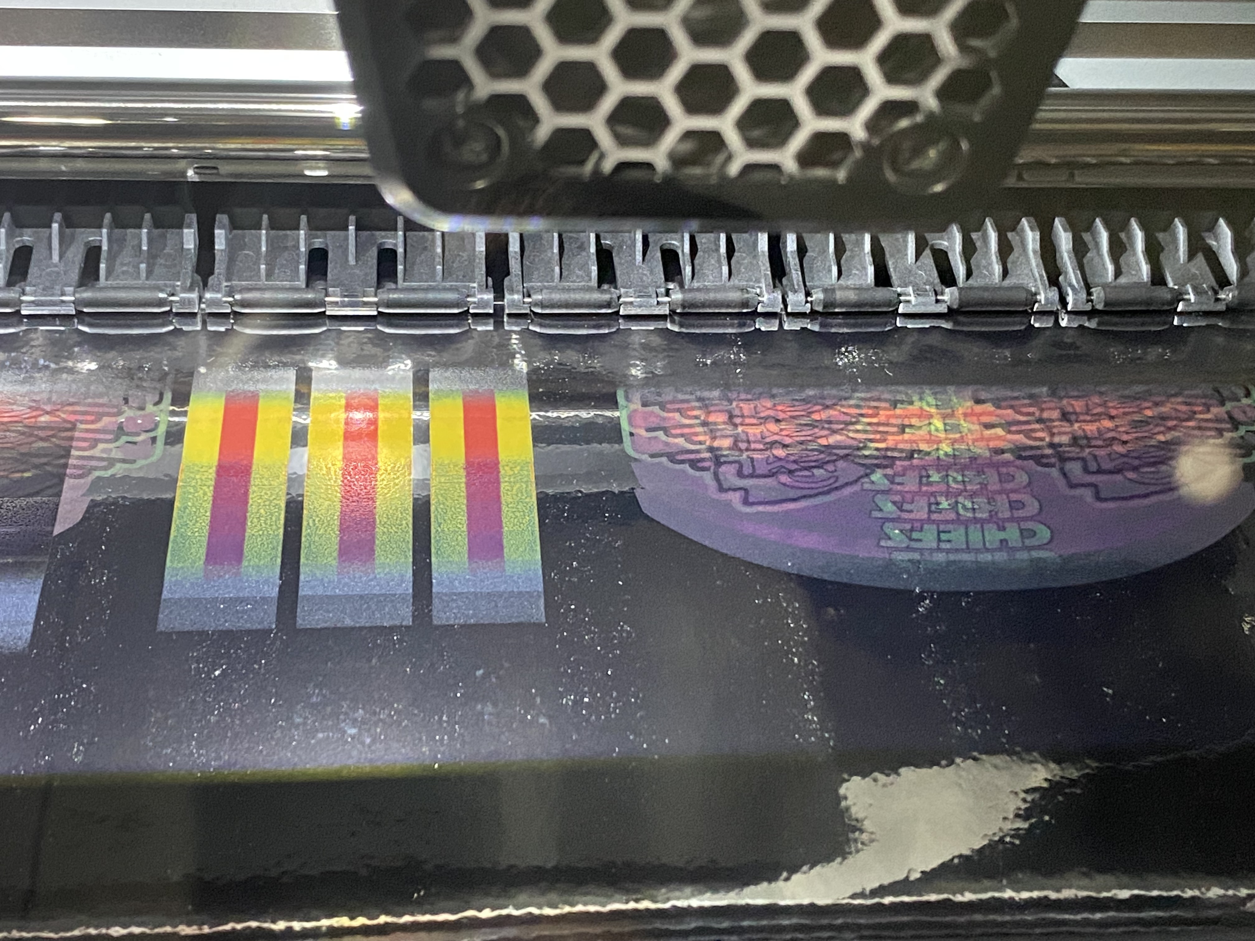

Im having problems with skipping on chrome and holographic vinyl now. Man everything was great until now :(
Not sure what you mean by 'skipping'. I have found that some metallic films can transport more reliably in both directions when attached to the Take-Up Reel. For example, Substance X1 Chrome film has a slippery backing liner and runs more reliably on the TUR.

Right, I tried it on the take up reel. Same results
artofacks1
Usual advice. OMAS off and manual advance calibration.
I turned Omas off and I did manual advance.
I had to move on to other projects but will trouble shoot during the weekend.

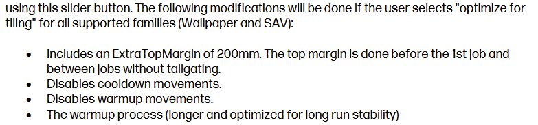

Actually now writing about this I just remember that the "tiling" option will disable that initial warm-up phase.
You should really try that with the clearview. Might solve the biggest issue.
