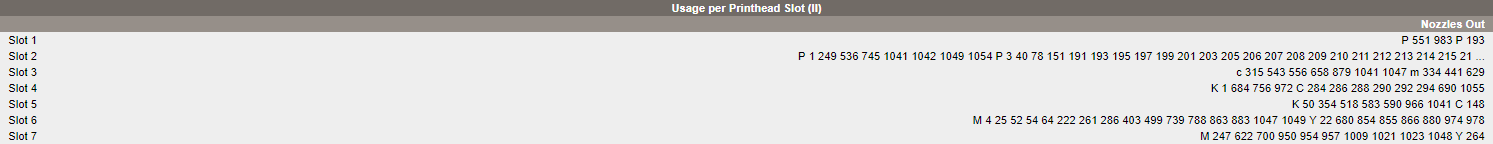

    I've been getting a bunch of "potential print quality" issues on our 560. I've ran nozzle prints and it seems to look fine - But now I've noticed there's specs of every color randomly misting in places. The optimizer does seem to have a lot of dropped nozzles on it. Never had a misting problem on Latex before... Everything else besides that head chart seems ok. The heads still under warranty... Its only got 115 ML fired through it, I just dont want to order a replacement and have it not fix the problem. The machien did have both Black / Cyan heads out on arrival... so I may have just got a bunch of damaged heads. Slot 6 looks like it's getting pretty high up there too.
    [​IMG]
    Anyways... any tips on checking optimizer? Should the optimizer plot be pure black? Both my plots seem to have a ton of lines in them... Slot 1 shows almost no missed nozzles though.

    I don't know of a solution for this other than changing the printhead. If its under warranty call HP and let them know and they will send you a new one. Sometimes I have even gotten them next day.

    Strange. Have you pulled out each head to make sure the strip at the bottom isn't damaged and hanging down? It can happen after a couple head strikes. It's possible that ink is firing onto it and dripping down as it passes over. If they look ok physically, I would switch the head. For us, HP has been great about replacing faulty consumables that are within warranty.

    I'll try pulling them when I get back to the office. There has been a few strikes... We just started printing on traffic vinyl and there was a bit of a learning curve finding the sweet spot between wasted media / media jams. That and the leader tape fall off once... Got a bunch of sticky residue on the bottom plate, so media keeps touching it... Sticking then curling.
    Nothing too major... And usually the jams are hitting the side and shouldn't be touching the heads... But you never know.
    Do you know if you can put a new head in to test... Then remove the new head if it's not the problem, without the head drying/ruining over time? Or is it once the heads in, it needs to stay in?

    Yes, I know they're cheap - One of the main reasons we got a latex. I've got a 110 at home, and I've had to switch it out once. They're like $130 here... which 1-2 jobs pays for, so it's not a big issue if they're bad. The problem is just knowing which is bad... Nozzle check seems ok on everything.. onlything I'm not sure about is optimizer. I have a really old chart where optomizer was solid black... Now I can see the little nozzle pattern in it. Going to print a plot at home to compare.
    I've had a few strikes... The 560 is a bit more tricky / different than the 110, so I'm ok with replacing the heads ourselves without even warrantying them, since I'm pretty sure any damage is our fault. It's more finding the culprit! I thought it was black / Cyan since its blue/black that seems to spray everywhere... But those were the 2 heads we got warrantied because they arrived DOA in our new printer. I don't want to call HP and tell them they're both bad again without even knowing :D
    Anyways, I'm going to print one on our 110, bring it in and compare. Then I'll remove every head and check for any physical damage.
    It was also suggested that random ink like that could be an issue with the maintenance station... So I'm going to remove and look at that too.
    Thanks for all the replies! I'll follow up once I finally nail down whats going on with it.

    Wagner private messaged me... A few others did too. HP sent me a new maintenance cartridge, no questions asked... Which turned out to be the problem, BTW. (Thanks Wagner for the suggestion!)
