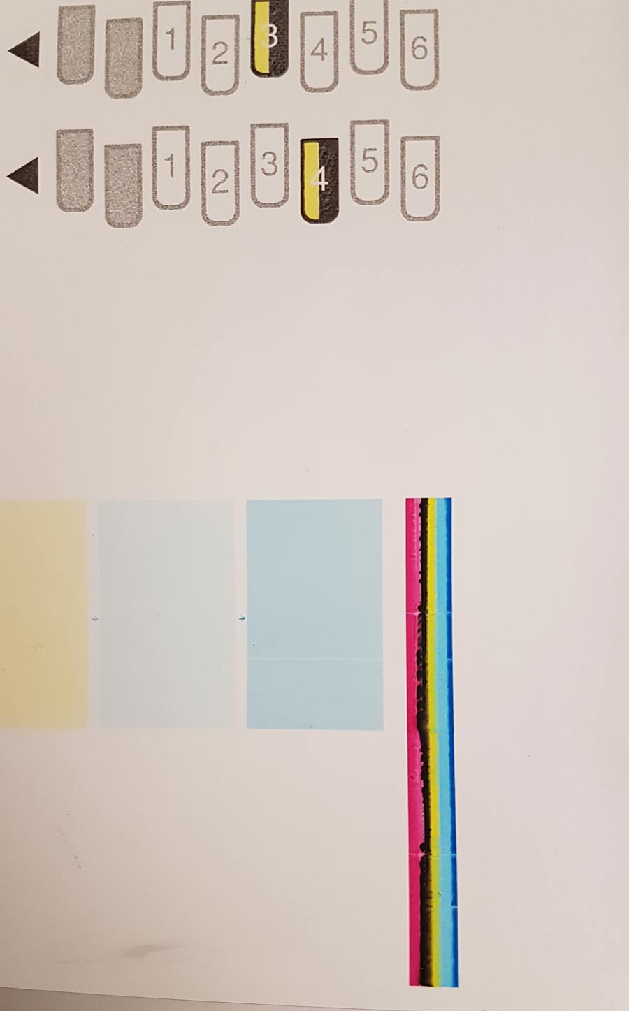

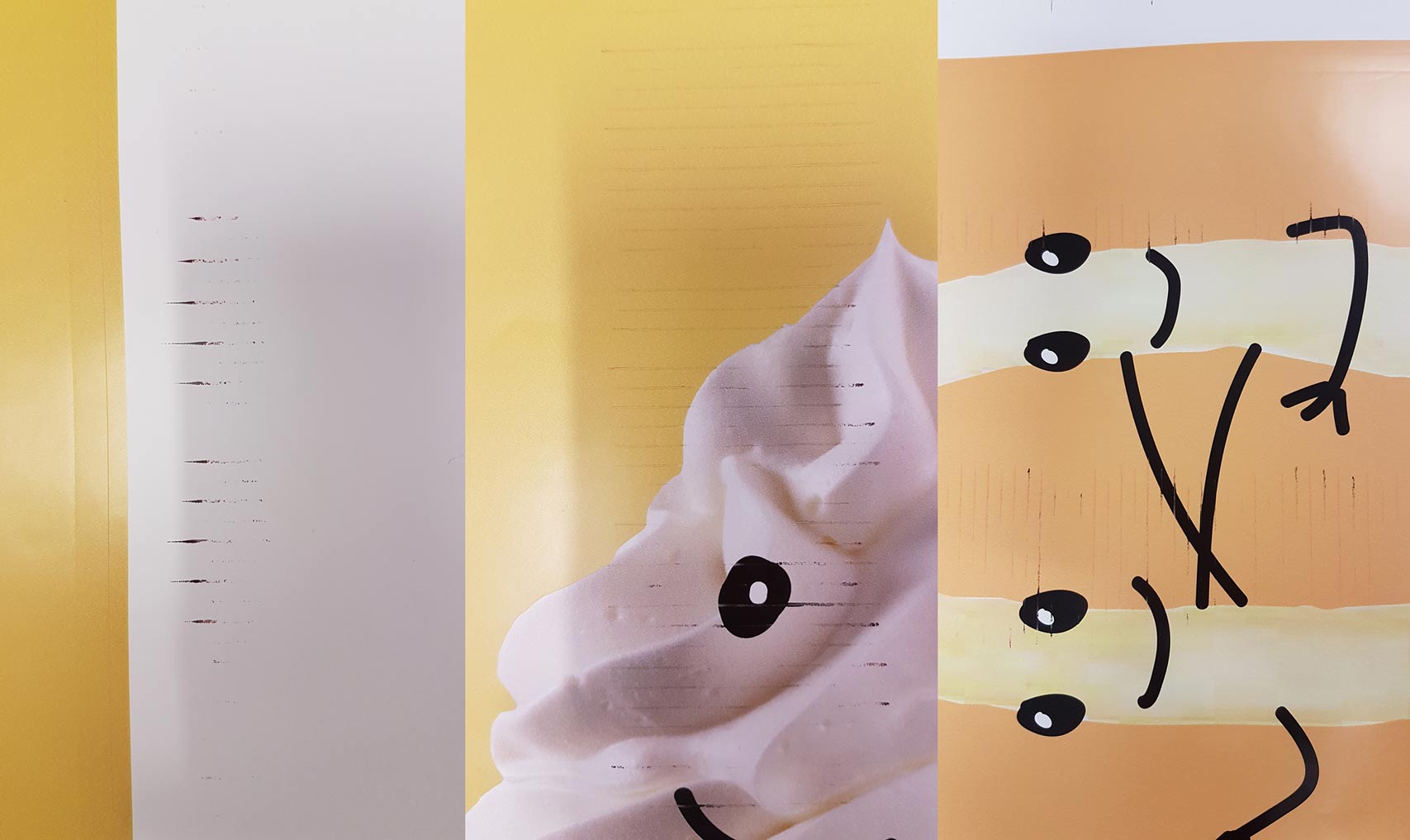

Could anyone point us in the right direction of solving this problem, we're all of a sudden getting these black streaks / streaks of colour not cured on our printouts (see image).
We've tried changing print-heads and the Ink Maintenance Kit so far but still getting bad results on the test print (see image), so assuming it's still going to print a job badly?
Thanks for your help!

Thanks, we had a look all looks fine, seems to glide along inside the printer fine too - reluctant to print anything else large as it's probably going to be wasted with a bad print again. Does the colours blending together in the test plot look correct to you, i'm assuming its not supposed to be like that?

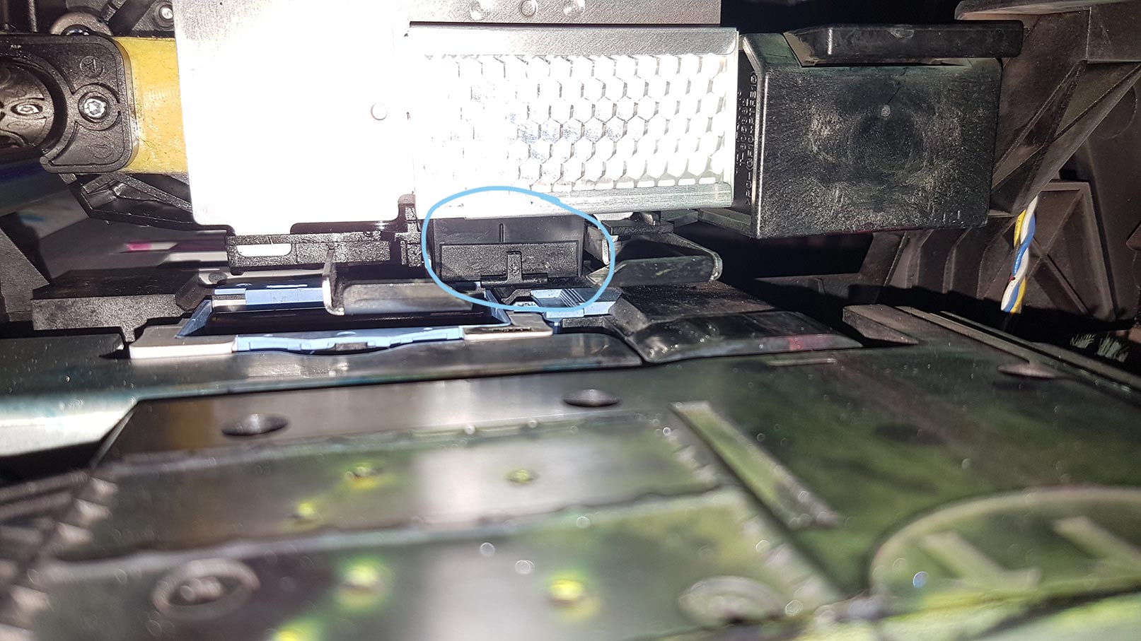

Thanks for the replies, it turned out this part has dropped out of whatever position it's supposed to be in, and was physically scraping the print before it was curing. Doing a quick fix as a test, holding it up off the bottom, resulted in non-streaky prints again.
