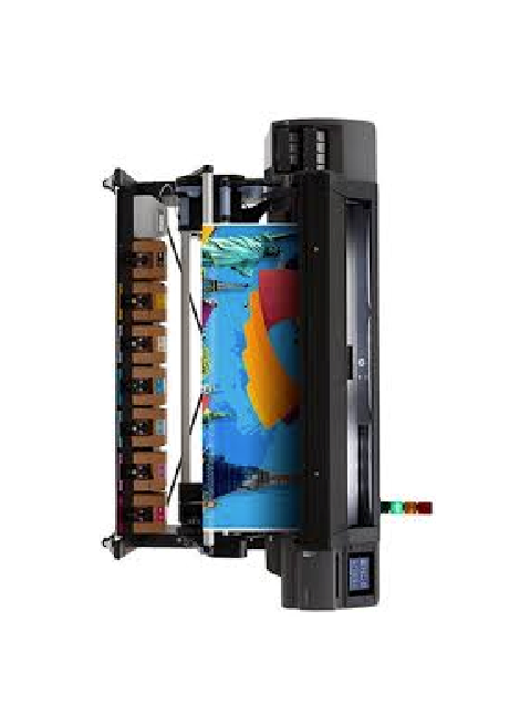

    Hello forum.
    Has anyone done that before?
    Can we put a printer upright?
    We are considering a new office and the freight elevator is too small. We are thinking about lifting the printer though an elevator shaft in an upright position.
    Thank you.

    Europe
    Which model? 570?
    I don't see any issue. Remove it from from the leg and secure the carriage better to its place.

    Thank you!
    I'm afraid that the plastic will crack under the machine's weight.

    If the elevator is just a little bit to small, you could win some centimeters by removing the left and right cover. Then it is mich easier too to save additional space when placing the printer diagonally.
    If trying to set the printer upright: shure that the lift is high enough. You need more than 2,5m.

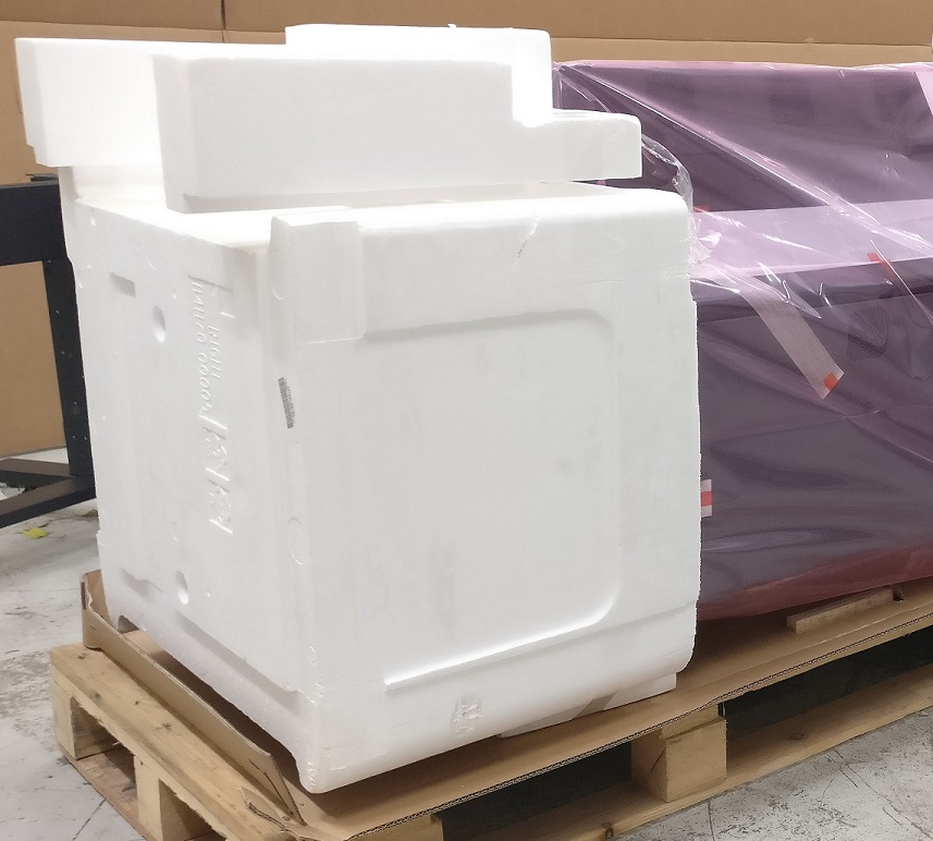

    The plastic on the left and right is quite sturdy. You can lift the damn thing from those and they will hold.
    Ask the guys you'r buying from to also take the styrofoams that go on to the left and right in the shipping box. Those will protect it better.

    take it in the way they move pianos
    i would assume the machine's frame was not designed to support it on end
    i would feel much better, if it were mine to have the weight evenly distributed across 3 heavy webbed straps

    Is the stairwell out of the question? How many floors up is it going? I know it's not ideal, but even taking the end covers off, there isn't anything to support the weight of the machine on the ends. Plus, on one side you have your service station/print carriage and the other your ink supply. I'd be very hesitant to tip it on the end. I used to work for a moving company, and we'd move all sorts of things up the stairs if we couldn't get it to fit in the elevator. Perhaps, there is a local moving company you could ask for a quote on moving it for you.
