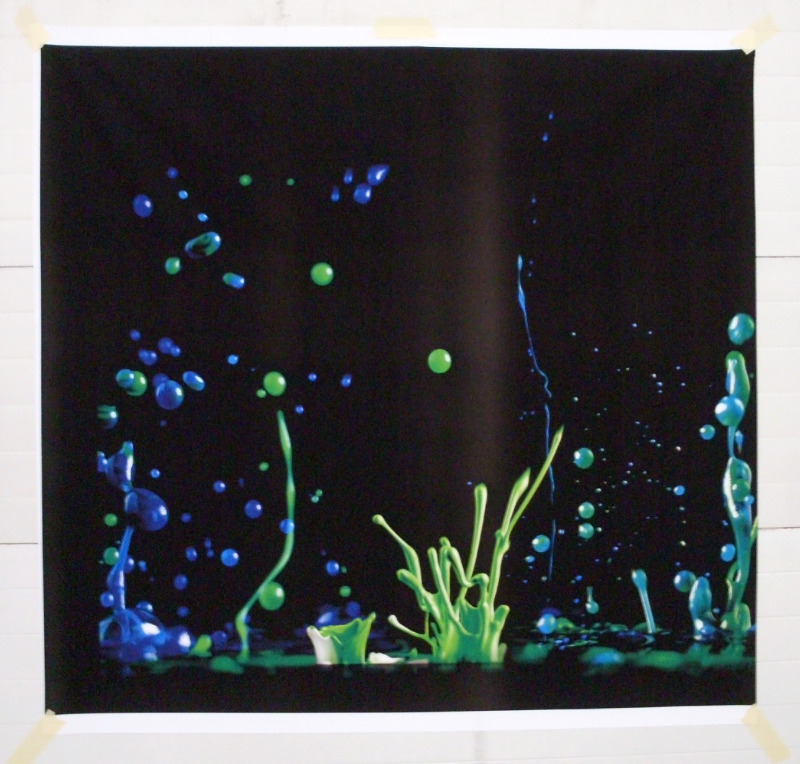

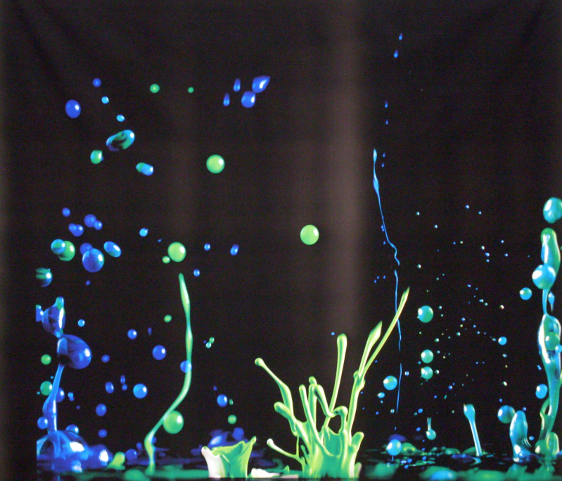

We've had our LX850 since last August and we primarily print Fisher Textiles GF4417 Soft Knit. Just printed a 33ft banner with a lot of black. Noticed about 3/4 through the black got lighter for about a foot and then back to normal again. This isn't the first time this has happened. HP can't explain it, I've learned their tech service is useless over the past year.
Any thoughts? Overheated printhead, ink delivery problem, PH?
sballinger
We print our fabric at 250% ink density, 18 pass uni, you can't get any higher on the LX850. We found this to be the best way to get dense blacks...to bad it decides to flake out. I should note it's horizontally faded, so it's in the path of the printheads

Ok, contacted HP, tech told me the 850 has a hard time producing solid colors on fabric (wish someone would have told us this before we dropped the $200k on the printer)
Regardless, no way to slow the carriage so I tried everything the tech and I could think of, I also have the service manual that the field technicians use on our computer, so after everything it looked like it was better and then back to square one. I've added some photos to show the problem. I'm out of options
