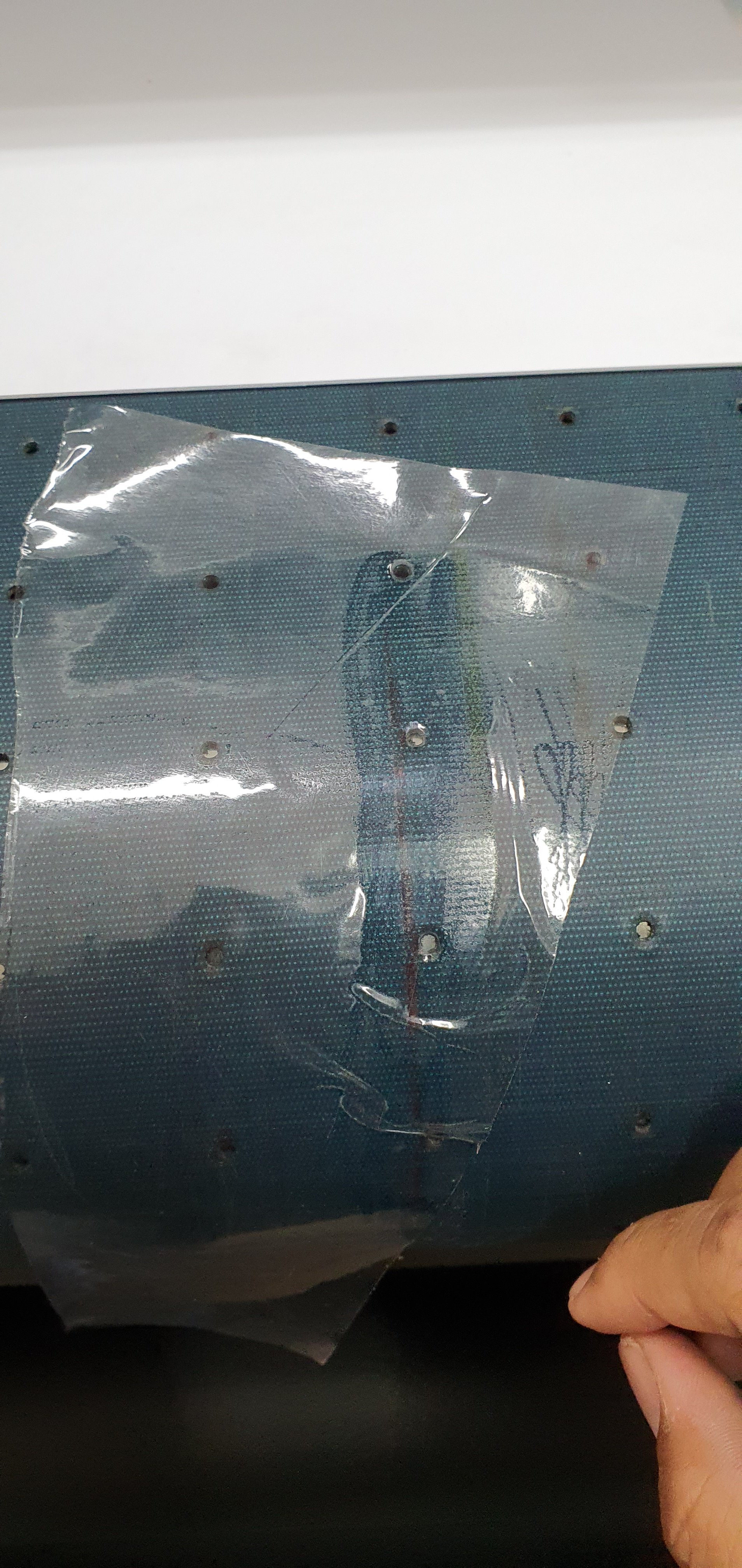

AndyT
we use 2 options for cleaning the belt. We first use vinyl sticker rest, just put some one the place is where the ink is on the belt. rub it and remove, after that we use alcohol. Sorry if my english is bad but i will add a picture about what i mean
