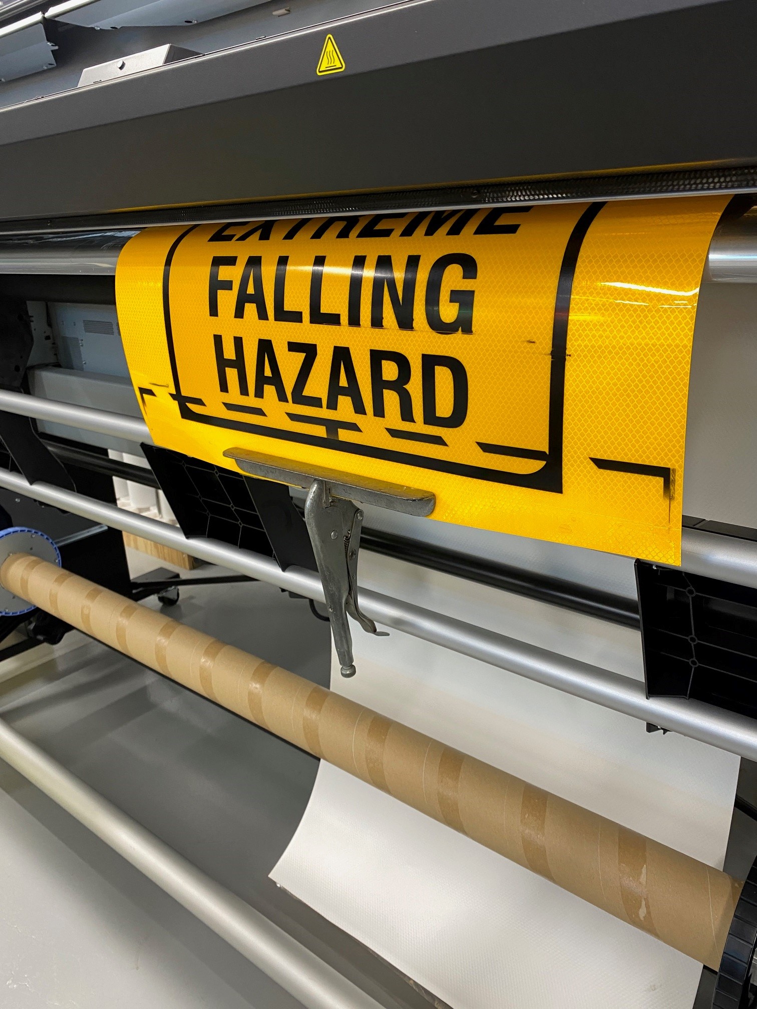

I find the outfeed table under the heater on the 3xx machines is too flat, and a lot of rigid materials curve and touch the heater. Using a leader and clipping a weight to it for the first few feet helps ( of course, this only works until the weight touches the floor!)
Yes, babysitting these printers is a way of life for shorter jobs or difficult media.
