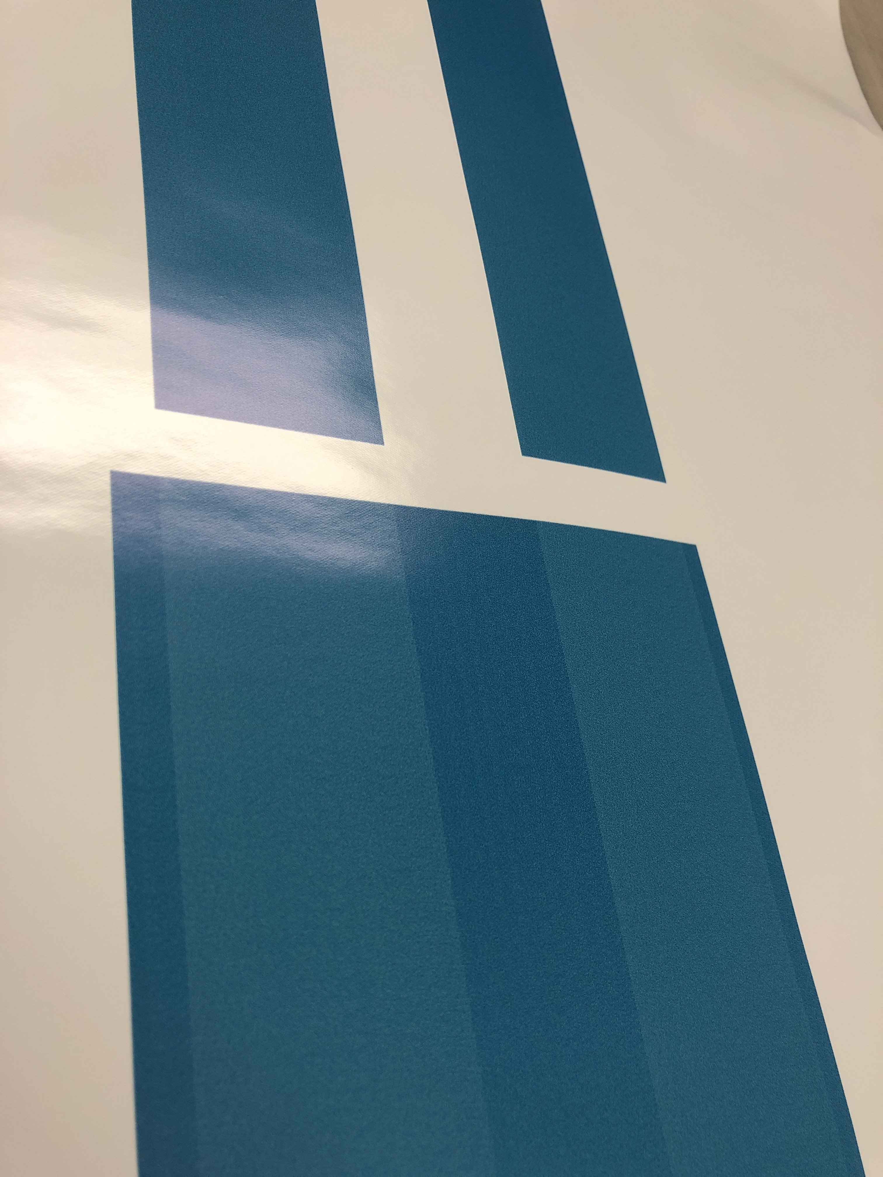

    I started having this issue suddenly about 2 weeks ago. It only happens when printing cyan. Has anyone seen this before and help me identify the problem? Thanks Printer Problem.JPG

    Print heads good? Ink carts not expired?

    New print heads. Ink cart new as well.

    I would check your drop detect sensor. Usually when you start having color issues like that and the P-heads are good along with fresh cartridges, that is your culprit.
