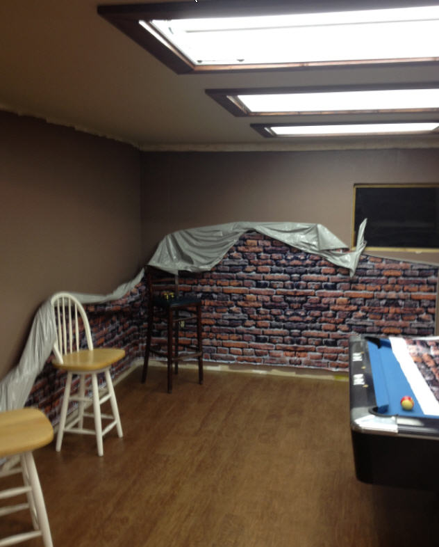

    Phototex is an excellent product. I just printed and installed two walls 7'h by about 30'w. I first attempted to install a 3M product that my supplier told me to use and was half the price. The next morning it was on the floor. Here's a pic of the crap stuff. Needless to say, I wanted to barf when I came into this.
    PhotoTex really holds on well and can be removed without harming the paint on the wall. Has a nice material like texture to it and it doesn't seem to stretch. You get what you pay for.
