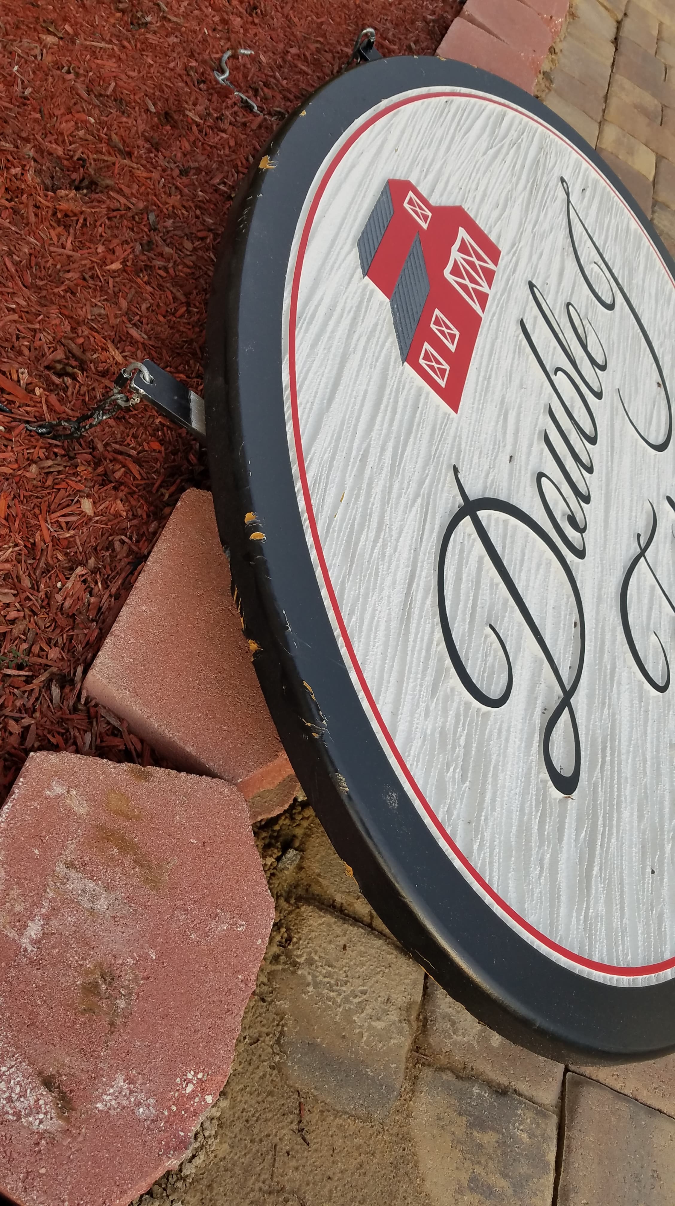

    I usually fill little dings, in new HDU signs I'm finishing, with Coastal Enterprises FSC88WB. But it doesn't "feather out" too well when fixing stuff sometimes and was thinking of trying something else.. I have an HDU sign I built just a few months ago and it was later beaten up pretty bad by the last hurricane. What do you use to fill/fix your HDU signs?

    rhonda sign.jpg Here's a photo of the damaged sign.
