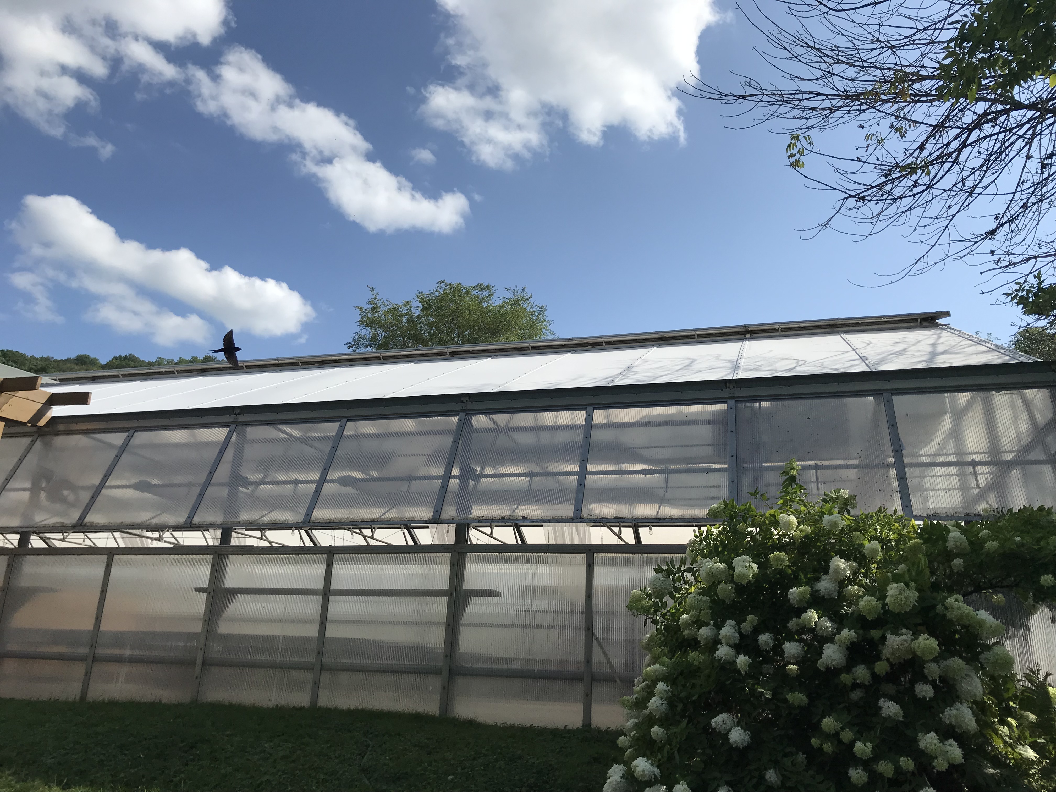

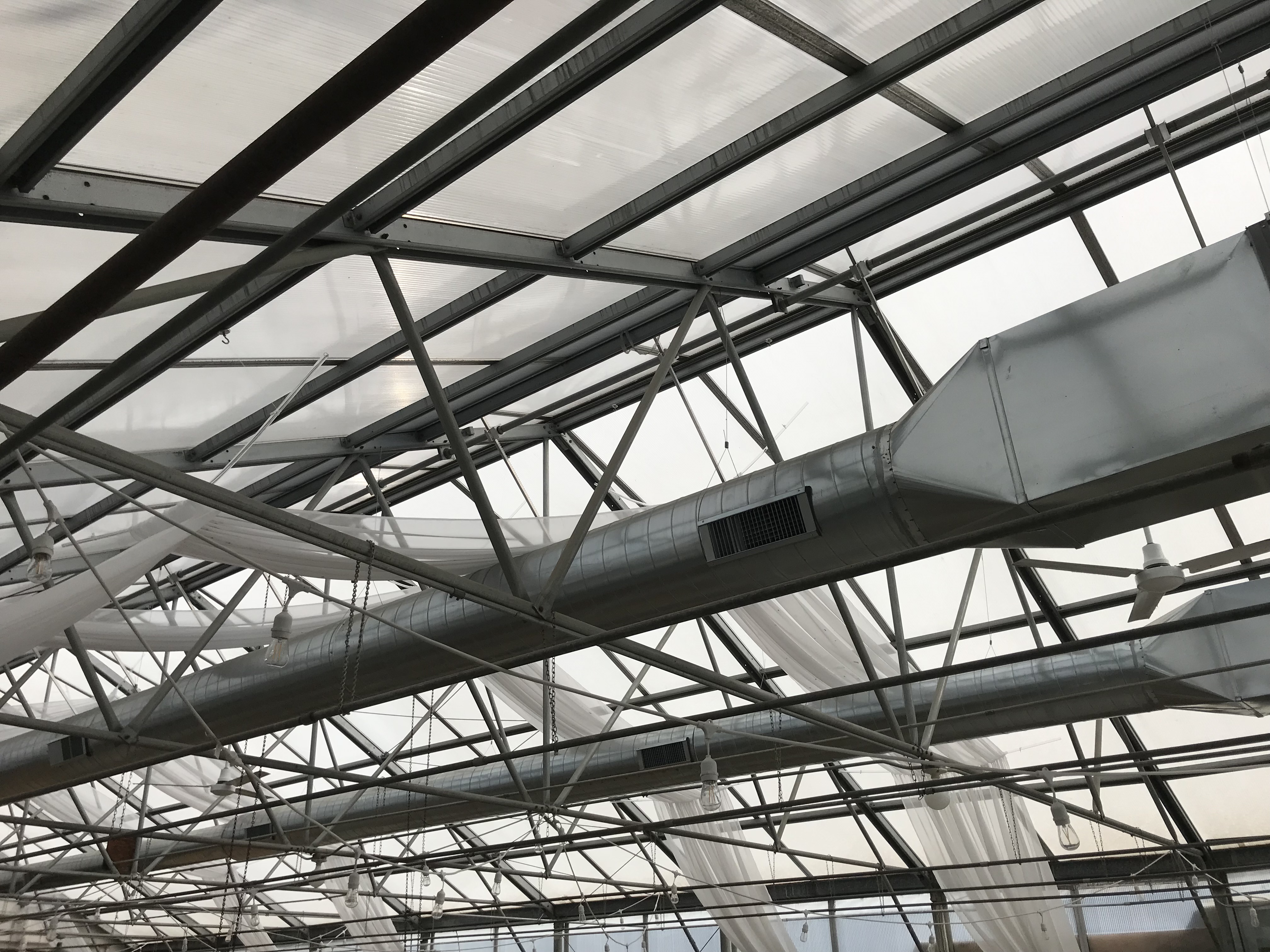

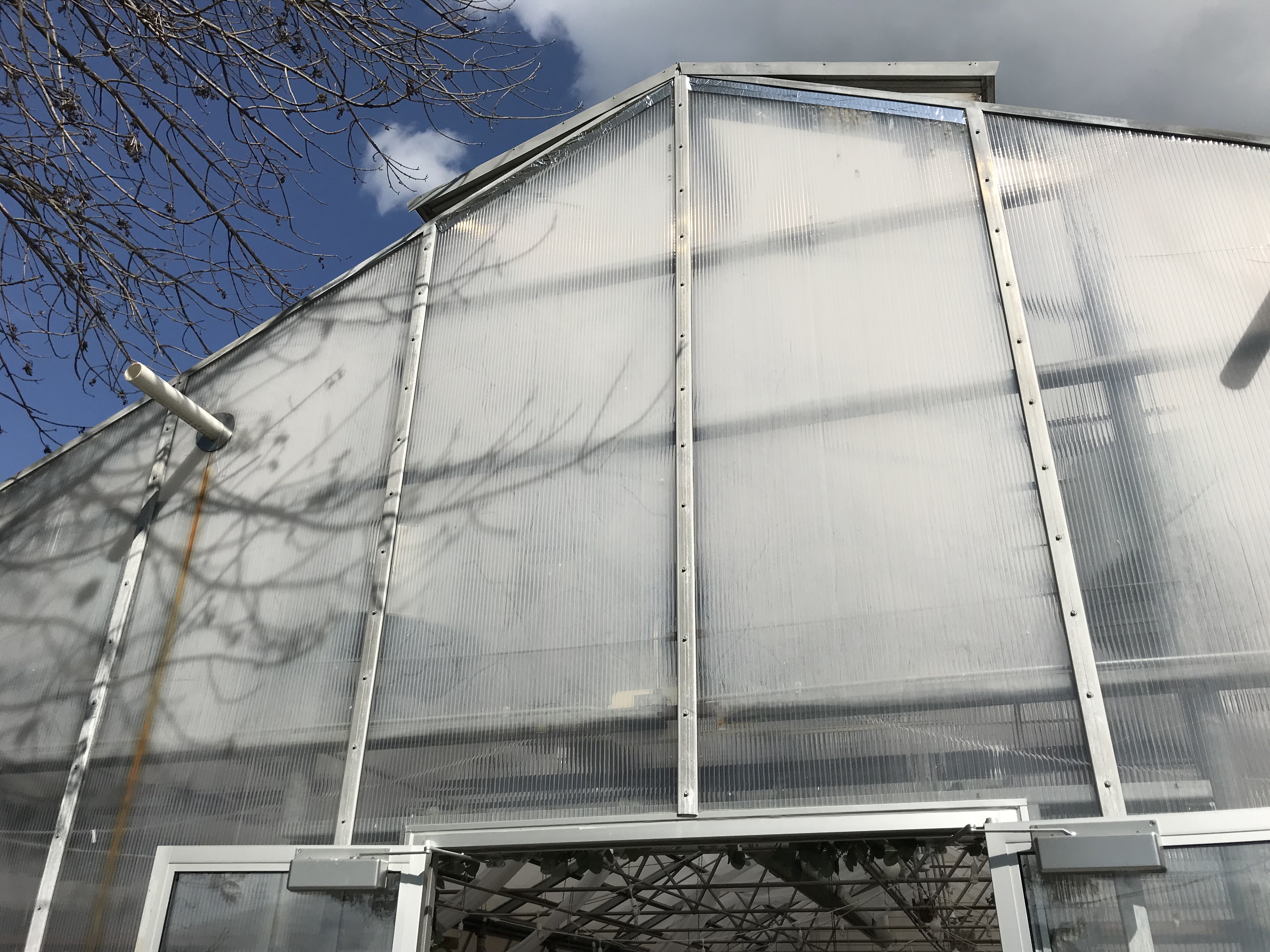

I have a customer that has a greenhouse. They turned or are turning it into a wedding venue. The problem they are having is sun is baking on the place they want to either put some sort of vinyl or tint to keep sun out. Would like white showing doesn't matter what faces the sun. Mounted inside probably. Only the roof part not sides. Its going on clear thick looking coroplast material. I even suggested maybe putting on a metal roof. They do use it beginning of summer and end for flowers still though.

Your idea might stop a little bit of sun heat from penetrating, but if you don't fill it full of air conditioners, no amount of vinyl or tinting will make it suitable for people all dressed up in tuxes and other hefty garb is gonna help. It's like an oven and the only thing that will prevent heat buildup, is to stop the sun from hitting that roof altogether. Build another roof and leave a buffer layer in-between.
Andy D
If it needs to be removable I would use banner material on top of the roof.
It would be easy enough to throw a monkey fist over the roofline & pull it into place.
Hard to tell how wide the roof is but it looks like two 15' - 20' wide banners
laced together in the middle and screwed around the outside would work.
You could even have a nice design printed on the bottom side.
WildWestDesigns
On our greenhouse, when certain conditions are met, the roof expands and opens up to release the pressure/heat build up inside. Can't really have anything that would prevent that from happening. This greenhouse may not have it, but that's something that I would also look at to make sure. We use a black netting stretched over the top. Allows the roof to expand when needed.
I personally wouldn't use a greenhouse for a formal venue like a wedding, but to each their own. Even with that netting, it's still hotter then blue blazes out there.
If they still use it as a greenhouse, have to try to do something that is temporary or at least movable as that would negate the benefits of a greenhouse by having a second roof etc.
equippaint
If the goal is to stop the heat, nothing besides insulation or an exterior roof as suggested will work. Even that may not work. The heat will transfer to the textile, banner or whatever else you hang up there
bannertime
That clear material is most definitely corrugated polycarbonate 10mm panels. You could go in and fit some 6-10mm white coro. The clear corrugated poly is pretty strong so you could probably fasten directly to it. If you needed it to be extra removable you could get some 10 or 12 ounce tent canvas and make a piece big enough to slide over the top of the roof. Either way nothing a typically sign shop would be doing.
Billct2
Commercial greenhouse handle this problem like Andy said Wildwest said, with fabric covering on the outside. Anything on the inside won't keep the heat out unless they make a permanent change to the panels and they don't want to do that.

Whatever solution make sure it meets all fire regulations. Many banner media’s don’t. Also vinyls have varying fire resistance. Could be an expensive mistake to make..,
That brings up a good question... Having a large event in that type of structure doesn't seem like it would meet codes...
Not that I would turn down the job, it wouldn't be my problem, just wondering.
Evan Gillette
I agree with the others and suggest a hard pass on this one.
Whoever thought it was a good idea to turn a greenhouse into a wedding venue "as is" and then hire someone to make the structure do the exact opposite of its design and purpose isn't a logical person. They are also likely not going to be happy with the mediocre at best results, and will likely try to make it your problem. As also mentioned, I highly doubt that the structure is within code for hosting any kind of events, even after heavy modifications.
As intriguing as the opportunity is, I don't think I would touch it with a 10' pole, even if the proprietors "seem" to have deep pockets...
Edit: As Jburton mentioned, greenhouse manufacturers make "shade cloths" to reduce interior temperatures in very hot weather, but keep in mind this is to prevent interior temps from reaching into the mid 100s. They will have little effect for the "comfortable" temperatures your client is looking for. Airflow and swamp cooler style AC units would be their only real options in my opinion.
