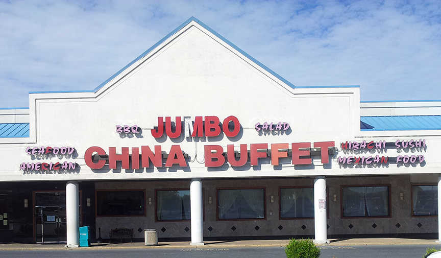

    In the picture below, the large letters are 48" tall with about a 14" stroke. The smaller letters are 15", maybe 16" tall. Didn't get a good read on it.
    We're supposed to remove everything and put CHINA BUFFET back up with a 3' x 12' box sign above it where JUMBO now is. All LED. The smaller copy is not going back up at all. Everything is on a raceway (except the box sign).
    Here is my question........ in anyone's professional opinion, can this all be removed, new put back up along with all the wall patchwork for under 10k ??

    Here in AZ, I would say yes! In your market, I wouldn't have a clue.

    I wouldn't think so. Unless the China Buffet can stay where it is, add the new sign above and remove the rest.
    And does patching mean just filling/blocking the holes? Because the wall is gonna look like crap without a full repaint.

    All new letters for CHINA BUFFET and a new 3' x 12' box sign. They want to put a picture in there. In addition, the wall is failing around the CHI in existing sign. It's about 4" lower as the bolts have broken loose. I'd be responsible for patching all the holes that remain with as close a color as I could muster up. It will look like sh!t when finished. Hopefully the mall will have it repainted, but not by me. Don't do walls, not a house painter.

    With that information, I would say no then as that has beyond normal touch-up or repairs.

    I'd call my favorite painter and start with a quote to patch and paint the whole wall. If he will do it for 2k, then it looks like you may eek out the cabinet and reinstallation. Odds are at least one face off of the existing sign will break during the process, so figure that into cost as well.
    I find painters quote stuff way under what I'd figure on my guys doing it for, and I hardly ever have them come back on a bid to say they needed more paint or anything of the sort.

    With that info- no way.

    Not sure, but evidently, I'm not making myself clear.
    The two words CHINA BUFFET are ALL new faces, new LEDs, new jewelite, new 5" returns, new backs, new raceways and all new wiring. All the old stuff comes down and thrown away. All of it. A completely new 3' x 12' box sign with LEDs will go above where the word JUMBO is presently. All holes are filled and painted. The aesthetics of the wall is none of my concern. That is an owner's responsibility.​

    Oh, doubtful. If it were a new building, maybe, but factoring in everything on top of that, doubtful. I had imagined that china buffet would stay as is, except resecured since you'd mentioned the failed mounting.
    Even if I wasn't replacing the cans, just re facing and new leds, I can make new sets faster than redressing old sets, especially as blocky as this font is.
    Who put the 10k limit on the project?

    A company which quoted $9,000 to do everything. I was almost double that. I couldn't believe my eyes when he wrote me telling me the other price. I could see I could be off and maybe someone do it for 13k or 14k, you know, someone that really needed cigarette money, but 9k...... it's gotta be a pack of rats flying under the radar.
    There's no way this is gonna be up to code or using good LEDs and other components..... not for 9k.​

    Probably junk components, no warranty.
    I'd wager it's a guy with a pair of bucket trucks, ordering in signs from a wholesaler for 4-5k, figuring on leaving signs in dumpster around back, not even rebuilding any letters. Probably unlicensed, and it will go up overnight without a permit. IDK about your area but it's about right for mine.
    You could always push the parts/labor warranty, but more often than not at that difference, the customer won't care.

    We would be around 15k for that work. This does not include any repair work to wall. I would offer the wall repair as an upgrade option & outsource it.
