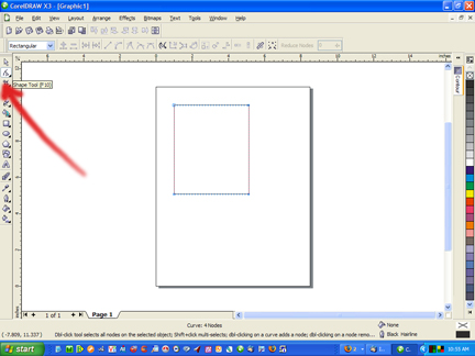

    What is the node tool? I don't see it in Corel X3.
  11. Shovelhead
    Shovelhead Major Contributor
    10,882
    16
    Dec 5, 2003
    Right....
    there.

    I know...I am an Illustrator guy. But when I use this tool I can't marquee the image. ???? I am an idiot I guess.
  14. Shovelhead
    10,882
    16
    Dec 5, 2003
    Select your nodes...........
    and right click for node options.
    Whatsamadda witch you's Illustrator guys?
    If you can't select, your graphic needs to be ungrouped.

    Select it image, select the node tool and all the nodes will appear. With the node tool .... marque select the nodes and they will turn blue. then mess with the slider bar.......nodes reduced. Or select node tool, click on the image and delete one node at a time. Fred posted a great link the other day about Corel training videos online at Corel Unleashed. Search for the link.
