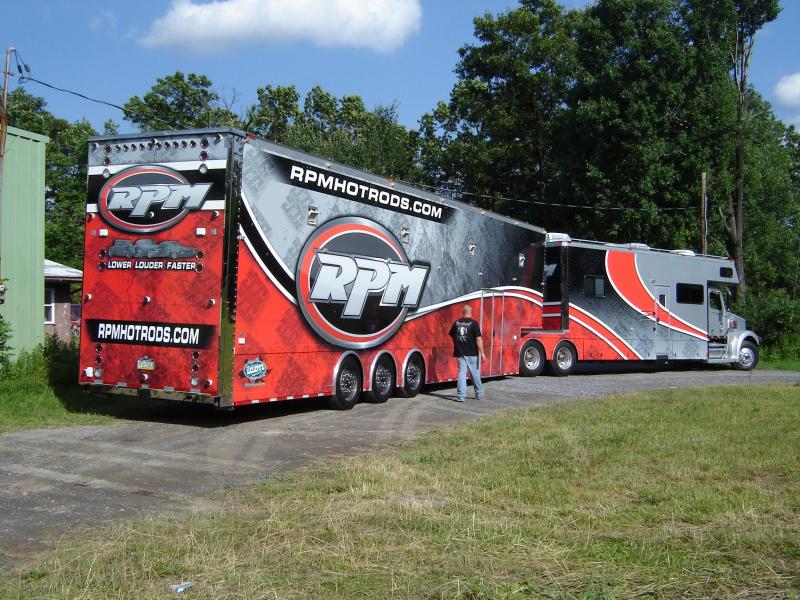

This was all done several years ago on 3551 with 290 lam and I actually saw it yesterday. It still looks great and it has been kept outside. 3551 is great stuff and on a project like this, it results in a pretty significant savings.
