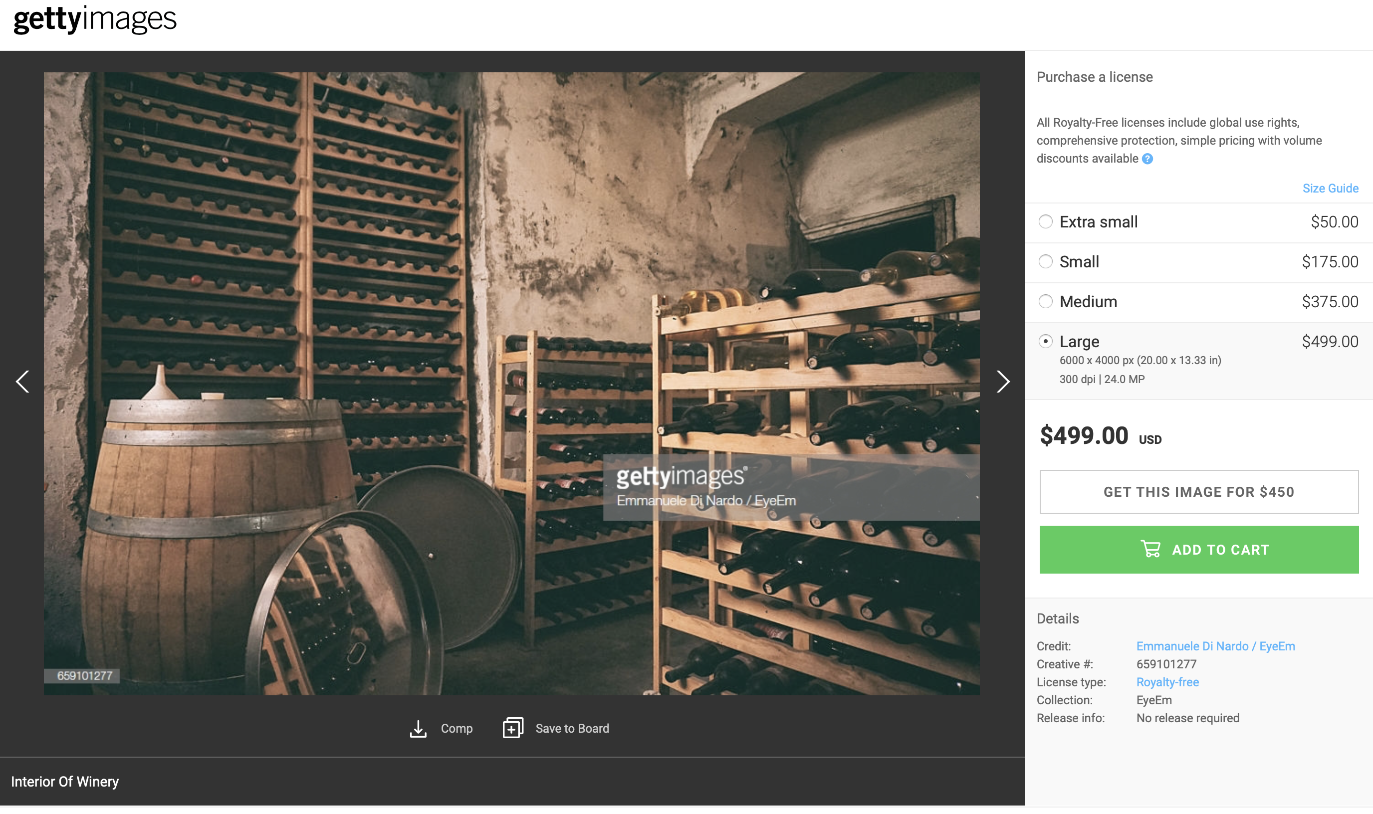

A 5000px x 5000px image will yield around 31 pixels per inch when sized at 4 meters. It will look pixelated at any viewing distance under 15' or so. You could interpolate additional pixels into the image, but the results will be blurry. Depending on the viewing distance and the clients expectations, it could be made to work.
Check Getty Images.

Check Getty Images.
If the viewing distance is less than 15 feet (what kind of wall are we talking about), anything lower than 75 DPI is going to look "not great".
[Edit: That would require an image that was over 10k x 15kish.]
