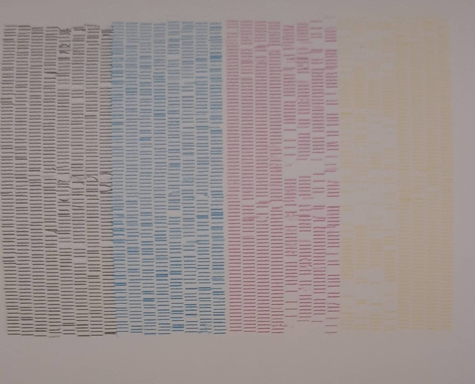

the thing is: i cant seem to get a better nozzle test pattern than this:
the heads were soaked in cleaning solution for several nights, flushed through. etc ... the first row of the yellow nozzles even prints on one nozzle sometimes which means it is not completely dead... the only thing i can think of now, but haven't tried, is to use an ultrasonic cleaner on them...

In my experience if a head can't be recovered with flushes and soaks, it's not coming back. Usually when you see as many deflections you have in your test print, the head either sat for a very long time, which we know, and/or the nozzles are physically damaged. Once there is physical damage, it's not going to recover.
You could try the ultra sonic but in my experience it's never worked for me.
Mantaworld
My experience with these print heads is they are very hard to fix to the point where they are usable for good quality work. I have spent time and money both with Ultrasonic Cleaners ( which you have to be very careful with as you can damage the heads further) and sending them to 3rd parties for "Cleaning".....judging from your test pattern you would be better off replacing all 4 heads (approx $2000). If you plan to use the machine you would have perfect quality printing....if you plan to sell the machine then you will get top dollar with all new print heads and the rest of what you have changed....my 2 cents worth!

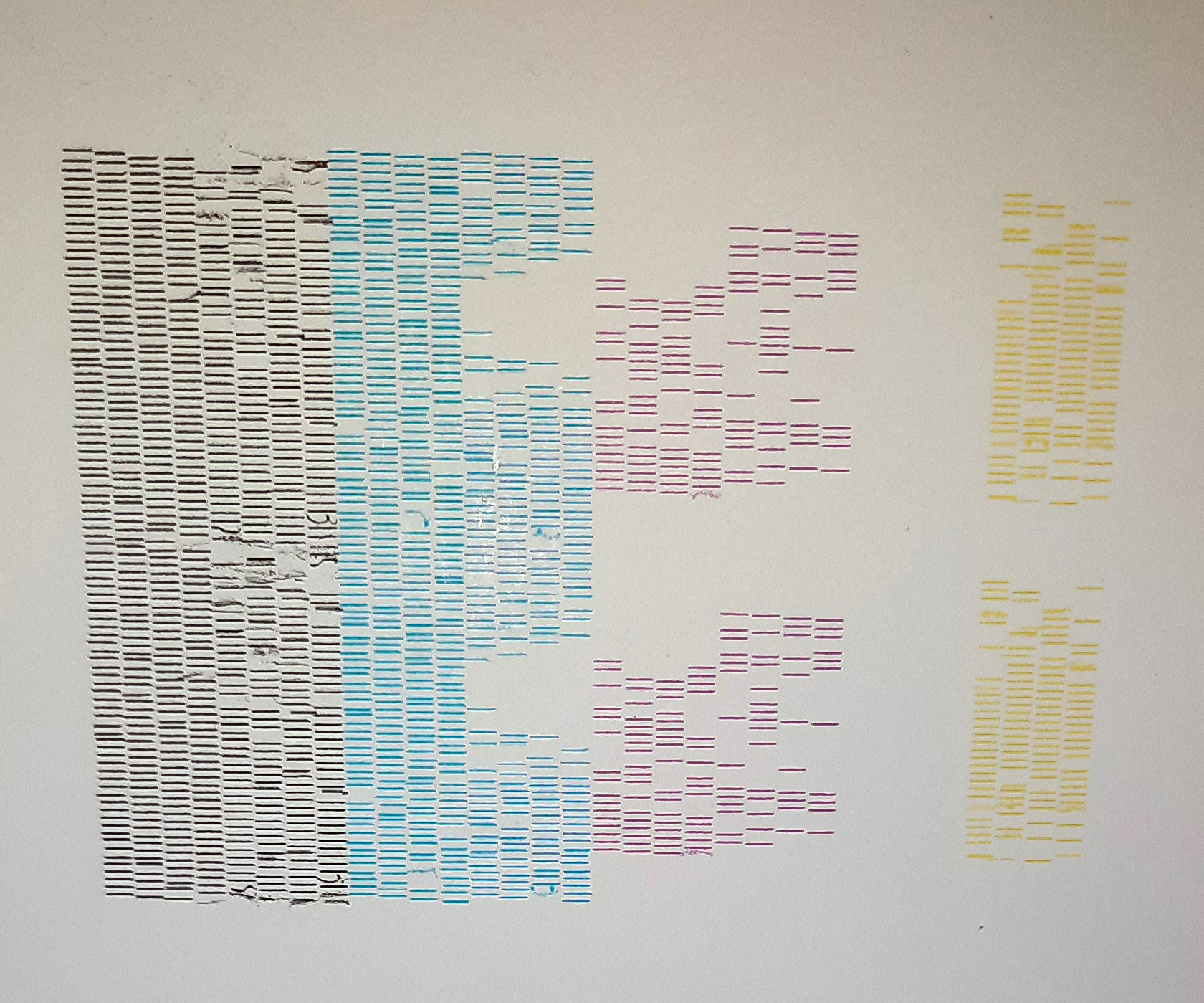

I cheaped out for now and decided to try the ultrasonic-cleaning-method and thats what i got for now:
i put the printhead inside a cheap ultrasonic cleaner with cleaning solution filled up to the plate of the printhead and ran it for 10-15 min. also i pushed cleaning solution through while the ultrasonic ran... the M and Y printheads could use a little more,. but i think i can live with the results for now... when printing larger signs the quality should be ample.... We run a copyshop and this printer is just an addition to our portfolio... if theres more demand i can always buy new heads or, if it really works well, a whole new machine...
