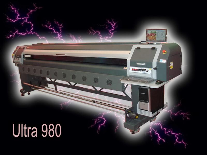

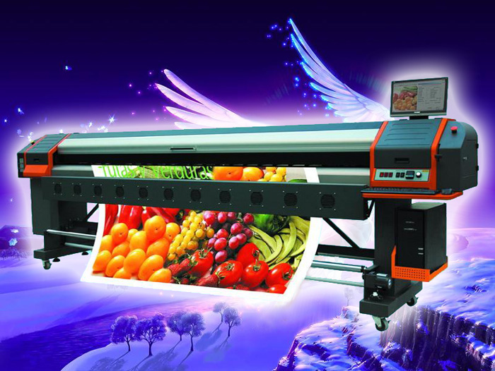

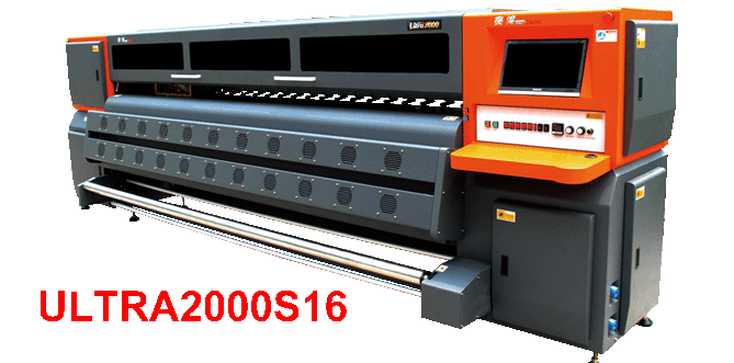

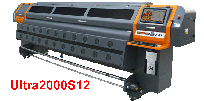

artbot

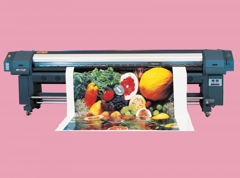

actually i think wit-color is ripping of themselves!
exhibit A!
(the four head tech is something they've been working toward for a while now. earlier ultra9000 brochures discussed carriage/capping upgrades so that current ultra9000 owners would have the ability to retrofit older models to 3 or 4 head printers. i spoke with a guy at witcolor a little over a year ago and he said they weren't ready yet to guarantee stability across all the heads. ...that the amount of data being processed at high resolutions was daunting at that speed. maybe the chips on the main boards are now fast enough to push that many dots per second? i think the real winner with the extra heads, regardless of dry time is pushing hyper resolution at usual printing speeds. i hate scrimping on resolution because of the quantity of square feet needed by the end of the day. this would allow the user to crank up the res' and really impress his client.

artbot
busted!
look at the likeness! they clearly went to their engineers and stole design ideas from previous builds! not to mention all these printer look to be overbuilt industrial machines. they need to take a look at roland and add some pizazz.
jhanson
Well of course they're going to re-use their own case designs. I'm specifically referring to the four-head DX5 setup, which (from what little I can see in the tiny pictures shown) is almost an identical ripoff of the JV5's head carriage. I also remember working on the Micolor SJ-1545, which had a head carriage that you could practically interchange parts with from a Mutoh VJ-1204.
