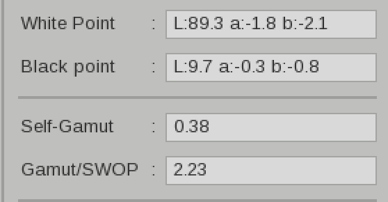

    What I do:
    I print first surface onto glass (any thickness) with a moderate amount of white ink underlaying the swatches. Since even heavy white ink is never 100% opaque, the glass underneath is going to impart color (somewhat greenish) as well as "eat" some of the luminosity. This is exactly what I want because acrylic and more-so glass skew greenish. Any image behind glass/acrylic will be darker, hence why lower luminosity is desirable, whereas glossy paper will be over 90 luminosity. In my case, my white point is L:89,3; a:-1,8; b:-2,1 while my black point is more robust with L:9,7. With this profile I do exhibition work on acrylic with no need for color correction. Also using X-rite spectrophotometer.
