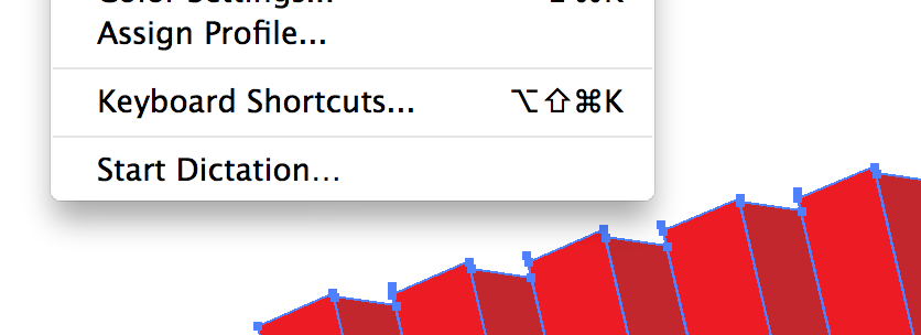

Under Edit menu on a Mac...

We covered this earlier in the thread. You can't set keyboard shortcuts for the Align functions in Illustrator. You can only set a shortcut to open the Align panel.

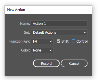

I have no idea when it was added, but it's been there as long as I can remember. Here's what it looks like:
It's restricted to only function keys F2–F12, which makes it pretty annoying if you want to set up alignment shortcuts as others have suggested. Illustrator Actions also do not record your Align To setting, so you cannot use actions and shortcuts to specify whether you're aligning to the artboard, the key object, or the entire selection.
